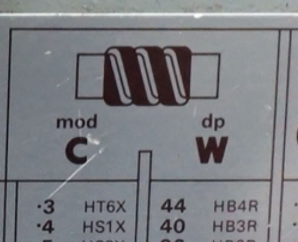

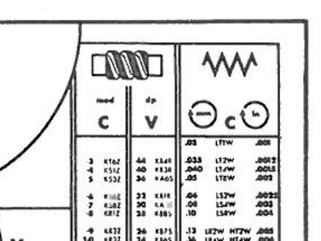

      Posted by JasonB on 28/05/2021 07:08:07:
      Zoom in on the photo I took it from Michael
      No need, Jason … I had already seen the shape
      I just misinterpreted its intended meaning, because the resolution is rather low:
      … similar problem here:
      … but, thanks to D Hanna, I can now interpret the text above V as reading dp
      Ref. __ page 9 of this:
      https://www.making.unsw.edu.au/media/uploads/Colchester%20Metal%20Lathe%20Master%202500_dQeKOzn.pdf
      Note:  I was pleased to find the manual, because my Dad had a brand new Master 2500 in his workshop at Lancaster University, circa 1967.
      Edited By Michael Gilligan on 28/05/2021 10:00:54
