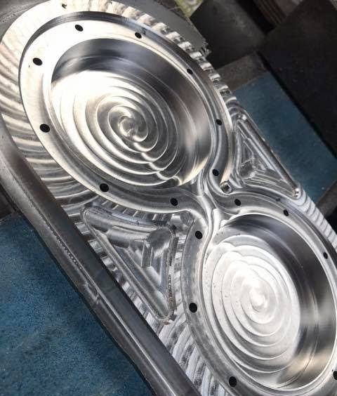

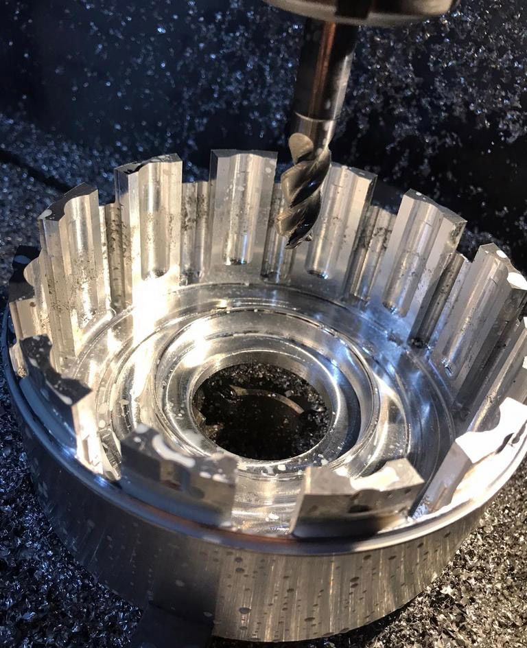

                                          I didn't mention dont buy imports etc, I just suggested don't buy cheap.
                                          This is the finish you can achieve with good cutters .
                                          Dual Filler for a endurance race bike
                                          This is testing the cutter due to long stick out, about 65mm its 12 x 1 tip rad, Clutch Basket again for one of my race bikes, all machined at home in my workshop.
                                          Edited By Involute Curve on 16/04/2020 16:14:08
