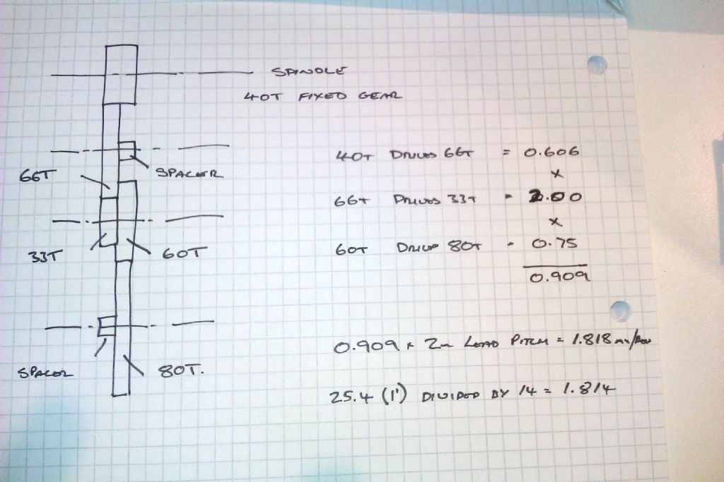

      I'm sure this question will of been asked before but bare with me I am brand new at this. I want to cut a imperial thread in 7/8"x14. My lathe is metric.
      On the front of the Lathe is a chart showing metric and imperial gear wheel set ups. Do I use the metric T numbers and ignore the imperial ones and if so how do I set it up to cut 7/8"x14 TPI.

              OK you need to use the lower of the two charts headed TPI.
              If you remove the cover from the end of the lathe you and look at it from the front you will see the edge of the various gears that run between the spindle and the end of the lead screw, these will be arranged to give a fine feed rate so you need to change them to give 14tpi.
              Looking at the chart under 14tpi there are three rows of gear teeth numbers , the top row is 66, H this means you need a 66T gear and a spacer on the banjo side, the second row shows you need a 33T and 60T on that peg with the 60T towards the banjo and the last line shows you need a spacer and 80T gear next to the banjo.
              So looking at the side of the new gear train it should look like this
              As you change the gears you will have to loosen the various pegs and slide them along so the different gears mesh, put a strip of copy paper between the teeth and this will help set the right gap. You may well also need to pivot teh banjo forwards to do this and onve all the gears are set on the banjo pivot it back and mesh th etop 66T gear with the 40T of the spindle.
              Hope that helps ask if not but it will have to wait until morning. I'll explain the maths then.
              J

                    Right, just to explain the maths down the right hand side
                    The 40T gear on the spindle drives the 66T gear, this 66T gear then drives the 33T which is keyed to the 60T which is driving the 80T on the leadscrew. If you divide the driver by the driven you get three ratios
                    40 divided by 66 = 0.606
                    66 divided by 33 = 2.000
                    60 divided by 80 = 0.750
                    Next multiply these three ratios
                    0.606 x 2.000 x 0.750 = 0.909turns
                    The 0.909 is how much the lead screw will revolve for one turn of the spindle, as the spindle has a pitch of 2mm you get
                    0.909 x 2 = 1.818mm per rev which is the closest you can get to 14tpi with the gears available, to check divide 1" in metric by 14
                    25.4 / 14 = 1.814mm so you can see that you are quite close and unless it was a very long thread the erorr is hardly worth bothering about.

                      Dave Harding 1
                        @daveharding1
                        Thanks for that Jason I set the gears using your sketch. I managed to cut a very reasonable 7/8"x14 Tpi thread thanks very much. The maths example helped as well. That's the first time I have ever cut a thread I am well chuffed.
