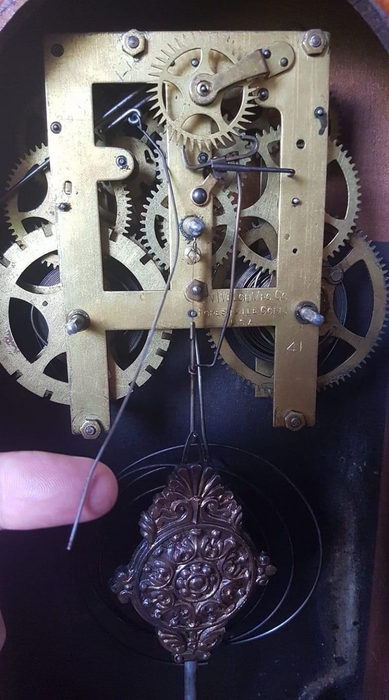

      A friend of a friend is trying to repair this clock, I was emailed this picture asking if I knew what this rod is for, can anyone shed light on this??
      Thanks in advance
      Shaun

          Possibly for Strike/Silent selection
          … or maybe for ‘Strike Repeat’

              Seeing that the clock has countwheel striking, It can't be for repeat. I would suggest that it is either Strike / Silent, or more likely to make the clock strike so that by striking forwards the strike and time can synchronize.
                  Yep!
                  It's for synchronising the striking.
