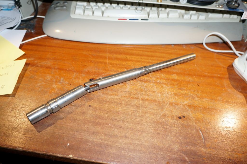

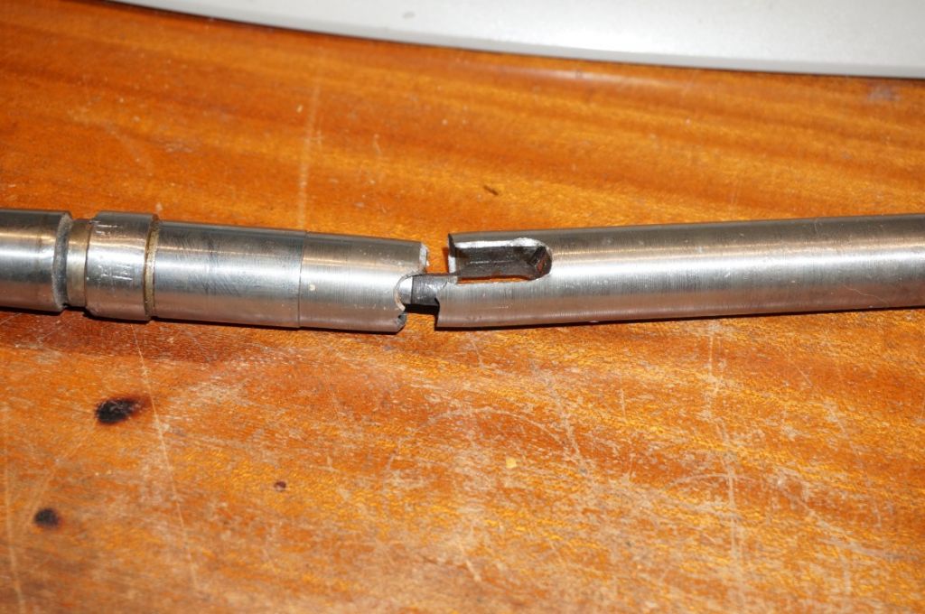

      I bought an old clarke metalworker drill press sans motor but otherwise looks fine over the weekend with the intention of converting it to a tapping stand
      I had a geared motor 400rpm that i was going to put on and use it with a tapmatic head for tapping dutys rather than swapping out on pillar drill
      Trying to get the chuck out however..one last tap with the lump hammer on the drift and
      Anybody care to hazard a quess at how much from machine mart?

              Something I will take note of. I have one that needs a chuck change and it has never been out.
              Looks like something that extracted and clamped round the spindle would be a good idea as I would guess that side forces from the hammer broke it. Might be possible to use some sort of clamp on it and a shortened drift that doesn't go all the way through.

                Clarke international have just replied with a price of £24 all in delivered so not too bad
                I had removed the spindle and it was on the vice drifting from the top so it was purely end force with the tapers pushing….I imagine that the chuck had never been out before and it may be rusted solid
