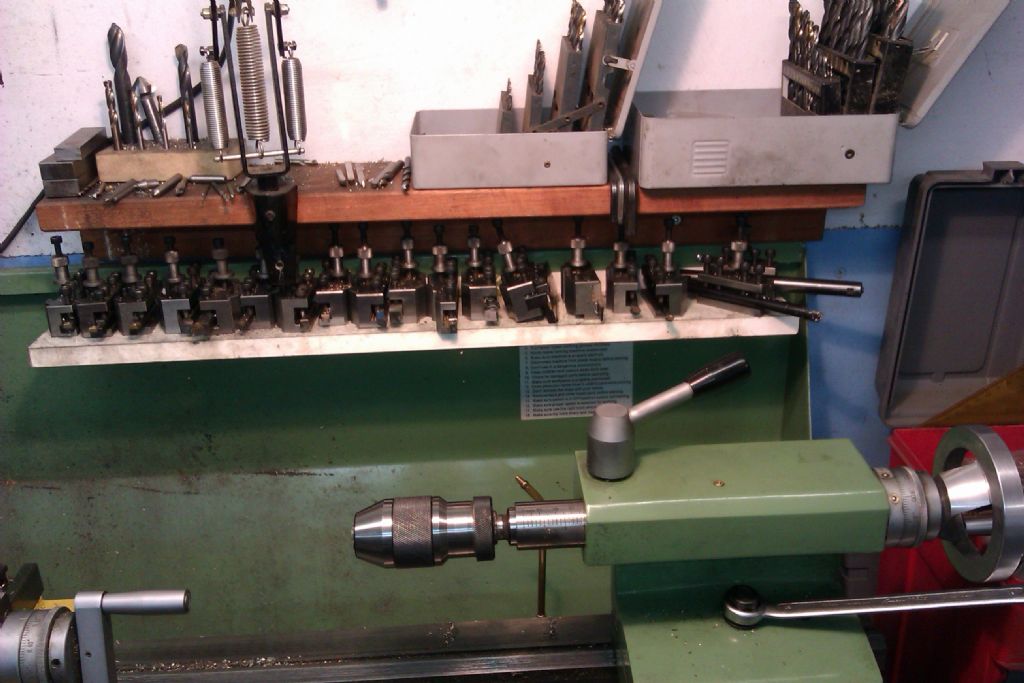

                            As yet I have not purchased any new tools; I have the tipped ones from my Cowells and what remains of the tooling from my ML7. It seems that all the suppliers have only sets available for 12×12 HSS, I may decide in the end to grind my own from blanks using perhaps 10×10 for the set-up.
                            2 questions please,
                            How do you get on with indexables, and
                            are your tooling shelves in the picture fixed to the splash guard?
                            Jerry

                                  Gerry the same range of preground tools can also be bought as singles in all sizes from Chronos if you want to try just one out.
                                  Like you a lot of my tooling was from a similar sized lathe to the Myford so I just use that.
                                  1. I get on fine with indexable tools, Most are CCMT so I don't have to keep a vast range of tip shapes.
                                  2. Yes its fixed to teh splayback, I'll take another picture from the side in a while.
