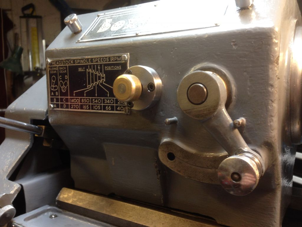

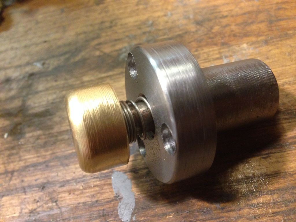

        1963 Boxford
        My Boxford came with quite a few broken backgear teeth, I guess from chuck removal. To keep it from happening again I made a spindle stop. I guess my lathe is now a mark 1,5.

          Yngvar F, that;s interesting, I'v seen that described in relation to the Boxford TUC (?D) training lathe (it has no back gear), Is that thestop mounted to the left of the back gear leaver in your photo?
          Ian S C
          #356348
          Yngvar F
            @yngvarf
            Yes, to the left of the back gear lever. In the middle of moving to a new workshop so have not used it much after It was installed. But it seems very effective.
