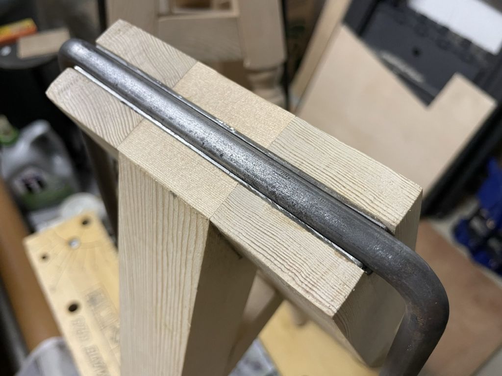

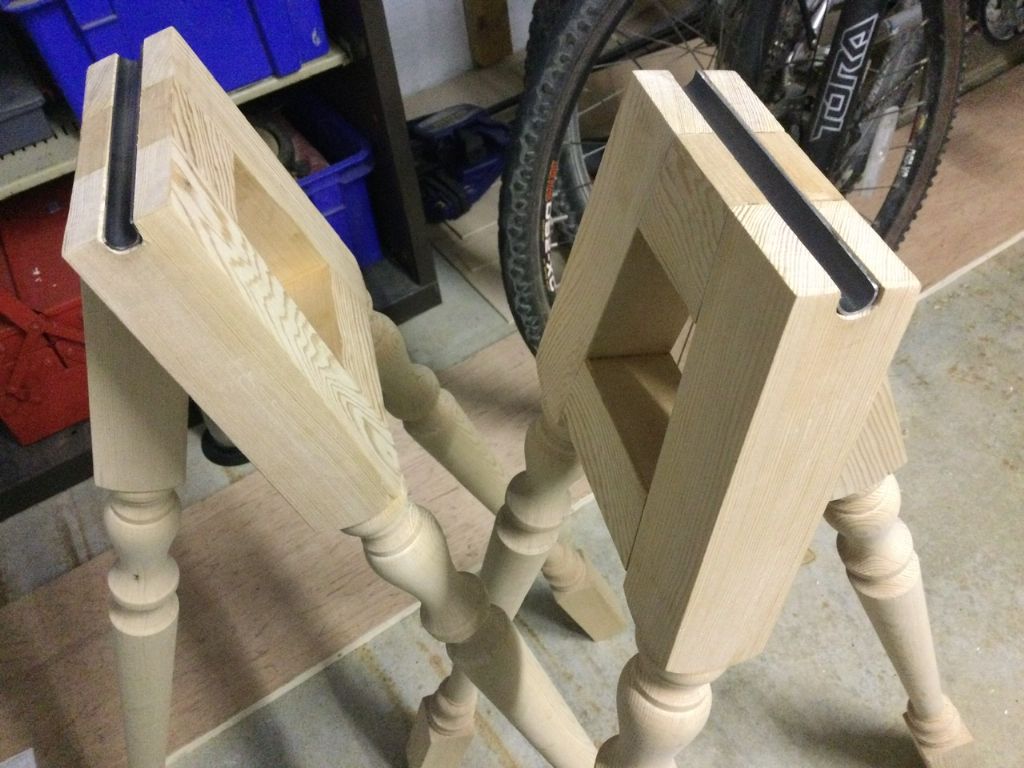

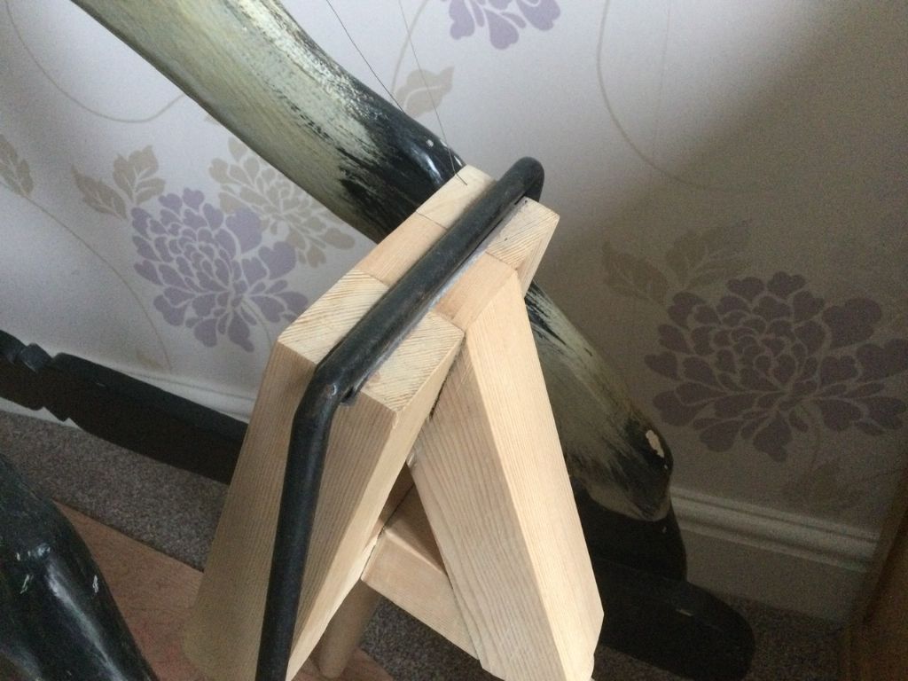

      Hi folks,
      I need your advice. I am making stands for our rocking horse, but the channel I glued in, made from some metal pipe, is a slightly too small ID for the support hoops' OD. (I know, schoolboy error!).
      How can I relieve the channel neatly to allow the hoop to seat properly?
      I have no workshop or milling machine etc, so need another way to do it – filing by hand would probably be too hit or miss?
      I was wondering about something I can put in my 1/4" router and move along, grinding out the channel from above, or maybe a parallel reamer?
      The channel measured 10.00mm ID and the hoop OD measures 10.20mm, (I originally thought they were the same).
      Any thoughts?

          Might be easier to make new hoops for the horse end.

            Probably easier to reduce the round hoop by filing

                Clamp the two parts together and run a Ø10.5 drill down the resulting hole, from both ends unless it is a very long drill.

                    Assuming the channel is impossible to remove I'd file the hoop because it's easier to get at than the inside. Shouldn't take too long with a sharp coarse file. I'd roughly file a series of flats to get rather under wanted diameter, and then smooth the untouched parts a little more carefully to a pop fit.
                    The only good news is it isn't a precision job. The filed hoop doesn't have to be a circle or have an exact diameter. It only needs to fit where it touches and look as good as the woodwork!
                    If the channel can be removed, it could be spread more open by forcing a larger diameter rod into the slot with a big hammer or a vice. The wedging rod would need to be about 12mm diameter. The main difficulty is holding the job during spreading. The wooden frame it's already glued into would probably do, but it might get damaged.
                    You have my approval to use Strong Industrial Language. I often make 'nearly right' errors and the resulting extra bother drives me mad!

                        Broomstick, sandpaper, sellotape, cordless drill.

                          Maybe it's just perspective, but the channel and hoop diameters look substantially wider than circa 10mm to me.
                          As others have suggested, a long piece of dowel wrapped in sandpaper and a drill, or maybe an extended-shank drum sander if you can contrive one, would be my attempt at a solution.

                                    You need to remove 0.2mm off the diameter, or 0,01mm off the wall thickness. Largest round file you can fit in there will do it in no time. Anything with emery paper will take longer.

                                      I have used grinding stones and rotary burrs in a router to remove metal which did an excellent job UNTIL the bearings gave out. (warning: wear safety gear, routers spin at 20,000 + rpm and stones can shatter)
                                      So I would recommend that you do as advised and use a file, emery paper and elbow grease. Removing 0.2mm from either the channel or pipe should not be too hard.

                                                  The first great idea was clamping the two stands together to form an approximate tube to machine out. I had not thought of that.
                                                  I do not want to file the hoop pieces as that might weaken them or leave stress risers on the metal – it's quite a heavy horse. Also, I won't be able to hand file them perfectly round.
                                                  I would rather not remove the channels as that will probably mark or damage the wood. They are epoxied in and I should of course, have double checked the fit before glueing the channels in. A classic case of "measure twice, cut (or glue) once" !! (but see below)*
                                                  I am going to try clamping the two stands together and then running a 10mm drill through, then emery paper taped and wrapped around a smaller diameter drill, or a piece of dowel to open out the channels. At least that will result in reasonably concentric channels, my hand filing won't be quite as good. Hopefully there is only a small amount to remove before the hoops will drop in.

                                                    Well, clamping both stands together did not work because the two channels did not meet perfectly round but slightly oval, so I had to resort to filing each one by hand.
                                                    I filed the channels and also the hoops too, because the bar the hoops are made from did not have a very round cross section, so they jammed on part of their swing. I used a half-round file and a round file wrapped in sandpaper for the channels. For the bars I used a flat file with that opposite action one uses for filing a smooth curve where you move the file opposite to the curve you are filing instead of following round the circumference – can't think how to describe it but I expect you know what I mean.
                                                    It wasn't a huge job in the end, luckily, and it all fits very nicely and freely now. I will add a hint of grease on final assembly, and possibly a cover over the top of each hoop. Got to finish the wooden stand next.
