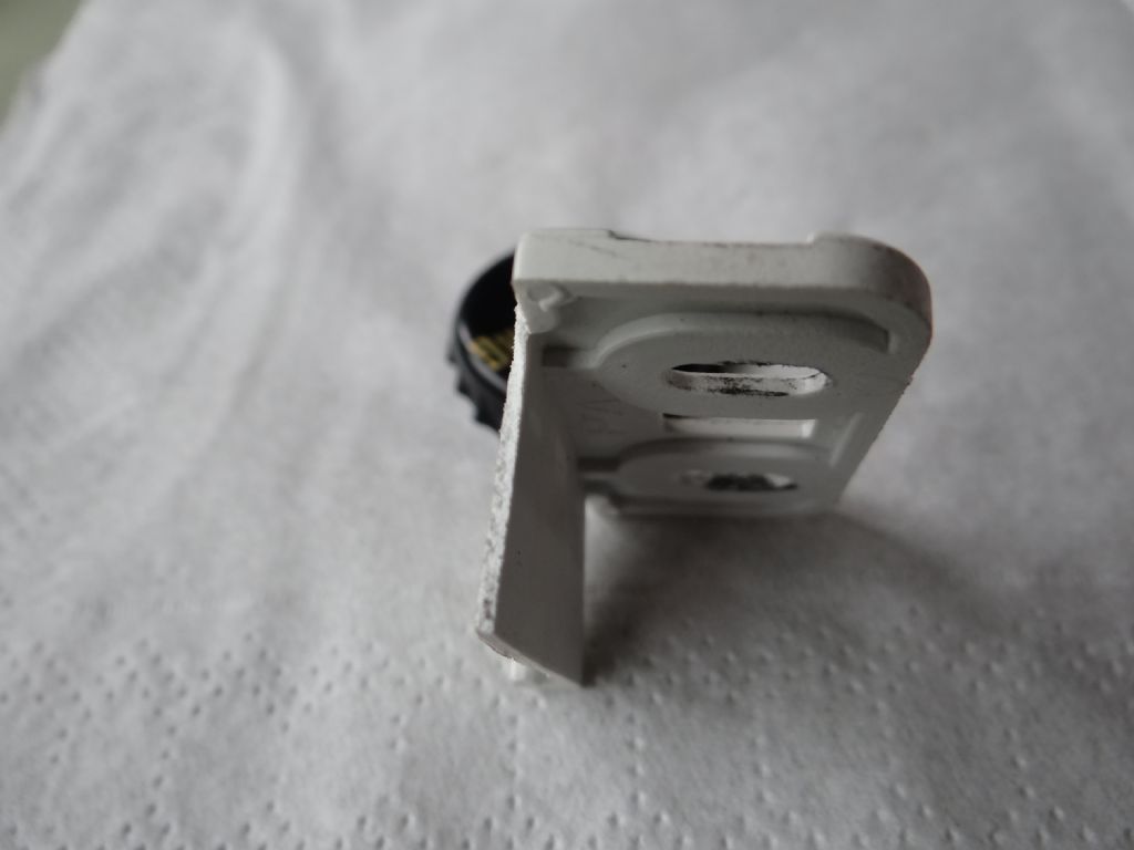

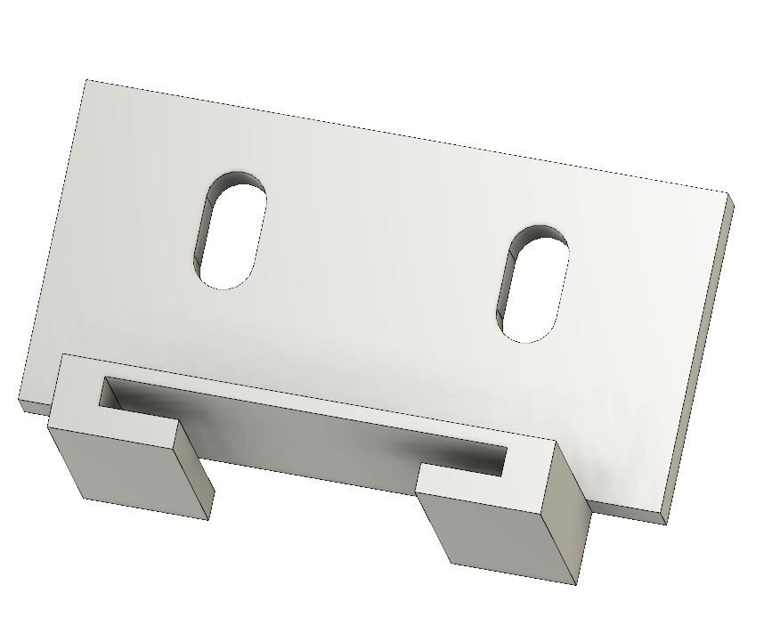

      I'm trying to make a replacement slider in aluminium for a fridge door. (The original is plastic and breaks easily.)
      It looks like this:
      Straightforward enough in a milling machine apart from the 'T' slot at the bottom. The top of the T is 27mm across and the bottom 16.25mm across. The two vertical cuts are both 2mm, and the bars of the T are 5.4mm deep.
      I'm not sure how to cut the 2 x 5.4mm side slots. Any suggestions on how to make this please?

          How about a custom made cutter similar to a woodruff cutter?

            Can I suggest an alternative? Make the lower part in two layers – either:
            1. A flat top sheet and below it a pair of L shaped pieces. Drill 4 countersunk holes downwards and tap the lower (thicker) pieces for metric screws – size as big as the design will stand.
            2. The top sheet with a flange both ends, and a pair of plain lower slabs, drilled upwards and countersunk, with threads in the thick top piece.
            Either way – it depends on what is in your scrap box, and how strong (etc) the result needs to be, and how visible the screws will be etc..

              Grind the end off a Tee slot or woodruff cutter until it is 2mm thick, would really only need to be one tooth that was the full thickness so you could grind at a slight angle so the rest has clearance.
              Or grind an old large endmill or slot drill to just leave 2mm at the end

                If the 2mm slots don't need to be very precise you could try sawing them with a hacksaw.
                You could also plane it out in the lathe the same way you would cut a keyway. You could probably make the tool from a circular saw blade or a broken machine hacksaw blade.

                  Jason's way would work, but if you've no cutter you can modify – or are prepared to sacrifice – you could try drilling (say) 1,8mm holes parallel to the 16,25mm slot to shift most of the material and then finish with hacksaw and flat Swiss file. I'd suspect it's the 16,25 slot that controls the slide and the 2×5,4 extensions are clearance, but you'll know better from examining whatever fits it.

                    Another thought is to mill out the middle bit then get some 2mm gauge plate, grind the end to a slight angle and then use a planing action to cut the two 2mm slots

                      I like Tim's suggestion but it looks as tho the ends would have to be thicker to get some sensible size bolts through.
                      Failing that how about 4 pieces of stainless silver soldered together

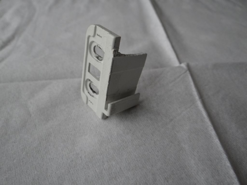

                            I take it this is the slider between the real fridge door and the outer decorative cladding.
                            Where does the thing break?
                            You seem to have a CAD model of it.
                            Wouldn´t it be possible to beef it up where necessary, add fillets or make bits thicker and less prone ot breaking and 3D print it? Make it too strong and the next thing to go will be the plastic rail it slides on. I´m sure there are some experts in 3D printing out there,

                                        What part of it breaks?

                                            A suitable tool would be easy enough to make from silver steel, say 15mm in diameter. Turn a shank, possibly 10mm with a 4mm 'neck', then part off to leave a 2mm thick disk.
                                            File to give 'Rufus Roughcut' teeth and harden. Run ad modest speed and gentle feed with plenty of lubrication.

                                                      dsc05347.jpgThe fridge/freezer belongs to my sister and is fitted in a cupboard. The fridge is on top and its door is joined top and bottom to the cupboard via slider rails. It is the lower component that breaks – they last about a year. The cupboard door has a hand grip running along the lower edge that people naturally use but it puts most of strain on one flimsy part, which eventually breaks. The close-up shows how thin the part is where it connects to the slider! (Bottle-top for scale)
                                                      Clive F's comments about 'barely enough material to do the job' and clearance are very relevant. It may be possible to beef the part up, though Clive H is right to worry about breaking the slide rail which is also flimsy, and he's likely right about the vacuum as well. More investigation needed.
