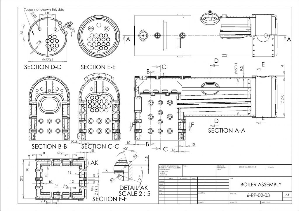

I can see the point in something like that particular exercise but not Neil's 3D head. A GA and detail drawings would give far more detail. It could be an alternative to a GA if I could drag the viewing angle around with a mouse etc but it doesn't give any indication of actual sizes / enough information to actually make one.
The GA and detail drawings are produced from the 3D model with very little effort (the projections are automatic – as often are section views). The model inherently includes sizes (everything is typically modelled at full size) and the CAD system has measurement tools to allow easy checking of any resulting dimension. These sizes drive any dimensions that you choose to include in the 2D projections.
You can drag the viewing angle round, zoom in/out, hide parts or make them semi-transparent to 'get at' things.

Once the models are done, the drawings are just a few mouse clicks away, if any changes to the models are needed the drawings will update automatically as well.
Oh and YES, I do all my model engineering drawings with it as well, even if there is a published design I want to use, I model it in 3D to make sure it will all work out correctly, I only have myself to blame then.

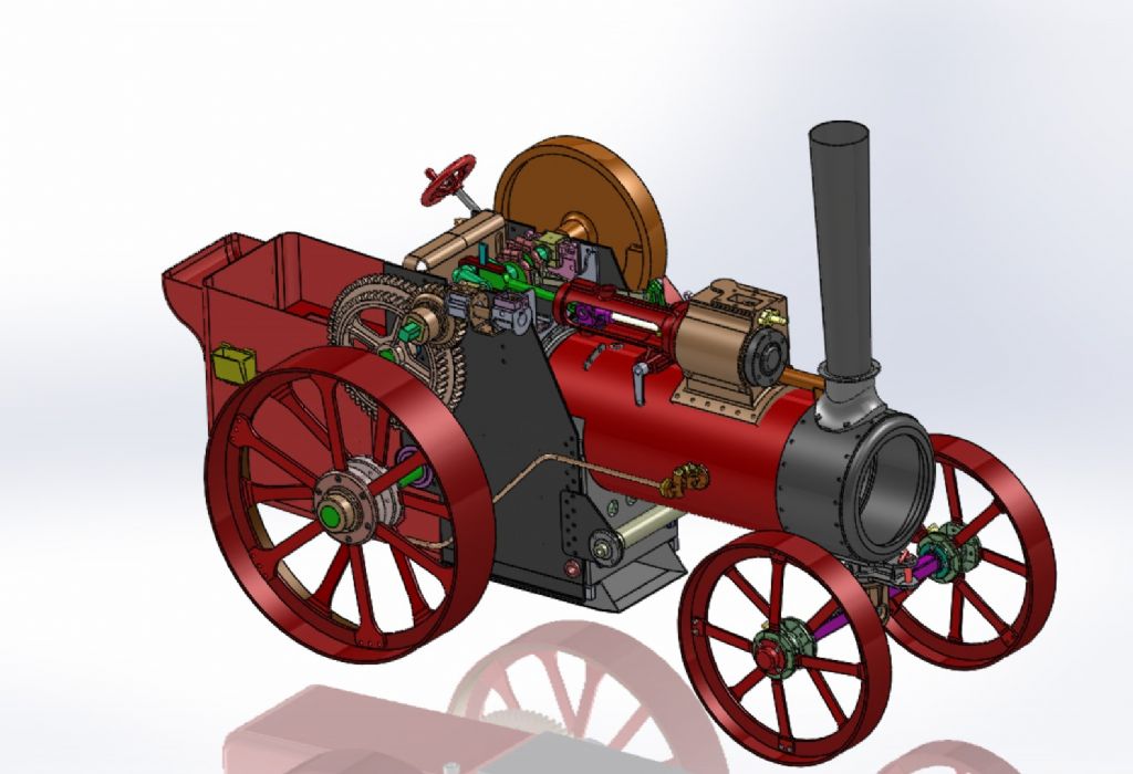

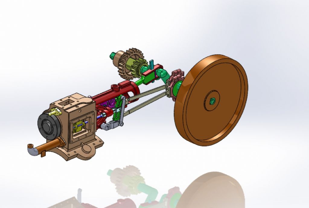

I am building a model steam traction engine from a set of drawings which I purchased. But these drawings are not 100% correct and lack a lot of detail. Also the size of available material is not available and the drawings have to be modified. Therefore I have modeled the engine in 3D before I start machining. There are hundreds of parts which need changing. Much easier and cheaper to fix a problem in the computer model than in the workshop.
The 3D model allows me to check how everything goes together. The model can also be animated to show problems. I can rotate the flywheel and see the motion of the piston and connecting rods and check the position of the slide valve to see where it opens and closes thru the cycle. The drawings are linked to the model and if the model is modified, the drawings are automatically updated and therefore never out of date. 3D models also contain heaps of other information such as its volume, mass, centre of gravity and can be used for determining the stresses within the parts. 2D drawings can be used for profile cutting parts and 3D for creating casting molds and sent to 3D printers.
