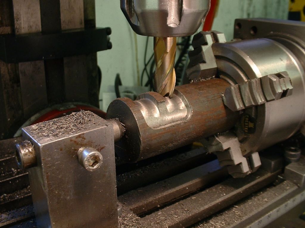

              #79338
                Four also makes it easier to do this
                J

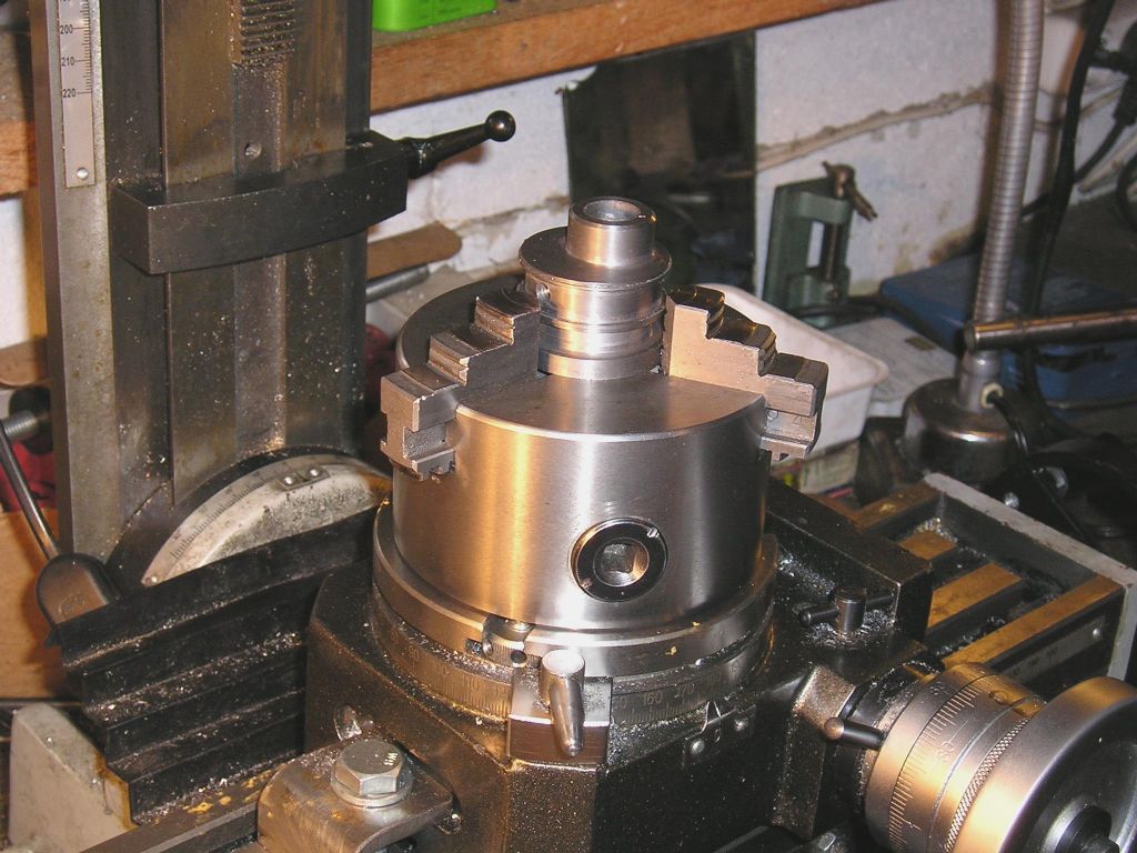

                                        #79486
                                        Sub Mandrel
                                          @submandrel
                                          This is my ‘interesting’ home made setup…
                                          The tailstock was literally a 10-minute job. What you may not see is that the chuck is on a 80mm diameter flange, behind which is a groove about 20mm swide and deep enough to fit 6mm nuts on chucks/faceplate then another flange which bears against the face of the base. The spindle runs through the plain body (CI in CI) to a brass 60-tooth wheel.
                                          The fit of the spindle in the base is probably the best I have ever managed, much aided by the beautiful quality of CES meehanite. Cost was marghinally less than their rotary table castings but I think the end result is more flexible given my kit.
                                          I missed a trick as I bored it to big of MT2 as it was before I had an MT2 reamer. If I ever get an MT3 reamer, I might put such a taper in the centre.
