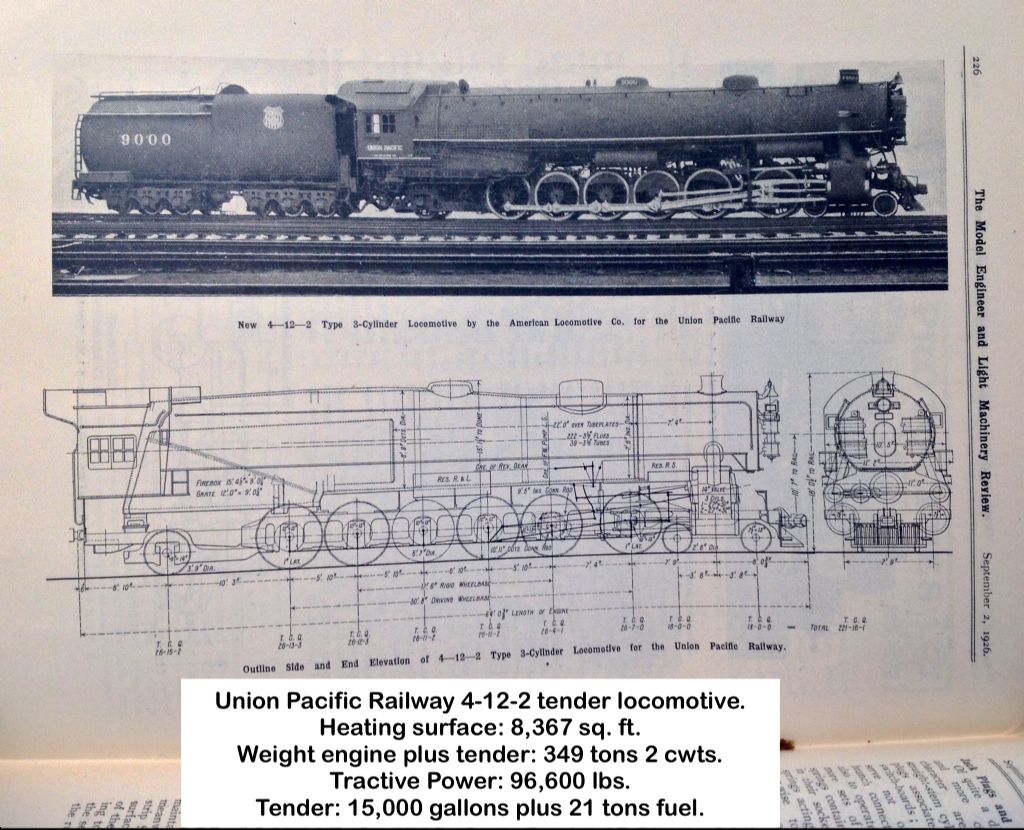

              The first was feeling a little lonely, so added this for company, it having a 4-wheel leading and 2-wheel trailing bogie plus a 6-wheel tender.
              Replace the trailing bogie with a 4-wheel one and that would be it for a coupled loco me thinks.

                The Union Pacific 12 coupled loco. used conjugated valve gear with what looked like the Gresley/Holcroft design. The locos were numbered in the 9000 series.
                I think that Russia made a 14 coupled loco, but could only be useful on straight track.
                Lots of tractive effort, but locos with so many coupled wheels must have been barred from any track with a distinct curvature!
                The British rail 10 coupled 9F s had flangeless centre driving wheels, and probably a lot of side float on the other axles. Not only could they pull, but could run at express passenger speeds when required! Possibly the last and best steam locos made in Britain.

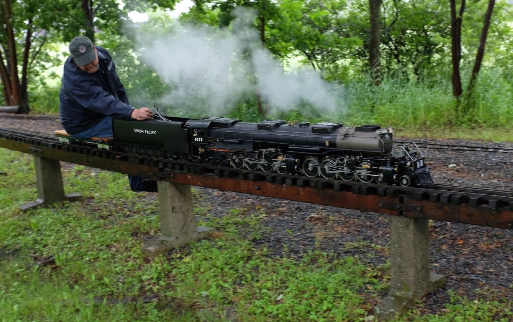

                    If you are going to "do it", then, do it right!
                    I've seen one of these locomotives in person (Steamtown in VT) and, impressive is the word. I think that Mallard would fit in the firebox…
                    Photo of our hero Keith with a locomotive he did some work on running on the Montreal track:
