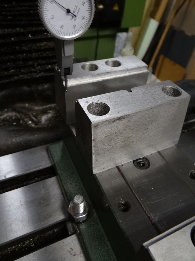

          PS Re RevStew's 'how long does it take' question. Technology sometimes bites back. I mounted a vice on my milling table this afternoon. Easy enough except the vice is set an exact right angle to the head by tapping it into alignment with a mallet and checking the result with a DTI. Normally takes me 5-10 minutes to zero in. Today, 40 minutes of industrial language and it's still not spot on…
                    Good grief, that's what I call staying power, if it takes me more than a couple of minutes I get niggled and if it reaches 5 minutes I lose interest and go and do something else. What sort of accuracy are you aiming for? I'm happy with one division (0.01mm) on the DTI over 150mm for most normal work.

                        Posted by Andrew Johnston on 21/08/2018 19:34:09:
                        Posted by SillyOldDuffer on 21/08/2018 18:26:30
                        Nothing special, less demanding than you – 0.01mm over 90mm. Set-up conventional with the vice initially aligned roughly with a set-square:

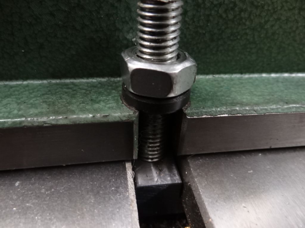

                        I'm wondering if the problem is to do with the size of the studs and washers?
                        The studs are close fit to the slot in the vice, and the 'washer' is more like a thick spacer. Possibly the stud tilts when the vice is tapped & wedges. The adjustment problem was the DTI would move as expected up to a point and then misbehave, forcing me to start again.
                        All suggestions welcome!

                          Posted by SillyOldDuffer on 21/08/2018 20:07:40:
                          Not exactly sure what's going-on there, Dave … but there's a nasty burr on the edge of that slot.
                          I would spot-face the casting, and make some larger diameter [thick and flat] washers … with a  D shape if necessary.
                          Edited By Michael Gilligan on 21/08/2018 20:29:16

                            duncan webster 1
                              @duncanwebster1
                              nip one side down to give a bit of friction and leave the other slack. Then it will rotate around the first. I normally get mine within a couple of minutes, but there agin 0.01 mm is 4 tenths, do you really need it that good?

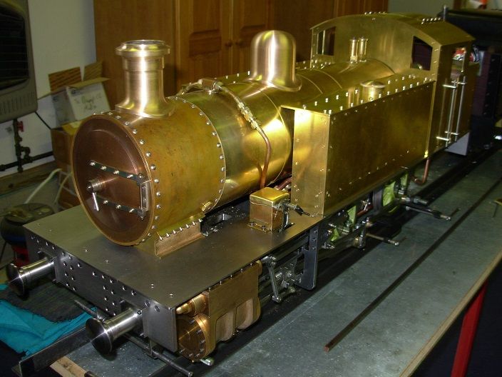

                                More than anything else, building a live steam locomotive is an exercise in time management. During the first three years of construction, I averaged 2 hours in my shop, every day, working on the locomotive. Some days more hours, and some days none. But, on average, it has been 2 hours every day. I started waking up 1 hour earlier than normal so I could get in an hour of locomotive work, before heading off to my real job.
                                I started making the frames in June of 2015. The chassis first ran on compressed air in February of 2016. So, about 9 months to get it running on air, or about 540 hours.
                                The first steam test to the chassis was in April of 2016. The steam was supplied by a small boiler that I use to run my stationary steam engines. In order to get the chassis ready for live steam, there were a few things that had to be done in addition to what needed to be done for operating on air. Some of the additional things were the installation of the lubricator pump and the cylinder drain valves.
                                It was in May of 2017 that the locomotive was officially steam certified and operating with it's own boiler at the Finger Lakes Live Steamers track in Western New York. About 23 months, or, about 1400 hours from start, to operating on it's own boiler.
                                I have been running the locomotive since May of 2017 even though it was, and is, far from finished. After I got it running on it's own boiler, most of the work has been getting the water tanks, plate work and many little details finished.
                                The locomotive is nearly complete mechanically. I hope to paint the locomotive during the winter of 2018-2019. Currently, I have about 2000 hours into the build. This is actually the sort of number of hours that has been quoted to me by several people. If this were a particularly detailed locomotive, I think that number could go much higher. Also, if you have no experience with machine tools, the number will be much higher.
                                I plan to not work so much on the locomotive this year (2018) and do more of running it on my club track, working out any remaining bugs, and visiting a few other tracks. More fun, less work!
                                Building a steam locomotive was not my objective, just a necessary evil if I was to ever own and operate one. I also wanted to be able to answer honestly, "yes" to anyone that asked me, "did you build this loco" and "did you build the boiler?"
                                Here's a link to my website that has a few tips on getting your loco in steam as quickly as possible. (Assuming you are like me and would rather be operating your loco rather than building it!)
