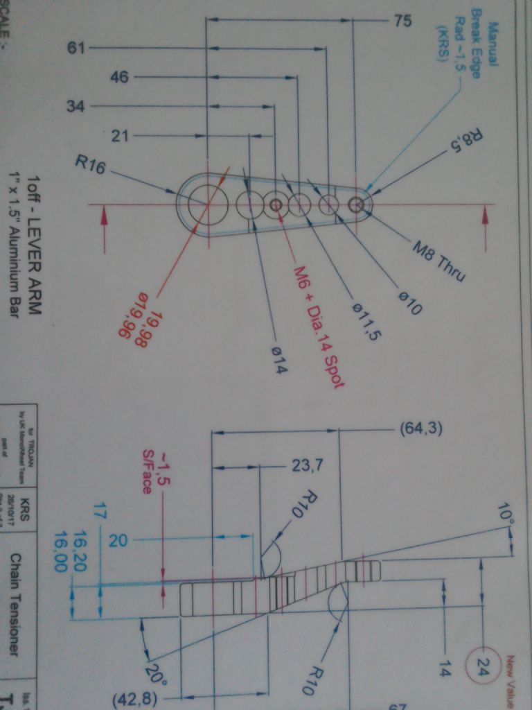

            Made this item between 9am and 4pm on a Saturday including a lunch break. The first thing I did was to square up a scrap of aluminium alloy and drill clearance holes 75mm apart and 34mm along for the M6 thread when it was made to hold the part for all the machining operations except boring for a bearing in the final op. Initially the bearing hole was made M6 to clamp the workpiece to the support block. This was done holding with the M6 and M8 threads. I used bits of metric gauge plate for am 8mm spacer when the part was turned over.
            Martin C
            Ps The finished part can be seen in the UK Monowheel Team's Facebook photos

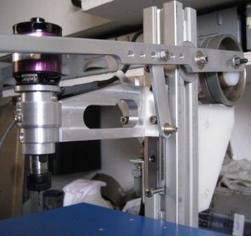

                                      Well, it does seem that things take time…Sometime, a LOT of time –for some…
                                      What I did in the last 320 days – seven eighths of a year, to be 'exact' –
                                      Made a High Speed (30,000RPM ) sensitive drill press :

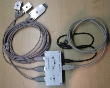

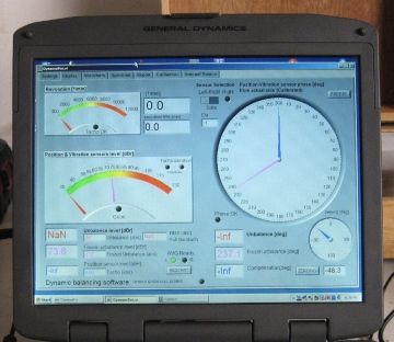

                                      Made a Dynamic balancer using accelerometers to balance the motor Rotor, using the excellent Miklos Software:

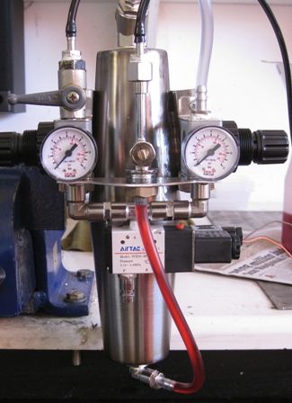

                                      Made a Large Droplet Spray coolant Applicator:

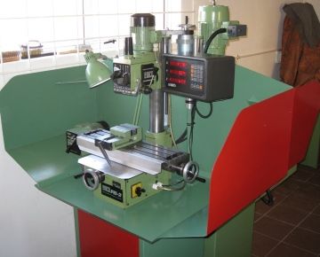

                                      Then refurbished totally my two EMCO FB2 Mills, and made swarf/Splash Guards for them – seen back-to-back here:

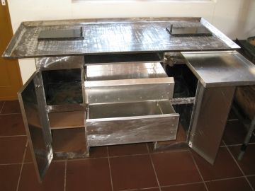

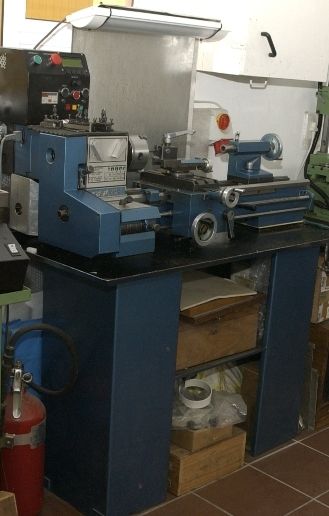

                                      And then refurbished totaly my EMCO V10P lathe, Modified the cabinet to have cupboards and draws, and developed an Electronic Leadscrew to enable fully automatic thread cutting of any thread pitch.
                                      The Lathe Pre- refurb:
                                      Cabinet in process:

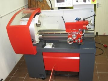

                                      The V10P after refurb, with Electronic Leadscrew system fitted, and DRO on X and Z axes.

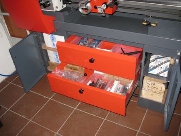

                                      The cabinet cupboard and draw mods were so useful, that I did the same to the EMCOMAT 14D cabinet:

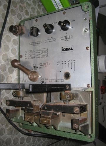

                                      Then I resurrected an IDEAL Bandsaw Blade butt welder – works very nicely indeed!

                                        Joe,
                                        I d love to know more about that Large Droplet Spray coolant Applicator you made.
                                        I have an application for something similar at the moment.

                                          Hello Liam,
                                          I did a number of post with more detail – maybe take a look at those and then if you have more questions, shout.
                                          In essence – compressed air is fed to two pressure regulators – one output goes at higher pressure to the air pipe that delivers air to the cutting tool edge/workpiece. The other regulator pressurises a tank that has the coolant within. That coolant exits the tank bottom and passes via a flow regulator valve ( a conical needle and seat valve, from an old handheld gas torch), into a 4mm OD/ 2.5mm ID felxible tube, coaxially located in the the above air tube. The latter ends in a bras nozzle at the tip of the air tub outlet – a fancy nozzle that allows air to flow past the nozzle tip. There the air picks up the slow flow of coolant and deposits it on the workpiece. The fluid nozzle tip position in relation to the air outlet tip is the key..Then there is a solenoid that cuts of the air supply when the thing is turned of, and vents the pressurised tank to atmosphere, stopping both air and coolant flow right away.
                                          I am not sure how to point you to the various posts – here are some links that may help, else if you use the search feature halfway down the HOME PAGE and search for fogless , coolant, joseph noci 1, or such like, and then dig through the gunk that appears, you will also find the posts..
