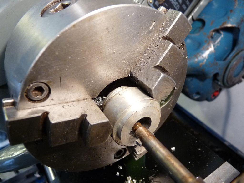

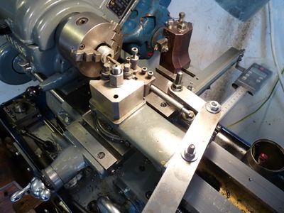

                        CotswoldsPhil
                          @cotswoldsphil
                          I made a lever arrangement to rack the top-slide, to save wear on the saddle gearing. The second photo shows it in use cutting a test keyway in what would be a pulley. There are many versions of this accessory, mine was made up from the scrap box.
                          For a square hole, I think I would mount a cutting tool with a square corner pointing to the lathe centre height and index the work. Taking light cuts should get the job done. If you mounted the work in a 4 jaw you could use the jaws to index the work.
                          Is a complete square necessary? or could just enough metal be removed to locate a square shaft by its corners in a larger hole.
                          CotswoldsPhil

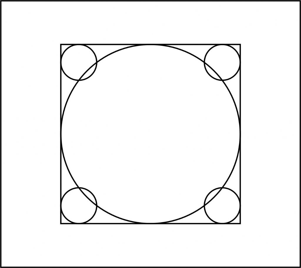

                          #167385
                            Stan Bray used to champion a very simple way to get started. Mark out the square with its diagonals. Drill holes about 1/5 of the full size of the square accurately in each corner. Now drill a central hole of diameter that of the full square. This will just cut into the smaller holes, so take it easy. You can make the drills slightly undersize for a less stressful life.
                            This will remove most of the metal and make finish filing or broaching much easier than just a central hole.
                            The diagram shows the small holes as 1/5 of the larger one, I'd probably use a bit smaller.

                                #167402
                                  Posted by fizzy on 22/10/2014 19:36:35:
                                  … This is where we are going down hill rapidly, a wealth of information held by a relatively few people which isn't being passed down, or there is no way to easily pass it down. …
                                  Very philosophical, Fizzy … and all too true !!
                                  This forum should be a good way to easily pass some of it down [if only we could get some better "system" into the idexing of posts].
                                  Here is my slight embellishment to Stan Bray's wisdom [and Neil's illustration]:
                                  Assuming that it doesn't matter for other reasons … it's worth moving those small holes outward a little, so that they provide relief at the corners of the square. It makes the filing job much easier.

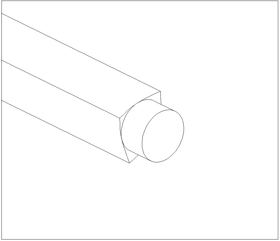

                                        Gary Wooding
                                          @garywooding25363
                                          First drill a 5/32 round hole. Then, from a piece of 5/32 square silver steel turn up something like this on your lathe. Harden and temper it, and push it through the drilled hole.
                                          Edited By Gary Wooding on 23/10/2014 08:16:44

                                            #167452
                                              Phil,
                                              Gary's excellent sketch shows a suitable tool very nicely.
                                              I would, if I may, just add a couple of points of clarification.
                                              1. You will see that it is turned with a slight "countersink" … this is especially worthwhile when cutting steel, because it gives some positive rake to the cutting edges.
                                              2. You may have a problem with the chips building-up and jamming … because there is negligible clerance between pilot and hole.
                                              Definitely worth a try, although I suspect that a slight variation may be required because of (2)
                                              Edit: note that the Staking Tool avoids the need for a  pilot.
                                              Edited By Michael Gilligan on 23/10/2014 09:40:21
