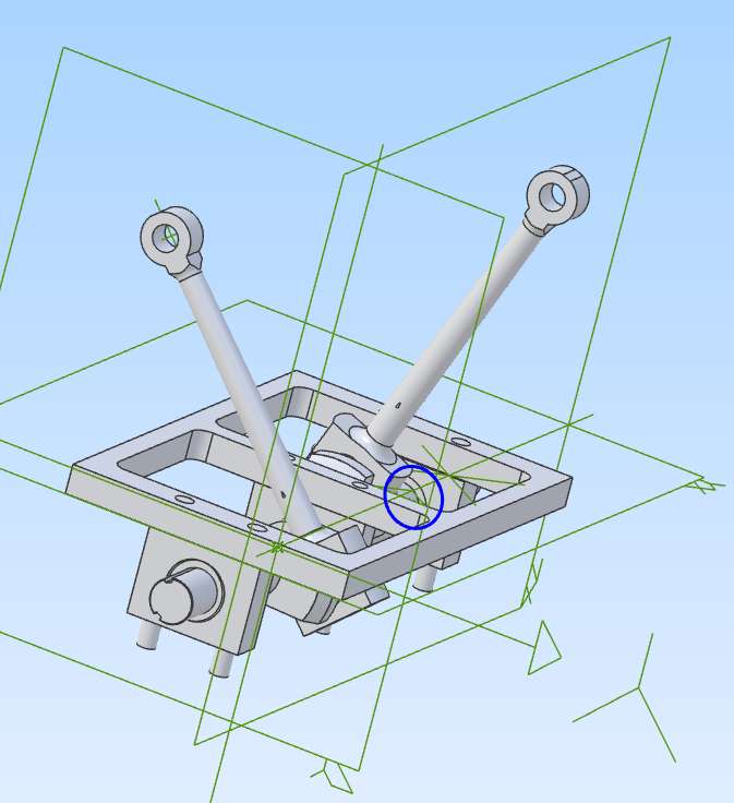

      I realiesd I needed make four major changes to my steam-wagon engine:
      1) Compound to twin simple-expansion, so I have to make a new cylinder block.
      2) Change the connecting-rod centres from 4.5 to 7 then to 6″ centres. (I.e. make a third pair.)
      3) Place the crankshaft and main bearings below the engine base-plate, rather as in a car engine.
      4) Make a new base-plate as the existing one is too short.
      So four new Alibre Atom models: the new base-plate, connecting-rod (badly) and journals (2 sizes plus bushes for 2 of them).  I very much doubt I used the most efficient methods but those are for the experts.
      Then tried to assemble them. Far too hard.
      I needed create the studs to align the journals.
      The crankshaft is not truly concentric with the journals.
      The connecting-rods arrived upside-down. I took ages to make them point upwards through the base-plate “windows” although at strange angles: “Axis” tool then “Component Displacement” by angle that only worked by including a small linear displacement.
      I don’t know how to assemble the big-ends centrally along the pins but that does not matter much. The clearance is tiny.
      So far so… good? No – I’d hit the end.
      Assembling the cross-heads from their three parts, failed. The parts arrived facing in random directions and every move was just “over-constrained”. I deleted them.
      The Design Explorer by now listed six axes and two dozen constraints, excluding all the faulty ones I had deleted. I expect the real Alibre users would knock that assembly off in half that, accurately, in ten minutes. That is NOT a challenge! Anyway, it would only prove my point if anyone did.
      A complete mess. At least it’s not wasting metal, electricity and time making parts I need replace later, just making useless pictures.
      Hopeless….

        A few random comments
        Conrods arriving upside down. Use a constraint to make the hole in the big end concentric to the crank pin. You can then simply hold the mouse down on any part of the conrod and move it, the big end will stay where it is so the rod just swings round. Until the cross head is in place you won’t have anything to constrain the little end to.
        Conrods sideways. Two options one is to select the side of the big end and the side of a web and use an offset constraint entering a distance of half your gap. Right clicking the rod and selecting “show reference geometry” will then allow you to position the ctr line of the rod, probably half the cylinder ctr distance from the mid plane.
        Crankshaft concentric to journals. Should just click teh journal surface and teh mating round part of teh rod and us ethe concentric constraint
        Cross heads. To simplify things do an assembly of just the three cross head parts. constrain mating faces, concentric holes, colinear faces etc. Save as an assembly and then import into the main assemby.
        No need to have added any extra axis. If you have deleted aulty constraints then they would not show in the tree down the left so you can’t have deleted them. Yes the list gets long but by using sub assemblie sand naming some of teh constraints you can keep their number down and keep track of them.
        Studs (and other fixings) No need to add these at the moment and nor that important later. If you have the tapping and clearance holes then you just set them to be concentric. Again keeps the list on the left short and if you have a slow computer means it does not have to work so hard.
        One other thing I see is that your assembly is not positioned  to any particular axis. I would have started with the base plate and centered that on the ZX plane and anchored the part. That way you have a ctr line running down the middle of teh engine.

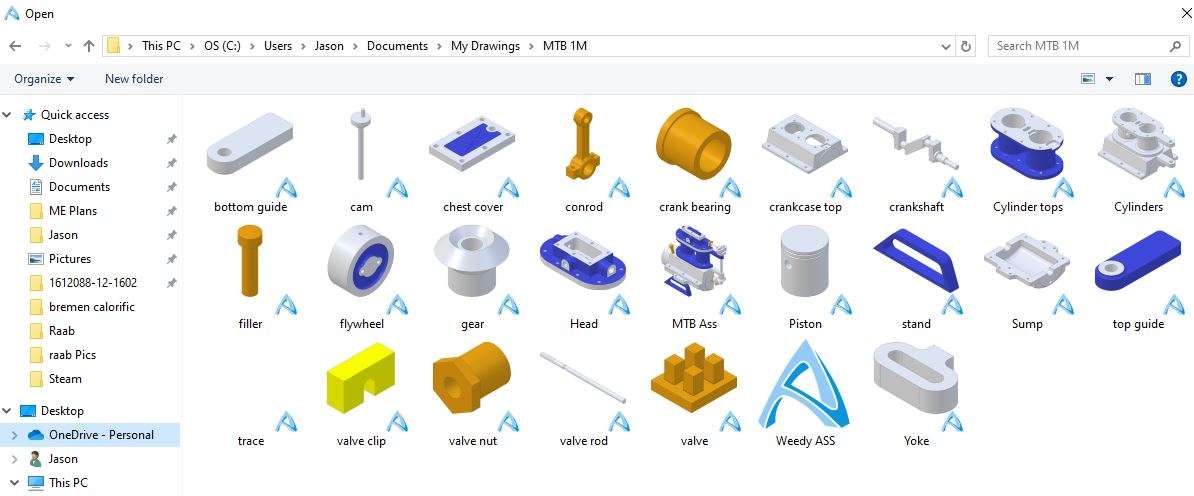

            Ha, yes – I made one of these to prop against the monitor stand when I first started, it helps ensure the parts arrive (hopefully) in the assembly space the right way up..

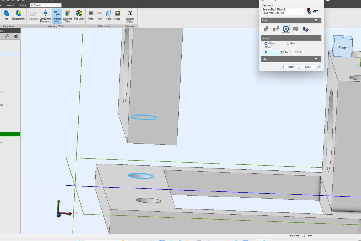

                            I do as Jason mentioned earlier, first just put a concentric constraint on the edges of the ‘stud holes’ and then either one on a matching edge of the block & base (to pull them together), or I just ‘stick’ the mating faces together, depending on how the parts conform..

                              Don’t beat yourself up looking to apply 3 constraints to everything as some parts won’t need that many.
                              Although you do need to set a parts position in three axis using a concentric constraint will actually locate it in two axis so you only need add a second to completely tie down it’s location.
                              Not to confuse you more so ignore this if anyone is an Atom user different versions of Alibre can handle that sort of constraint differently as they have a “fixing” constraint which will both make the two holes concentric and also bring them together all as one constraint, though I don’t tend to use that option.
