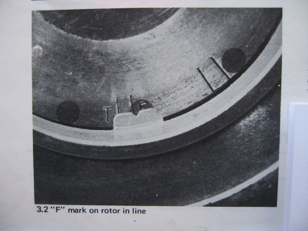

      Hello all.
      May I have a 'sanity check' please!
      From my last post on the Honda (re electrics), I mentioned that my timing may be 'out'. I have since checked the timing by two methods (instructions in the manual using feeler gauges and the T and F timing marks on the rotor, and a method using a multimeter) and both say it is OK.
      A subsequent check using a timing strobe 'suggests' it is way out – but I have now come to the conclusion that the instruction manual is a little ambiguous. The manual instruction (5) says when using a timing light ………… The two marks on the rotor should swing around and line up with the pointer when the engine is revved.
      What the manual doesn't say is that it is specifically referring to the two marks WITHOUT the T and F annotation. If it is referring to these unannotated marks then my timing is correct using the strobe light.
      Have I now interpreted that correctly?
      Please find the relevant extracts from the manual below.
      Best regards & many thanks.
      Alan

          My reading of the instructions is, that the two un-annotated marks will swing around to the pointer when the engine is revved showing that the advance and retard is working correctly.

            LOng time since I worked on a Honda single-banger but I believe the T mark is Top dead centre and the F mark is the Fully retarded timing mark that you use for static timing with the auto advance unit sitting in its natural fully retarded position. Then when you start it up and strobe it, the two marks without letters should swing around as you increase the revs and lie either side of the pointer. At idle I would expect the F mark to be in line with the pointer. You should see those two unlettered lines move back and forth as you rev the engine up and down.
            Easy check would be poke a wire down the plug hole and set piston on top dead centre and see if the T mark lines up with the pointer.
            But it sounds like you have it right.

              I think so, if it's like other engines. T is top dead-centre and F is the 'Fire' point at idle. These marks are used to set-up the engine before it's actually run.
              Ignition is advanced and retarded according to speed and load, and I think the Honda tune-up instructions are in two stages: first, with the engine off, set correctly for start and idle; second, with the engine running off-load at high rpm, that the timing has shifted correctly. When the engine is run fast the timing changes and the unmarked pair should align, as revealed by the strobe.

                As you say, the unannotated marks are correct for when the engine is revving. It is more important for the ignition timing to be correct at high revs than at idle. If the advance retard unit is a bit worn it may be giving more advance than needed, you can tweak the stops in a little with brute force if this is required.
