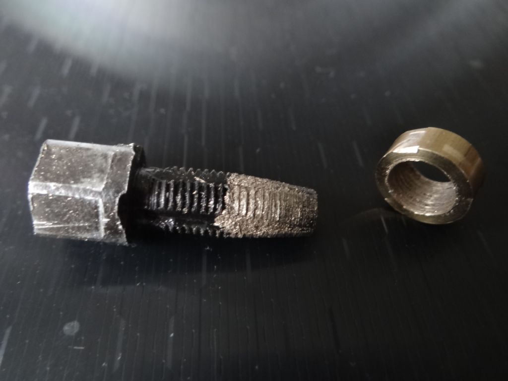

      The test piece is a short length of brass rod with an 8mm hole in it. I held the ring in the 3-jaw chuck and attempted the tap. It didn't go well!
      After producing some swarf the tap stopped cutting. It feels as if the thread is being ground and progress is very slow. The cuttings are paste.
      The picture says it all. Surprisingly the poorly defined thread produced by the tap mates with the male for a couple of turns. It's main fault is that the thread isn't deep enough.
      One problem is that the tap is still magnetic, ie not properly hardened after heating and quenching. How did I mess that up?
      The other issues must down to the way I've designed or made the tap – the teeth aren't cutting. How should a tap be made?

                What profile did you mill the slots to, if the edges have ended up with a lot of negative rake you won't get the tap to cut. If you used a ball ended mill then set it to one side of ctr don't mill on the same axis as the tap.

                  Looking at the photo; two things spring to mind
                  1. The taper on your tap looks rather steep … making it at least 50% longer would probably help.
                  2. Making the hole [say] 8.2mm instead of 8.0mm would almost certainly help.
                  It seems evident that the tap is jamming, and then stripping the thread, in preference to continuing to cut.

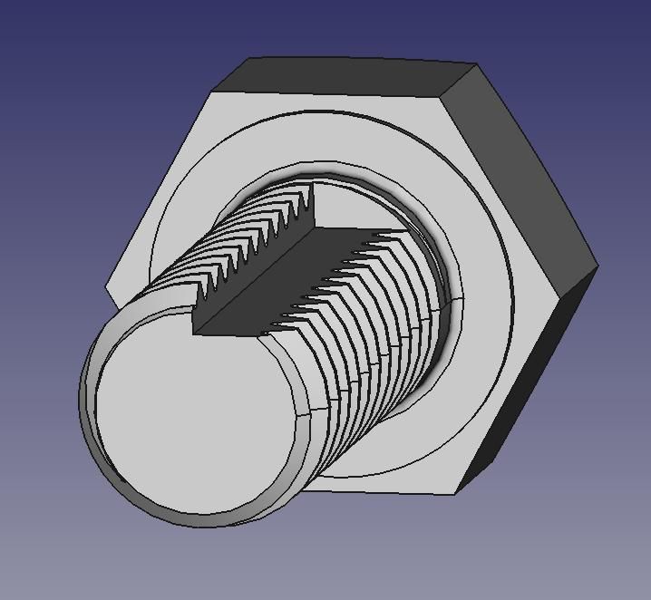

                    In answer to Jason's profile question here's a CAD mock-up of how I sliced the thread. I used a flat bottomed 4-flute end-mill to cut a slot mid-point on the bolt. I'm not sure that provides enough relief, or enough rake. It's certainly not how real ones are made!

                      Is it a left hand thread ? The slot shown in the CAD model might work for left hand thread, not for right hand.
                        I think you've got it David. Righty-tighty means I've cut the slot on the wrong side!
                        Oh dear…

                                              Looking at your CAD mockup. Even if you had machined it the right way around surely the angle of the cutting face used on the back turn of the tapping motion would push the swarf into the thread rather than cutting it off?

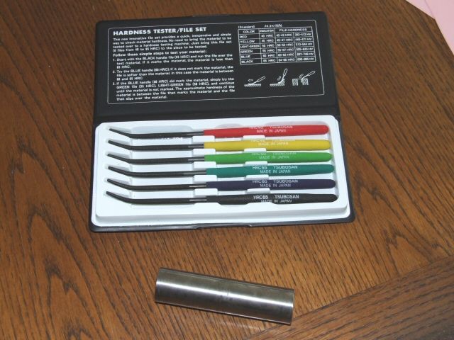

                                                I have a proper hardness tester but haven't got to grips with it yet. Currently I use these files to assess hardness:
