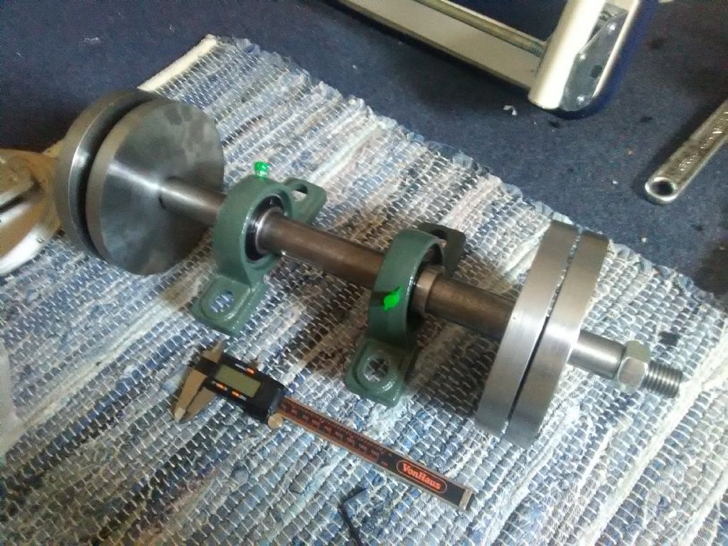

                    #299571
                    Rainbows
                      @rainbows
                      Finished the spindle and flanges just in time before I lost access to the workshop I was using. Impulse bought a CJ18A but its not gonna be as fun as the Colchester Master 3250.
                      The flanges/cups/washers are 150mm diameter, 16mm wide. Might have gone slightly very over kill with their size. Still need to make the space from the nut to them.
