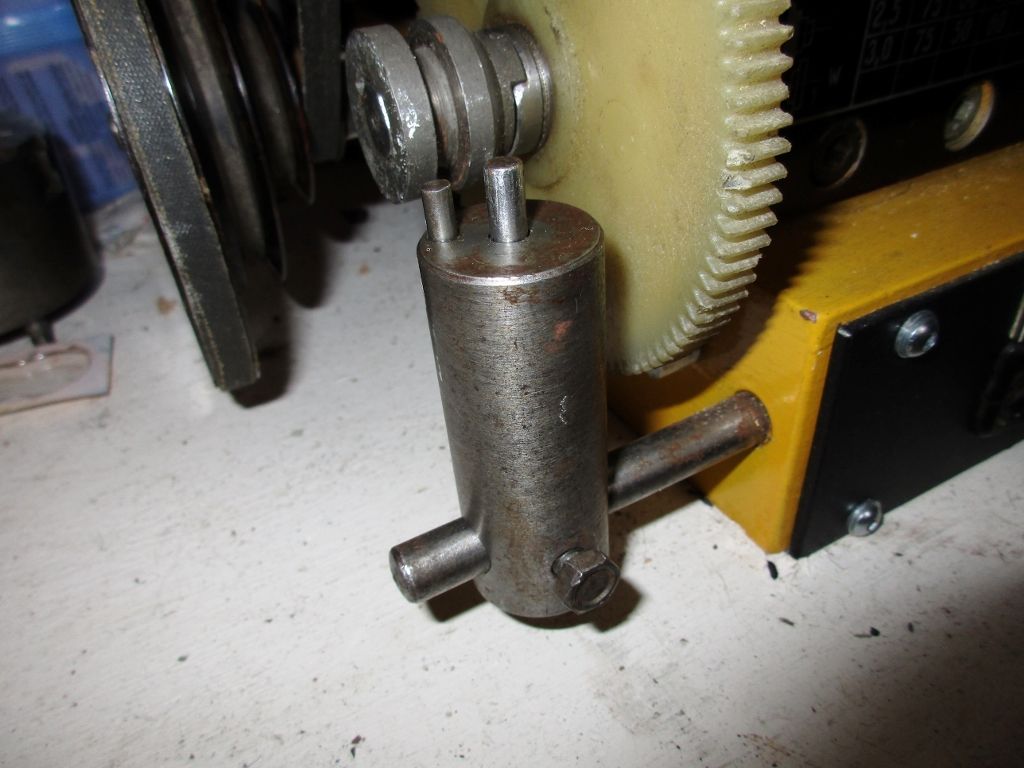

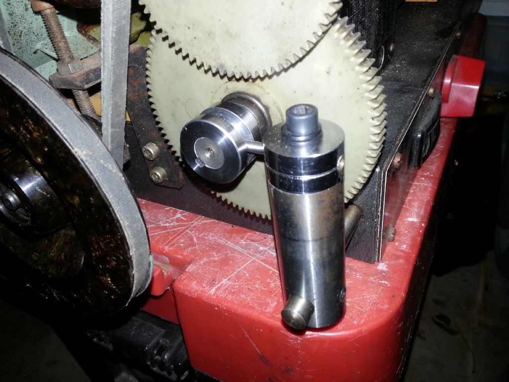

        I recently acquired an old (1979 vintage) Hobbymat MD65 lathe. The lathe was still in the Styrofoam packaging, but had some damage to the headstock end.
        The power feed coupling was missing but a quick search for the part number 3800-0211 turned up a post by a member on this forum and eventually a drawing of the part. I made the part but now can't figure out how the coupling control lever is supposed to engage the coupling to the change gears.
        It looks like the design of the control lever changed over the years. This is what I have:
        The control lever is the part with the two pins sticking out of the top. Is this missing some piece? Or am I missing something as to how it pushes the coupling into the change gear?

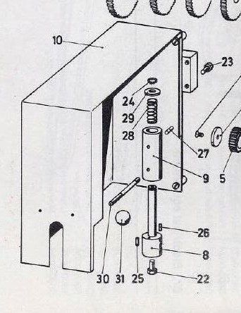

        Newer models appear to have this design (parts 8,9,etc):
        Thanks,
        Jon
        #236485
        Bazyle
          @bazyle
          AH, your vertical cylinder 9 is upside down. The off centre pin fits in a corresponding hole in the section 8 below when the system is out of gear. You lift it up to clear the pin to allow it to be rotated such that the horizontal pin 27 which engages the groove in the dog clutch can move the clutch into engagement. It is spring loaded so it remains engaged only by friction of the vertical pin on the smooth top of part 8 and can be flipped out of gear so the pin drops back into its hole locking it off.

            can't see from the photo but you do have two parts 8 & 9 don't you?
            #236489
            Jon Fairbanks
              @jonfairbanks32181
              I only have the one part. The top of the one part is almost to the center line of the lead screw.
              The screw that locks the part to the rod coming out of the bed of the lathe is on the side of the part. On the newer versions the screw appears to be on the bottom of the part (#22 in the exploded diagram above).

                This might help. The pin drive a dog clutch that form memory is under the headstock  lead screw cover. However looking at this image the dog clutch engages the gear on the leadscrew so maybe they have changed.

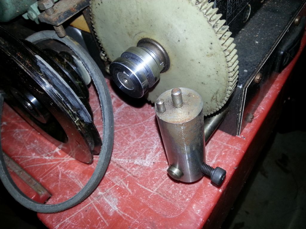

                      Nicholas Farr
                        @nicholasfarr14254
                        Hi, the dog drive control on my Hobbymat appears to be the same as Jon's, but alas I don't have the top part of mine either.
                        There is no hole in it for the pin that engages with the dog drive or for an operating lever.
                        Regards Nick.

                          You can see the line in Ajohnw's photo indicating the two parts 8 & 9. It looks like the design change made the bottom part 8 much shorter. Nick and Jon seem to have a longer post with a central pin ready to be used as a pivot for a lever that engages the slot in the dog clutch. About 10 seconds to design something and ten minutes to make.

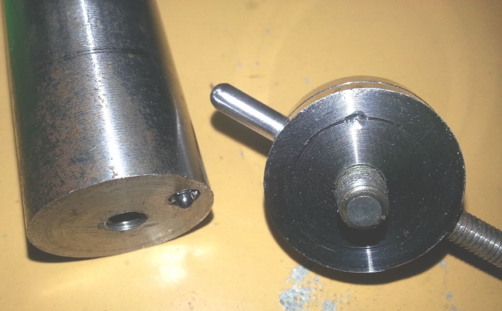

                            I took the advise from Bazyle and made something to work rather than copy the OEM design.
                            This is what I came up with:
                            I pulled out the 4mm and 5mm pins from the original part. The 5mm was tapped for a M6 X 1.0 screw. The 4mm was tapped 10-32 for a spring loaded ball detent. The new top piece has a 6mm axial thru hole and a 4mm cross hole. A 4mm dowel pin was inserted into one side of the cross hole and the other side was tapped for a 10-32 thumbscrew. The final step was to put a small drill point to coincide with the engaged position of the coupling dog.

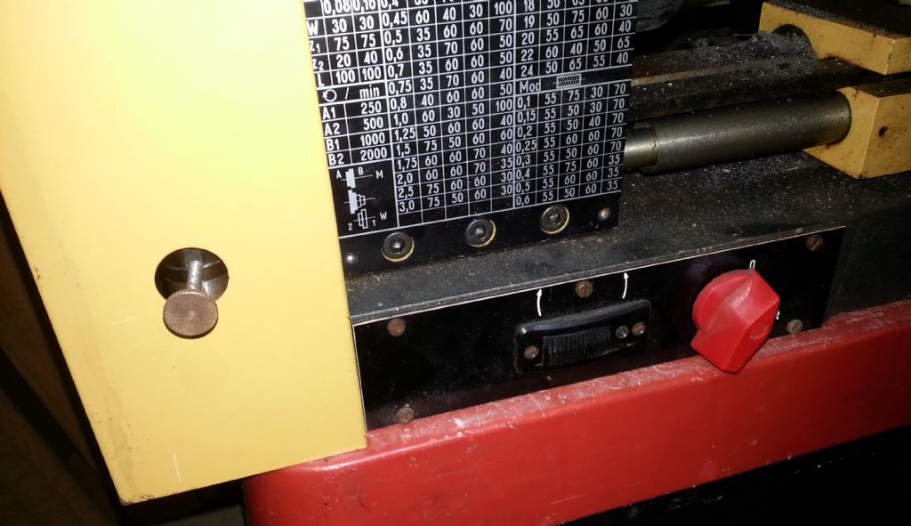

                            Works well. The detent acts to keep the dog from disengaging. This vintage MD65 has a hole in the belt cover so the thumbscrew must be removed before the cover can be removed.

                              Nice work Jon. Perhaps there are hundreds of the older model out there needing this. I'm a bit surprised though that there is an older model. I got mine in about 1981? at the first ME show it appeared at.
                              #237035

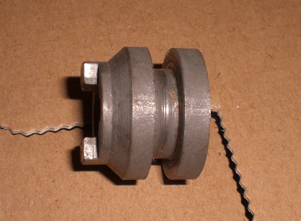

                                          #263115
                                          Nicholas Farr
                                            @nicholasfarr14254
                                            Hi Skye Leake, is this the drawing you are looking for?
                                            Regards Nick.
