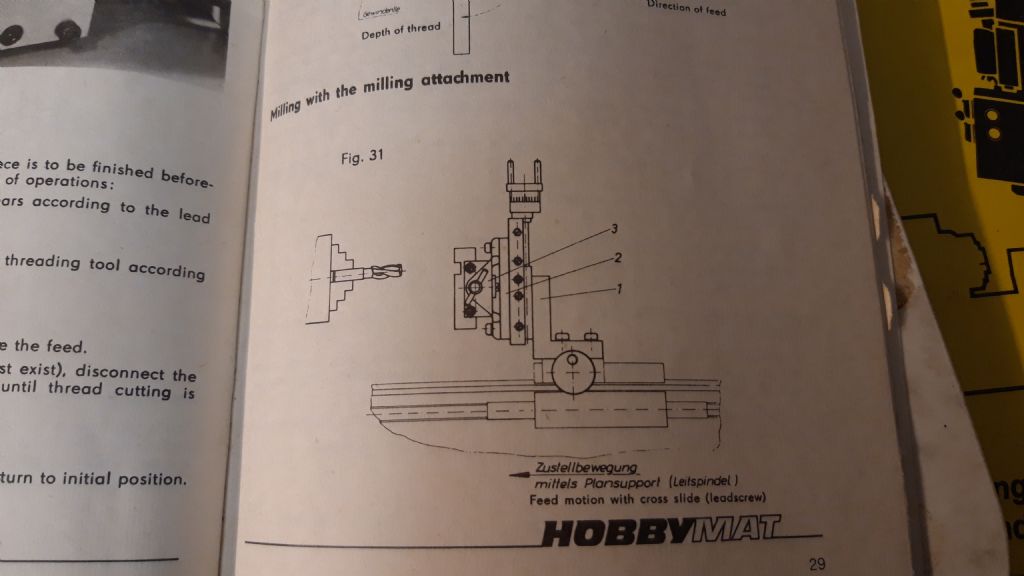

            The normal milling set up is to remove the topslide, fix the angle plate to the crossslide, fix the topslide to the angle plate and then fix the vice to the topslide.
            The plate is usually used with the milling head that bolts to the back of the lathe base (I believe that the original was aluminium)

                      Thanks Roger, I wil check out those suppliers, at least to get a cost comparison, I am guessing it will be spicy cost wise but you never know…
                      Thanks also for the description on the mull plate setup and cross-slide – I was being thick… all clear now – appreciated.

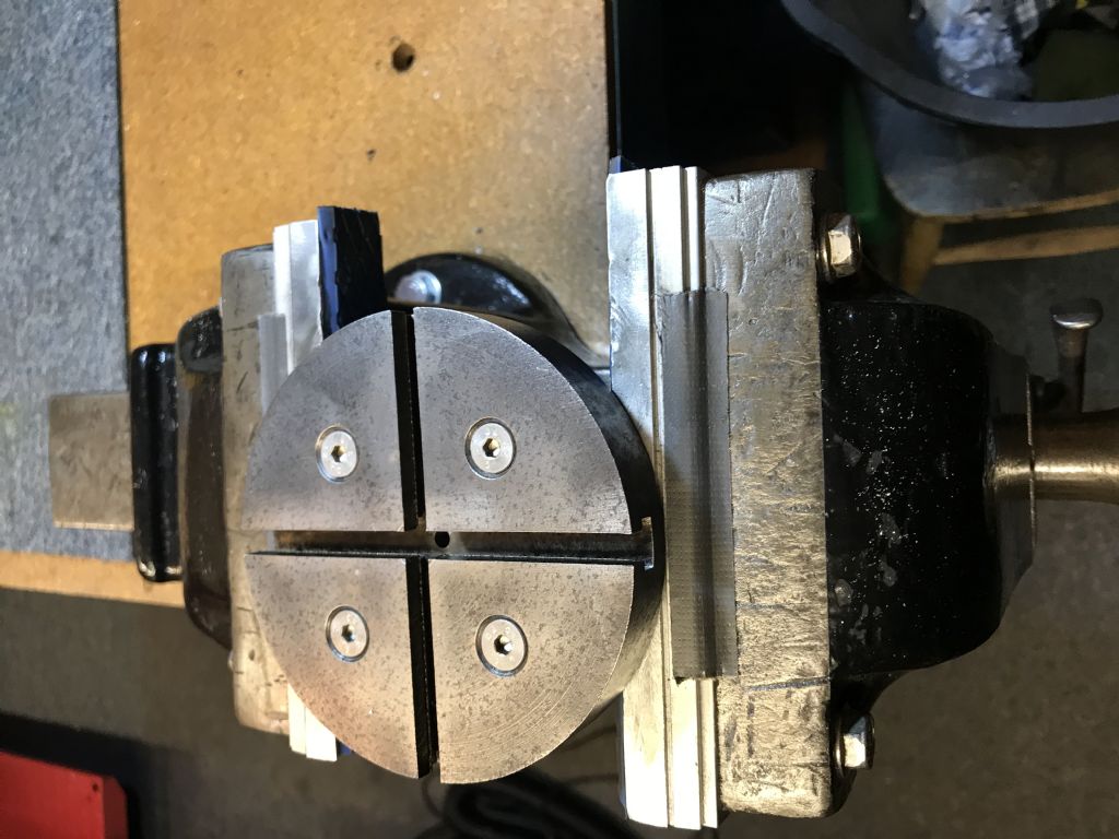

                          Chris, just a thought concerning the chuck jaw numbering which no one appears so far to have mentioned. Are all the jaws undamaged as far as the scroll teeth are concerned? I once bought a good looking Pratt Burnard chuck from 'Tractor Clear Out' event which had very little use – but I found that the 'thin' scroll tooth on No.1 jaw was broken, this meant that as it was now 'out of sequence' it was fitted last – so the fitting order became 2 – 3 – 1 rather than 1 – 2 – 3! Its worth checking.

                            Cheers Oily, it is a good shout. The chap I bought the machine from is a very savvy engineer and I would not expect him to have mis-ordered the jaws by mistake. I did put them back in numbered sequence and they did align well but will take off and check the jaw scrolls for any damage which I did not do, may even try an F1 chuck change time, down to 10 mins so far crying

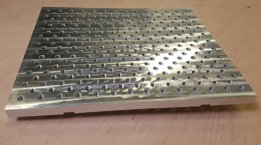

                            On the mill plate & T slots, I am going to go for interspaced M-whatever threaded into an ally plate, I am hovering over a 25mm x 150 x 150 at the moment which I could reduce in outward width.
                            Per Baz I think the T slot design may not be that flexible & fiddly. Pic of the sort of layout I'm thinking of but much smaller of course. Pic of current face plate as I see that did not work previously.

                                        Faceplate and bed design that I will copy (much smaller)

                                            Your photos of the face plate and table should do the job, and if you were wondering how to convert your lathe to a mill using your angle plate and vice here is a page of the set up from the Hobbymat manual.
