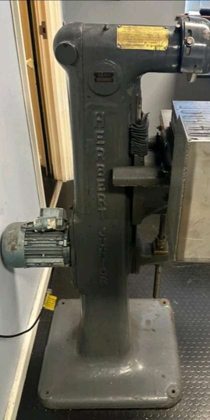

      Hi,
      I’ve just bought a little manually operated Herbert Junior surface grinder, I’m going to need to strip it down somewhat, is the spindle thread a left hand thread?
      When dismantling the knee and x y slides is there anything tricky to look out for? It looks a pretty simple little machine but you never know and I’d rather know before hand if possible,  many thanks in advance

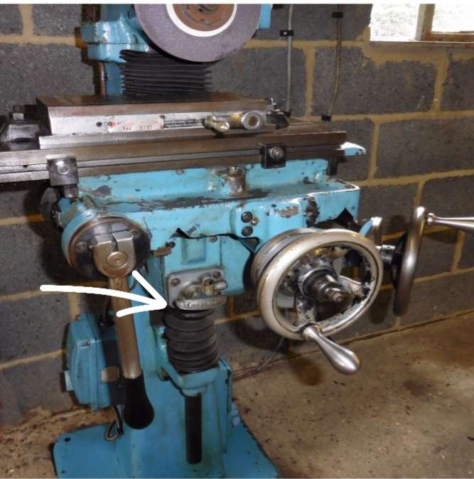

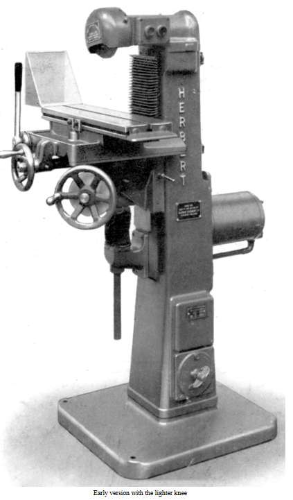

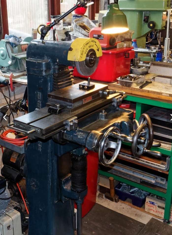

                    I’ve just been looking at these on the lathes.co.uk website, yours seems to be the mk2 as it has the head which is a separate casting bolted on, if you look at mine it’s one casting part of the main body.
                    It also states the mk2 should have a one shot oiler under the knee casting where I’ve put an arrow, does yours not have this?

                    peak4
                      @peak4
                      Pete. Certainly no one-shot oiler on mine, nor any provision for one,  neither is there an oil tank cast into the knee, as per the one in the restoration video.
                      Slideway oiling on mine is via a cross hole with drop down cover on the rear of the table, and oil nipples everywhere else.
                      Not seen one with an integrated head & column.

                        That’s a bit confusing, the lathes site just mentions the main difference between newer and older models is a heavier knee casting with the one shot oil system, there must have been more than 2, yours sitting after mine but before the heavy knee oiler model, if you look on ebay there’s a few the same as mine with all in one casting.
