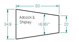

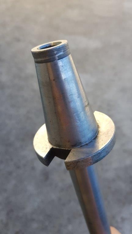

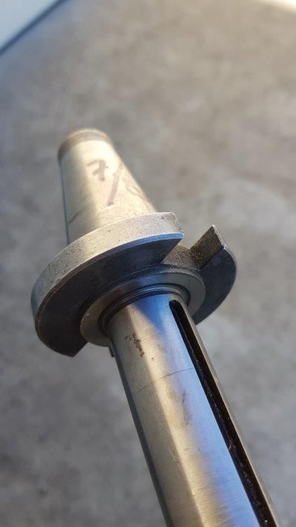

                          Finally worked out how to include photos with the post. So, this is the taper on the arbor. I've also included a sketch of the dimensions – these are 'as measured' so will be near but not exact, for example, the angle is most likely to be 16.59, indicating that it is a standard 3.5" in 12" taper.
                          Interesting to hear about the 1 3/8 taper. Wartime standard, could have easily found its way into a machine in 1949 I suppose.

                            I have a .png drawing of the NS taper (which also includes the 30/40/50 tapers) and gives their relative dimensions. The 'G' measurement – the top end of the taper, for the NS taper is 1.375" which is 34.9mm – so this seems to suggest this taper.
                            I cannot post .png images here but if you pm me – I will email you the image.

                              I also have an Adcock & Shipley 1AD and it is similarly equipped with the mystery taper that you refer to. I believe it is known as '1 3/8" N.S.' (N.S. for 'Non Stick&#39 and is described in British Standard BS 739: 1937 as '2 5/16" Nominal'. It is also described here:
                              http://www.oldengine.org/members/diesel/Tables/Clarkson1.htm
                              I have searched for more than twenty years for tooling and turned up precisely nothing.
                              I think you have two options:
                              1) I have turned up an adapter to convert the taper down to 30 INT. I can then mount a 30 INT Autolock chuck. It's relatively easy to do although it may compromise the accuracy a little. The taper is the same gradient (7 in 24) in the two sizes.
                              2) There is a modern CNC fitting, BT35 that is close, a bit bigger but should fit. Again it's 7 in 24 gradient but due to the increased size,it may need a drive adapter to engage the drive pegs. There are many fittings available from Lyndex-Nikken in the States:
                              https://www.lyndexnikken.com/BT35-Morse-Taper-MT1-Holder-p364.htm
                              I'm hoping to be able to use a BT35 to 3MT adapter and then use standard MT tooling.
                              Stick with the 1AD! They're solid, well made and accurate and have survived the years well.
