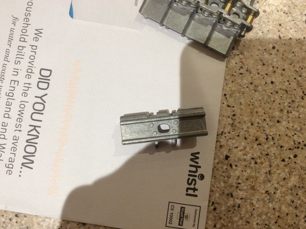

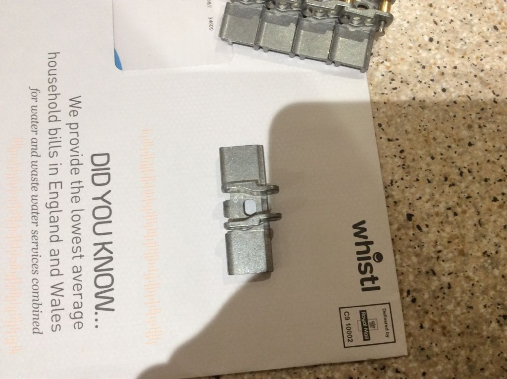

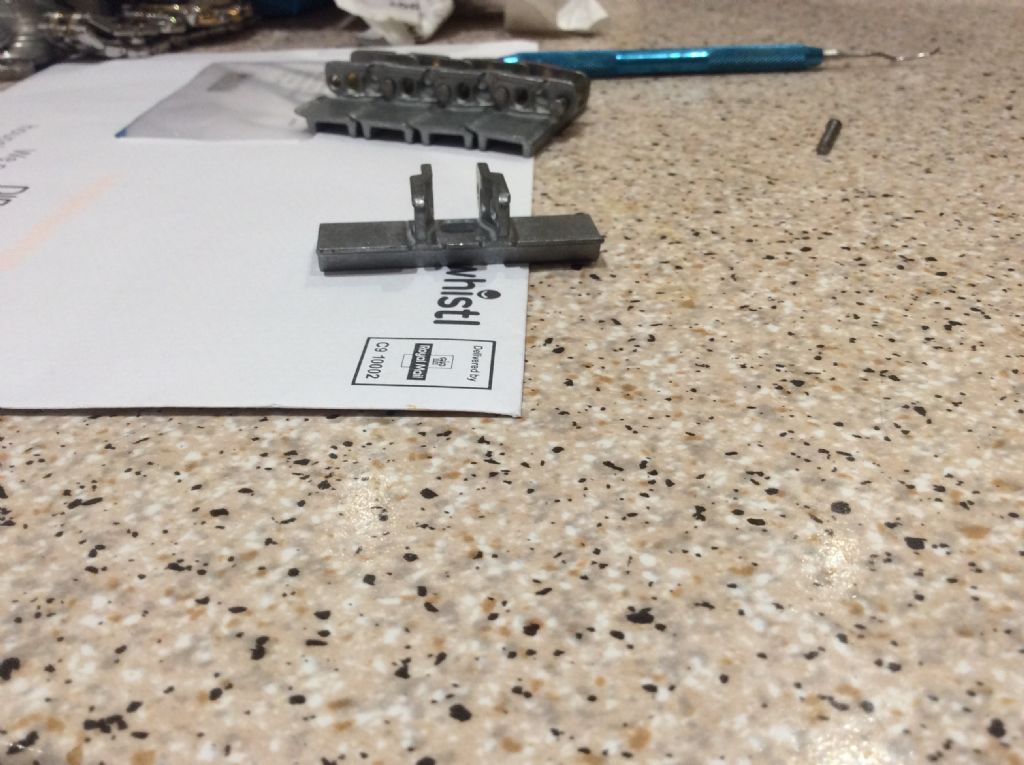

      hi all
      im wondering if anyone can help I need to try and replicate this part does anyone know how I can easily make a negative version to the make wax versions for the casting process I've never done any lost wax before but my limited knowledge suggests as this part is too complex to creative a negative simply, I suspect the original was die cast,
      its a track link for a model excavator and at €5 from Germany each quite expensive to buy over 100, copyright brigade keep calm 😂

                    Richard
                    As you seem to have parts already to use as a pattern would it be possible to make a mould by encasing one of the parts in a flexible silicone rubber compound and then splitting/cutting this at critical points so that when it is used as a mould it can be released from the wax without causing damage to the wax cast. If possible then several of these wax dies could be attached to a sprue and a multi piece mould made from this. I believe that there are products that you can encase waxes in that harden and can be heated to remove the wax and then used as a mould for metals such as aluminium. The linking pin holes on the tracks would be a problem but they could be drilled later especially if registration marks could be incorporated in the wax mould.
                    Don't know whether this is a possibility or I am just rambling.

                        I'd go with RTV silicon as Martin suggests. Make a mould of say 5 links carfully cutting the cured silicon so that the masters can be removed. I've done this a couple of times to make "recasts" Then cut gates and sprues into the silicon.
                        Pour the wax into the mould and repeat several times until you have suficcient to make a worthwhile metal pour. A soldering iron will melt teh waxes onto a tree which can then either be done in a flask or coated in several layers of investment.
                        On of your problems will be getting air out as that usually needs a vacuum pump.

                            Thanks for the replies lads for example the etc/silicone mold how would I remove the part after would it not damage the mold or if I split the mold to remove part to be copied would it not deform the part when pouring the wax
                            Rich

                                        The model railway cottage industry has this sort of project well covered, using two-piece moulds in high temperature silicone or RTV rubber and casting in type metal or similar material. If you want something more robust as in brass, you'll need to go the lost wax route.
