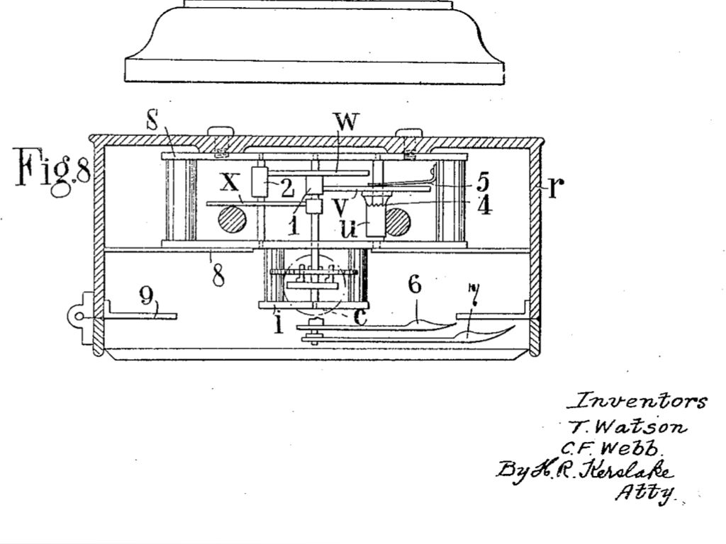

        One test you might do is to assemble the pendulum as normal, and swing it slowly and gently by hand past the central position. You should see that as the scape wheel is released by the edge of the half-cylinder, this is not exactly a sudden process, rather that the scape moves gradually at the end of the swing and is then released. This is necessary so that the scape tooth gives the pendulum a small nudge to keep it going. Then at the end of movement the other way, a further gradual release nudges the pendulum the other way. These little nudges are critical, and the surface conditions of the ends of the teeth, and the ends of the half-circle, as well as the shape of both, must be correct. This means very smooth as well as the right shape.
        In a conventional 'cylinder escapement' the scape teeth end in little blades like shoes, just long enough to fit exactly inside the cylinder as it rotates, and the outer face (the sole) of each shoe is bevelled to give the cylinder a push as it arrives and leaves. With your design, the edges of the cylinder seem to provide the slope, rather than the teeth of the scape wheel. If you look at the first pictures you include, the fifth shows the edge of the cylinder, and a distinct groove can be seen in the edge. I suspect that this is a wear mark, and may be one of the causes of your problem, as it means the shape is wrong. It may be possible to move the scape wheel along its shaft so that it bears on a new area both sides. If this proves difficult (depending on how tight the fit is) then an alternative would be to make up a packing piece to fit between the (black) pendulum bracket and the (brass) main plate of the movement. I guess that 1mm should be enough to move the cylinder enough to put the teeth on an unworn surface. And if it does not help, you can remove the packing without having spoiled anything. I am assuming in this dodge that both sides of the pendulum pivot are held in the black bracket.

          Posted by Tim Stevens on 21/11/2017 10:40:12:
          … I am assuming in this dodge that both sides of the pendulum pivot are held in the black bracket.
          Tim,
          Whilst I accept that there is no guarantee that Ian's clock exactly corresponds to the patent drawing; I think your assumption is likely to be invalid.

            Your video of stopping the 'scape wheel with a slip of paper seems to support my hypothesis that there is excessive friction somewhere in the train.
            If it was mine [which of course it is not], I would re-fit the pendulum and add some extra weight to the clock, to see if that makes it run. … If it does, you have excess friction : If it does not, then the problem may lie elsewhere.

              Posted by Michael Gilligan on 21/11/2017 18:00:09:
              Tim,
              Tim,
              I think I must retract my comment ^^^
              I have been looking at some other pictures, and it now seems clear that the pendulum is supported entirely by the 'black bracket'. … But note that the holes are [intentionally] greatly oversize and the pivots roll in the bottom curve of them.
              The logic of your 'dodge' is probably sound; 'though I can't quite see how the end float of the pendulum arbor is controlled in this clock.

                  Posted by Michael Gilligan on 21/11/2017 23:52:32:
                  Looking at the video, the pivots roll on a convex curved surface, like a ball race to give a self-centring action and the pallets are more than wide enough to allow for he potential difficulty of ensuring an exact position.

                    Looking again at the youtube video M Gilligan links to, it is clear that as the scape wheel moves it starts slowly and then clicks round. This is the effect I refer to above, with the movement of the scape pushing the pendulum to keep it going.
                    Looking at the pivots, as MG also reminds us, there is a rolling action rather than sliding at the pivots. Therefore it is clear that the exact shape of the rolling surfaces is important. The pivot must be smooth, and more important, I think, the base of the large hole in which it rolls must not have any groove or roughness. This applies to both sides of the pivot, of course. It may be that the clock in question is worn in these areas, forcing the pivot to slide rather than roll, and so increasing the friction.
                    I don't think (and I have not suggested) that the exact position of the pivot is critical. The only other factor I can think that would increase friction here is the need for some end float of the pivot. If this is eliminated (perhaps by adjusting too far in, ?) then this will add friction to the movement of the pendulum.
                    Finally I note from the video that the scape wheel shown there is held by a set screw on its arbour. This may be a clue to the option of moving the scape so that it contacts a unworn area on the pendulum.

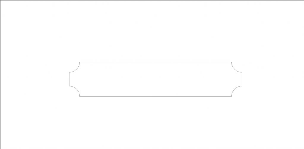

                                    This is my crude drawing of my impression of the spindle. You can see how it would self-centre so end-float would not be an issue. It also gives the desirable point contact:
                                    Edited By Neil Wyatt on 22/11/2017 14:49:21
                                    #328485
                                    Ian Parkin
                                      @ianparkin39383
                                      That’s how the spindle is but with longer small ends about 2.5mm long and overall its 10mm long
