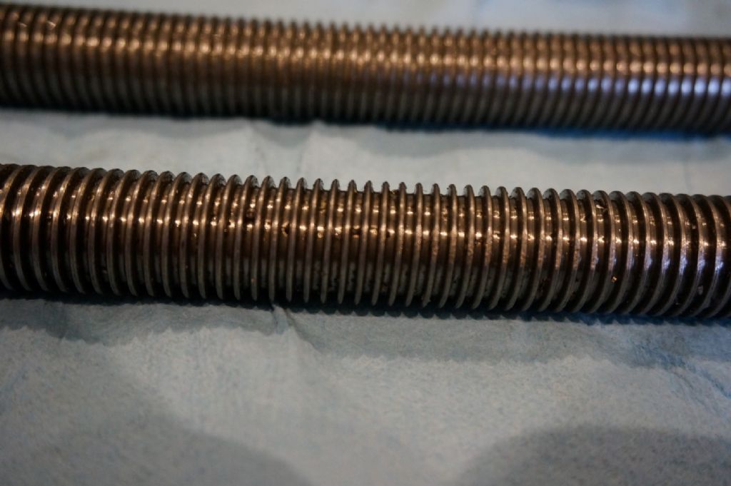

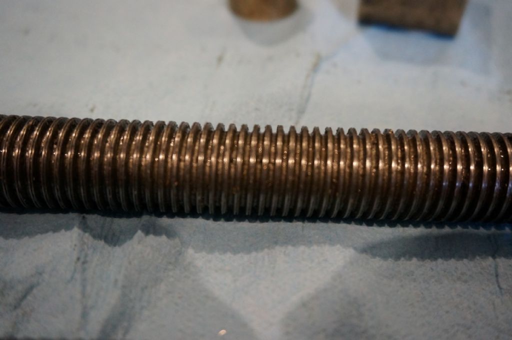

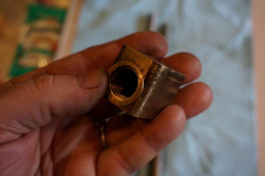

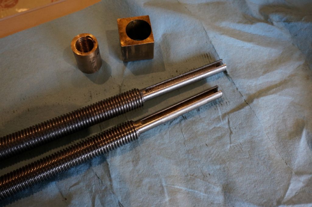

                                                Glenn here's your finished lead screw
                                                When I received the parts it was quickly obvious that the nut wasn't worn that badly but looking at the screw that was badly worn at the length that gets all the action…the flat top of the acme thread had worn to a nice rounded top.
                                                If the nut was moved to the unworn extremities there is hardly any backlash. I can only imagine that the nut is newer than the screw
                                                The nut is a simple 1" diameter bronze threaded 10tpi 3/4 LH pressed into the holding block and a oil/grease hole through to the thread
