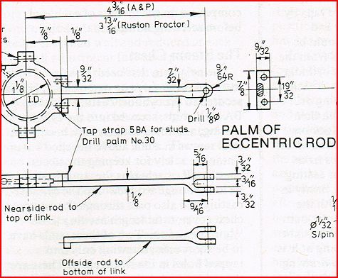

              Lovely weather, would anyone be interested in making me two eccentric connecting rods?
              i can pay £100, i know this maybe not enough but its all that left in my budget for this year, the rest of the engine will have to wait until tyhe ew year and summer.
              Regards Derek
              #168746
                I'll stick a drawing up later, If anyone has been following Dereks other threads they are for his 2" Ruston Proctor traction engine not more than 3" lone and probably cut from a bit of 3/8" x 1" BMS
                Having said that you could buy a hacksaw, few files, drill bit and reamer and have some change from your £100, the winter evenings in the workshop come free.
                Edit, drawing of the two eccentric rods attached, the 1/8" hole would be better if reamed

                      Hi Derek,
                      My worry is that making parts for a part-finished project like this isn't best served by picking it off a bit at a time for the drawings. The original builder is unlikely to have made any parts exactly to the drawings and, almost certainly, will be have been making each part to fit the previous parts. While any deviation in the lengths of the eccentric rods (for example) can probably be allowed for when adjusting the valves, if the eccentrics themselves are already machined the straps will need to be matched for width and bore – those 1 1/8" and 9/32" dimensions don't give the maker any idea of tolerance, and there isn't even a dimension for the internal groove. If you do get someone to make these – make sure you lend them the eccentrics themselves for the duration.
                      My advice would be to find someone local who could, if and when needed, have the engine with them to allow them to make parts, but also so you can easily go around and discuss progress or any changes face to face. These things are very difficult to sort by email (I speak from experience, having once been asked to make parts, but not supplied with any tolerances or guide to the required finish etc.), much better to be able to discuss face-to-face.
                      Ideally, find someone willing to keep the engine in a safe place and, when your budget allows, you go around and discuss what the next stage should be. That way you always know where the engine is and can have an agreement to be able to 'call it quits' and collect the engine without rancour if you ever decide to send the project or go down a different path.
                      This may not be the quickest or cheapest route, but I suspect it could be the least stressful for all parties.

                        thats all very good points, in fact i have machined the eecentrics myself, well the straps im send this away to get finished along with the other part.
                        i'm having my eccentric rods made but sending them the reversing link, so hopefully all will be ok.
                        i actually work as an technician and have alot of very good engineers around me, so as long as the part is a tight fit not loose i can always fettle to part until all fits well.
                        but fully agree its very risky getting someone to make the part, as it may no fit the rest of the engine.

                          Neil, I cropped the drawing as Derek was only asking about the rods at the time so cut off some of the strap details.
                          The most likely thing that will want tweaking is the offsets in the rods as it seldom works out that the crankshaft is lined up perfectly with the valve rod and weightshaft bracket
