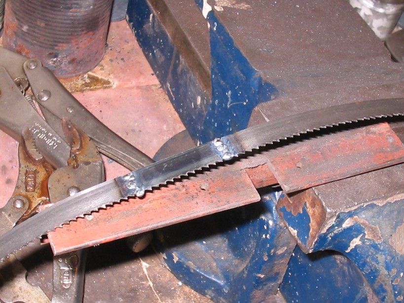

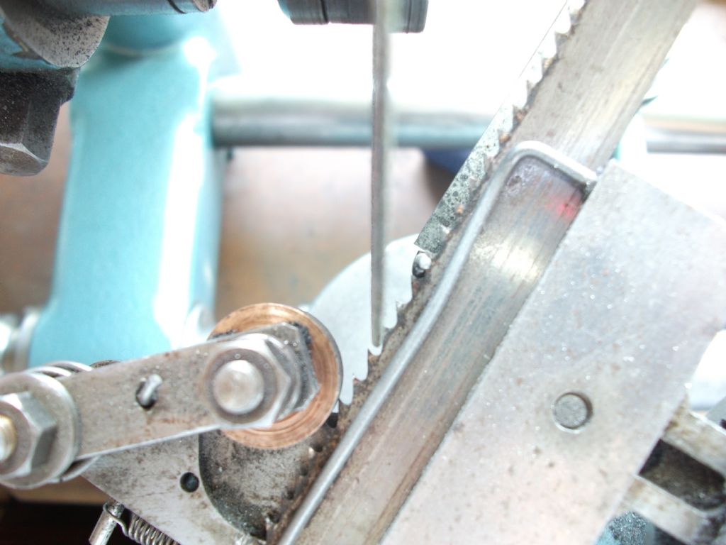

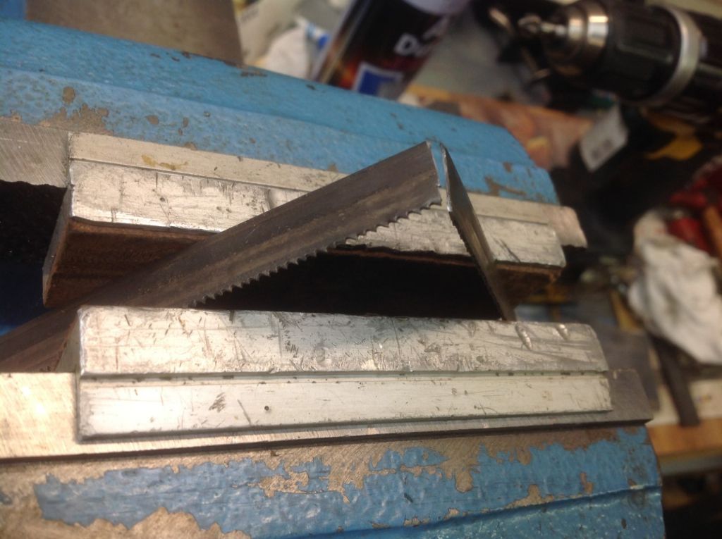

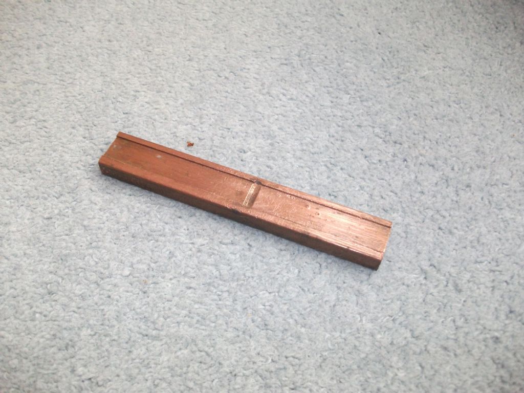

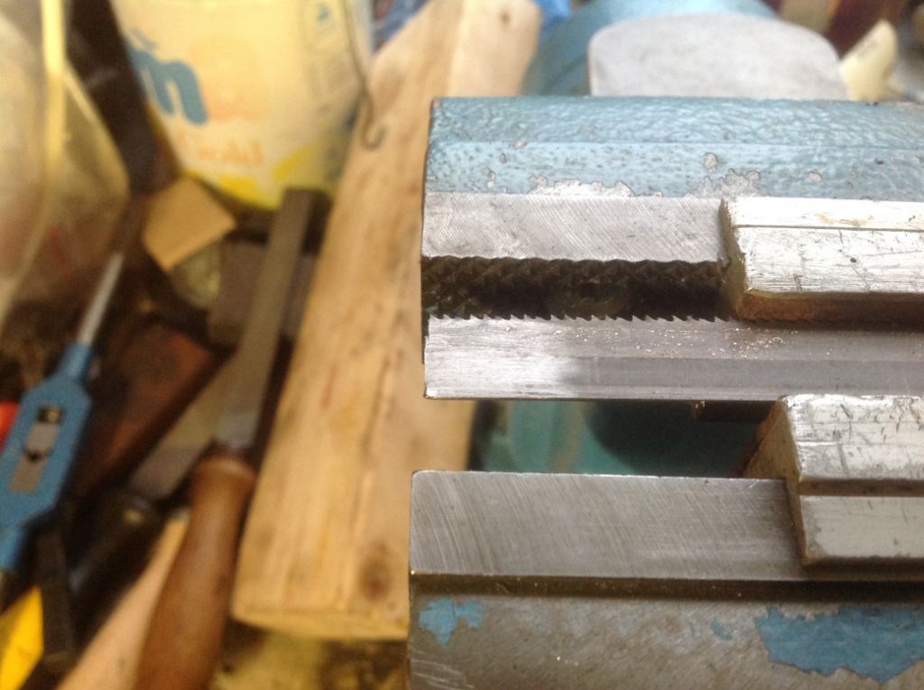

                                      The better option is to buy blade on a reel and make your own.I have not bought
                                      a made blade in over 20 years .
                                      An article written by me appeared in Mew 166 August 2010
                                      and shows how to do this just by Mig welding.
                                      The fixture here is a piece of copper bar ,the blade is clamped in
                                      the slot with some mole grips and mig spot welded through 2nd photo.
                                      They last long enough sometimes to resharpen but if they do break
                                      as in your photo you can just re weld them.
