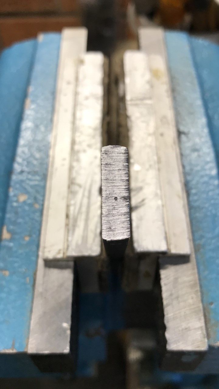

        After buying an Aldi Workzone bandsaw in 2019 and deciding to return it because I felt it wasn’t good enough for my needs
        (**LINK**)
        I some time afterwards decided I couldn’t live without a bandsaw so bought a more expensive Femi model, which, in some ways, was even more disappointing:
        **LINK**
        This too was returned (and subsequently lost by the courier, though that is another story).
        Feeling I still needed a bandsaw, last week I bought essentially the same Aldi bandsaw as before but this time branded under the Scheppach name.
        Like the first Aldi saw, out of the box the Scheppach would not cut perpendicularly to the vice/base. However, I managed to correct this by simply shimming the far side of the vice slightly. It now cuts perfectly square, even when what is being cut is something as thick as a piece of 4×4 timber.
        In spite of my initial elation, I soon realised that my bandsaw curse has not yet been lifted; there is a very disconcerting clunk as the blade kicks downwards into the work every revolution.
        You can judge for yourselves in a video a friend of mine has uploaded for me. For the record, I am cutting 6mm x 20mm hot rolled mild steel bar, the blade is fully seated on the wheels and bearings, properly tensioned, running on speed 2 out of 6, and not by any means being forced into the cut. There is no noticeable weld seam on the blade and no obvious (to me) reason why it kicks downwards.
        Whether the surface finish I’m getting is anything to do with this kicking downwards I don’t know, but I do know that the surface finish on brass, aluminium or mild steel is poor. (Attached photo shows 6mm x 20mm hot-rolled steel bar).
        Any suggestions on how to cure the downwards kick and improve surface finish would be greatly welcomed.

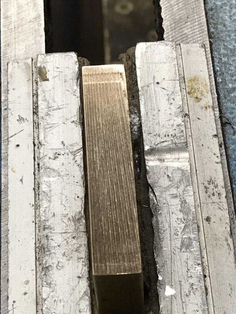

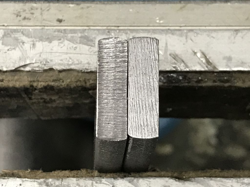

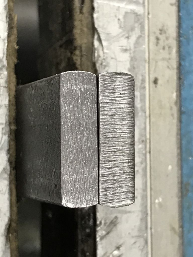

                      As for cut quality, I've uploaded a couple of photos of steel bar showing the difference between cutting with the bar flat and cutting with it standing on edge, as initially. Lying it flat produces an obviously better cut.
                      There are still two minor issues. The picture of the brass bar [in the first image and 3/8" x 2", I think] shows the first: the two short patches near each end of the bar. I can't detect any difference in surface height with my finger at these points, so I'm not too concerned by it, but does anyone have a suggestion as to why these markings have occurred? There is nothing on the surface of the bar either side to explain their existence, and further cuts produced exactly the same result. The bar was cut lying flat.
                      The second issue is that now I have shimmed the vice on one side with washers [around 1.25 mm thick], the plastic guard on the inner side of the saw slightly fouls the angled side of the vice at the bottom of the cut. I can probably resolve this fairly easily, but why the clearance between the edge of the vice and the body of the saw has to be so small I don't know.

                                                    Posted by Bill Phinn on 28/02/2021 22:02:00:
                                                    Those marks suggest a bad tooth on the blade, actually two or three bad teeth that distance apart !
