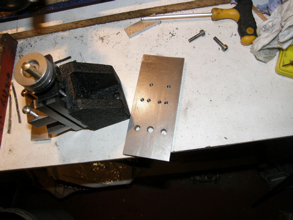

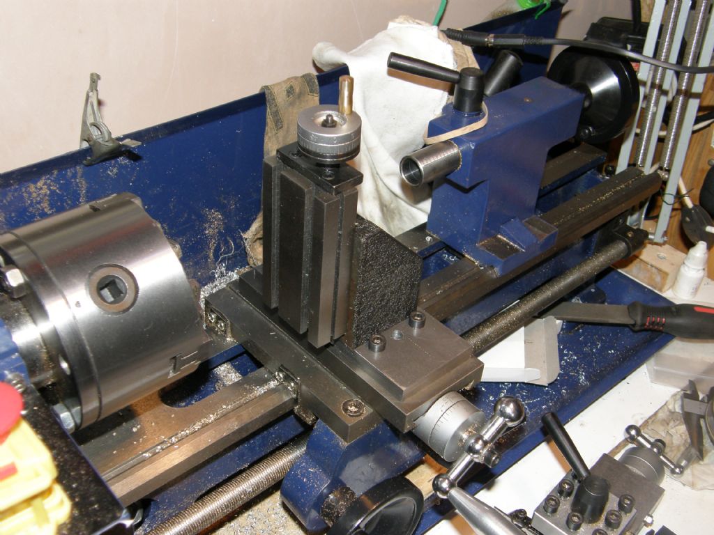

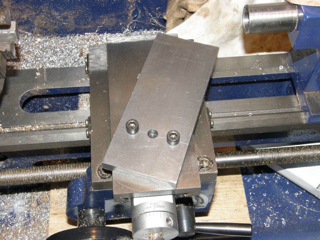

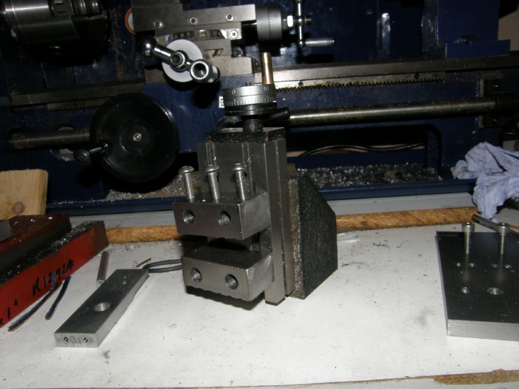

              Pics as requested (my photography is about as bad as my metal working). Hope this makes sense. The mounting plate is bolted to the swivelling mount which normally holds the compound; it seems to hold well and allows me to adjust the vertical slide to ensure it is square (I marry it up against the chuck face, then tighten it down – is that a sensible methodology?) The mounting plate already has three mounting positions for the slide to offer me different movement options as the travel of the vertical slide on the x axis is very limited – x-axis is across the bed, yes?
              Yes Jason I can already see the benefits of a decent small clamp despite my newly added larger clamps – I'm going to check that out.

                Your methodology is 'near enough' for manysmiley. However, after the initial lining up against the chuck, it would be far better, for accuracy of better than perhaps half a mm, to 'fine tune' using an appropriate dial guage. That 'half mm' assumes you get it as close as a 1/4 mm on one mounting and a 1/4 mm the other way, on the next time of mounting.smiley

                      Make sure your lathe saddle is clamped solid when working, lifting of the saddle is a big problem. Ridgidity is a big problem when using the lathe for milling. Invest in a collet set if you are going to do a lot of work.

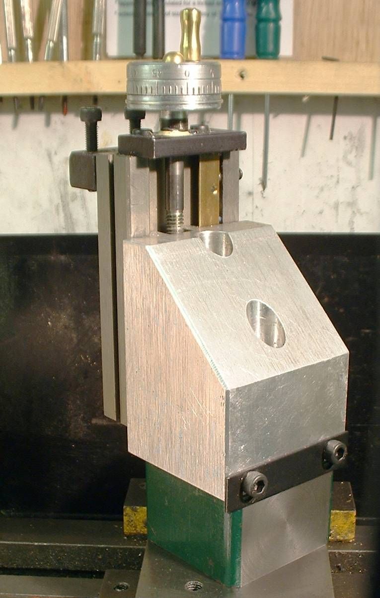

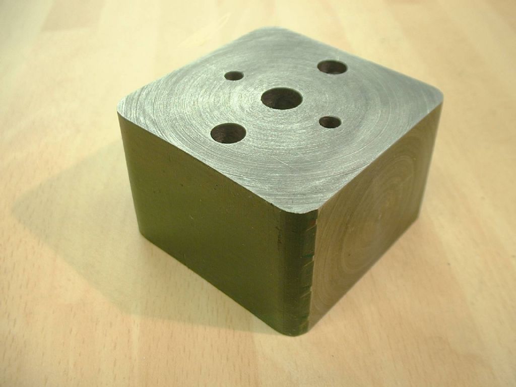

                          Very similar to my setup.
                          I made a raising block so I could use the full travel of the slide without it hitting.
                          I also made an extra block with two 2BA hex screws that slide in the t-slots (fairly close fit). This lets me have a 'vice' with two jaws rather than the jacking screws pushing direct on the work.

                          Raising block on rotating base – the fence on the back of the slide aligns it with the raising block, the edges of the cross-slide are accurate enough that you can align block (and therefore vertical slide) using a protractor (for an angle) or a square

                                Sorry just noticed your question about the backing plate. My (Chinese) slide is probably a bit bigger than the one Neil is showing in his pics but has the same basic design of two blocks that are attached to the slide face by T-Nuts that run in the vertical T-Slots. My experience was that the action of clamping the work (using the three clamping bolts in Neil's set-up) tended to force these two blocks apart, thus weakening the clamping action and also upsetting the work setting.
                                So my solution was to make a thin (2-3mm) backing plate with two vertical rows of holes drilled in it (sized just clearance for the T-bolts) spaced vertically about every 25mm and matched in width to the slides T-slots – such that the T-Bolts (and blocks) are held in position and cannot be forced sideways (e.g. up or down). I'm afraid I cannot find the plate at the moment as the vertical slide is generally used for something else these days and when I do use it as intended, I now use a small vice that fits it quite nicely, thus avoiding the problem… but it's just a square plate with two rows of holes drilled in it…
                                It may be that you will not experience this issue with your slide – but if you do this is a quick and simple solution to the problem – as any scrap plate will do the job and it will be cheaper than just buying a new vice, when there may be (nearly always are) other things that you might want (or even need) first…

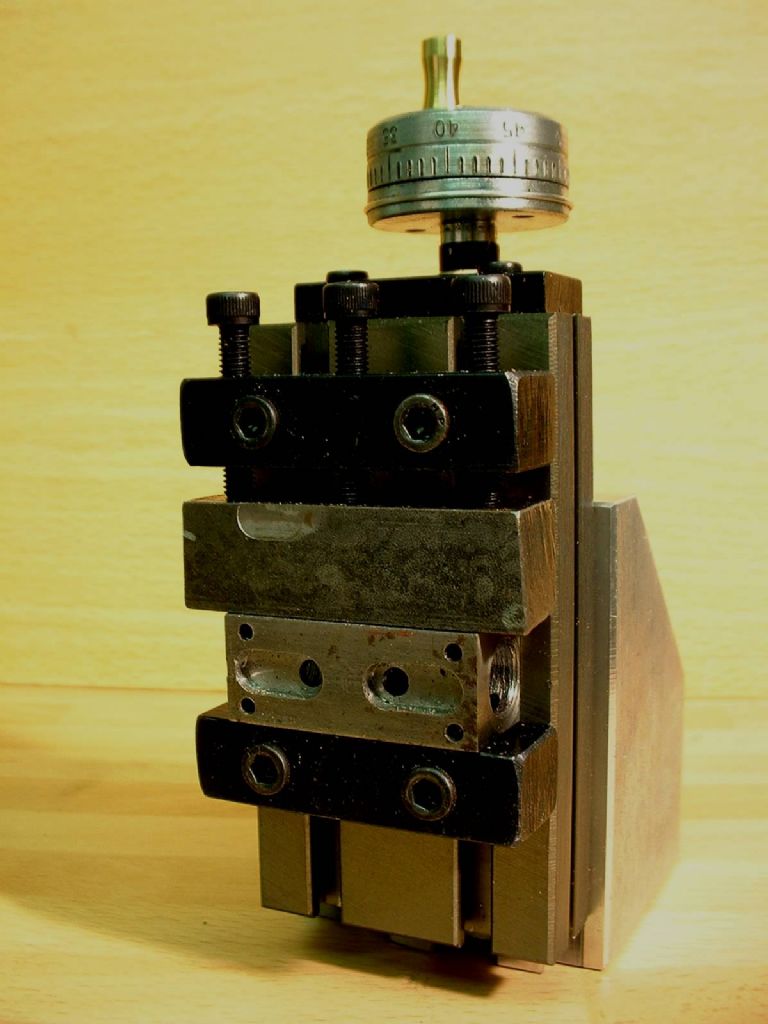

                                        Just a warning. I bought a similar slide a couple of years ago. I think it was from RDG but I'm not sure.
                                        It had no end of problems. The top plate was angled about 10 degrees off squareness the holes a been drilled in the wrong position. This caused the leadscrew to be well off centre in relation to the nut.
                                        Also the brass gib angle was out by 15 degrees rendering it pretty useless.
                                        I had to remake pretty much all the parts except for the body and the table.
                                        I also added a thrust bearing and a capstan drive thingy.
                                        In retrospect I should have sent it back. The ones I handled at the RGD stall at Ally Pally seemed fine.
                                        You can see it in this picture.
                                        Anybody else had similar problems with this slide?

                                            Phew! Just posted a reply and then saw Steve's photo above – and thought for a moment that I'd had a Senior Moment and just posted my reply to the wrong thread….
                                            laugh
                                            ianT
                                            #374076
                                            Steve Crow
                                              @stevecrow46066
                                              That's probably my fault Ian. I've posted the same picture twice today in reply to different threads!
                                              Steve
                                              #374078
                                              IanT
                                                @iant
                                                No problem Steve – it's a good photo to share – but it did startle me (and fortunately my wife didn't hear the expletive!)
