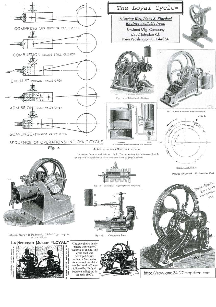

          Here’s an article by ‘ETW’ who I assume is Edgar Westbury explaining how it works
          https://www.modelenginenews.org/etw/systeme_loyal.html

              Thanks Duncan the image that shows the five stages of the cycle is very similar, H&P had the exhaust valve as a pivoting flap rather than a sprung valve as shown. The model is not going to use a flap as it would be very small at this scale though a reed type valve was considered. The engine I have based it on did not have the governor. Also at this size a scale looking hot tube is not very practical so may be spark ignition. Graham has had his running but with a non scale hot tube but more of that later.
              hardy 5
              Description of how it worked (fig 2B)

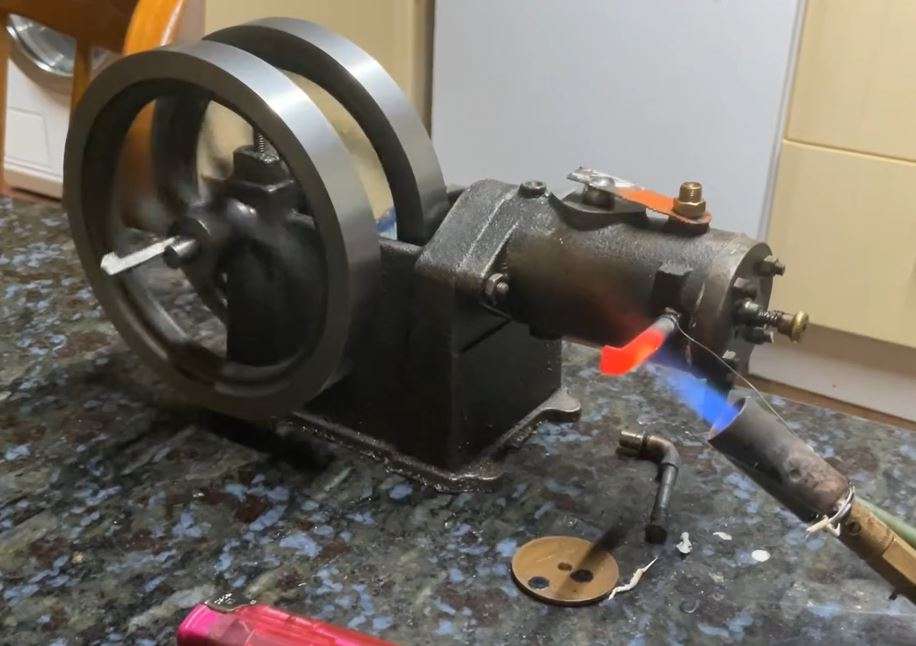

                      This is Graham’s prototype running on propane with spark ignition. It also runs on hot tube ignition but has prooved a bit difficult to get the size of the hot tube small enough to look in scale.
                      Being even more practical than me you may notice his use of a bit of hacksaw blade to retain the exhaust’s ball valve and out of site is the ignition contact which is simply clipping the wire in the right position so it grounds on the conrod as that come round. Don’t think he used the clothes peg gas regulator on this run. And yest it is running on the Kitchen table

                          It is not helped by the fact the hot tube on this one fits into the side so you either need a bend or a joint, easier if it came out the top of the cylinder or head.
                          An RC “nitro” type Glow plug won’t work with propane or petrol it needs the methanol vapor which acts as a catalyst on the platinum wire to keep it glowing. Most model engines that make use of that type of glow plug have  apermanent supply to keep the plug glowing.
                          Big blow torch will also keep a hot tube hot.
