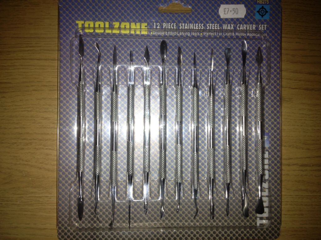

      Hello,
      I recently purchased some stainless steel (no idea what grade or composite) wax carving tools from the market. I have found these invaluable for some of the more niggly bits of various modelling tasks. However the thin flat tools often let me down by being too soft and bending.
      Is there a way I can harden these by tempering and quenching? What colour would I need to get them up to? How would I go about the quenching?
      Thanks
      Thom

          Hi Thomas, generally stainless isn't hardened, if your flat tools are bending and you did manage to harden them they would most likely snap.

            You probably can't heat treat them, you may work harden them by planishing with a polished hammer of suitable size. You could always experiment with one of the least useful shapes.
            These tools are really made for wax carving believe it or not. We used them by gently heating in a spirit flame when making wax models for investment casting, it was more a case of 'wax forming by melting' rather than a simple straight forward carving process. Therefore they didn't need to be particularly strong or hard.

                  Hi Thomas, many grades of stainless steel will not harden by heating and quenching. Generally speaking if it is an austenitic stainless steel, that is, if it has little or no magnetic attraction then it will not harden by heat treatment.

                    There are different types of stainless (ferritic, austenic & martensitic)
                    300 series are probably most common – these are austenitic, they work harden like crazy – but do not quench & temper
                    martensitic, can be quenched and tempered – think surgical blades
                    ferritic – I don't have much information to hand at present !
                    So some stainless grades can be quench hardened, but many can only be work hardened. You can sometimes (but not totally reliably) identify austentic steels as being non-magnetic (work hardening can tip them into being magnetic…).

                                  Okay, so I just tried them against a strong magnet and there is a fair bit of attraction – it could have been more but was certainly stronger than what you get with SS mahine screws so my reckoning is it isn't austenitic. I will give the hardening a go and report back. I don't want to try this if it ends up annealing and softening the tools though, anyone have thoughts on this?
