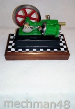

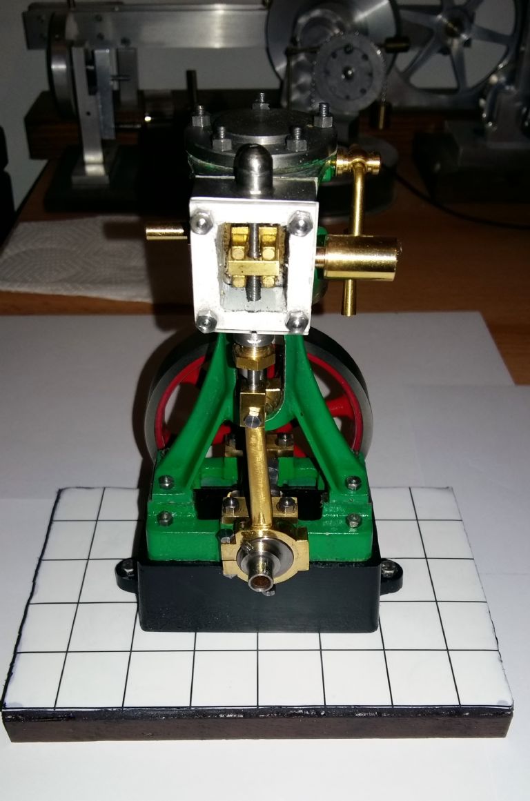

                    Not a loco but Stuarts engines, my two latest engines were primed with grey etch primer, then followed up with 'Rattle can ' spray, then a coat of 'rattle can' clear lacquer & both look very pleasing… to my eye… all spray cans bought from my local Halfords ( usual disclaimer ) … in effect car body paint…
                    ​George.
