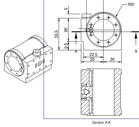

                                            I’ve also managed to create section-drawings of that cylinder-block to help me design the various passages.

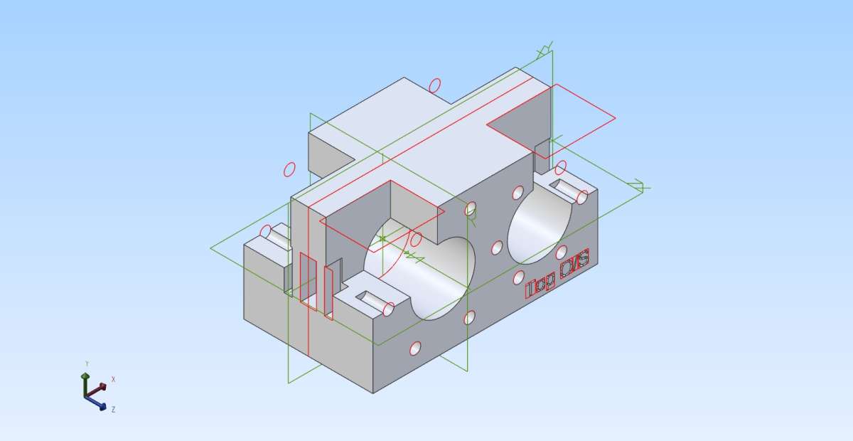

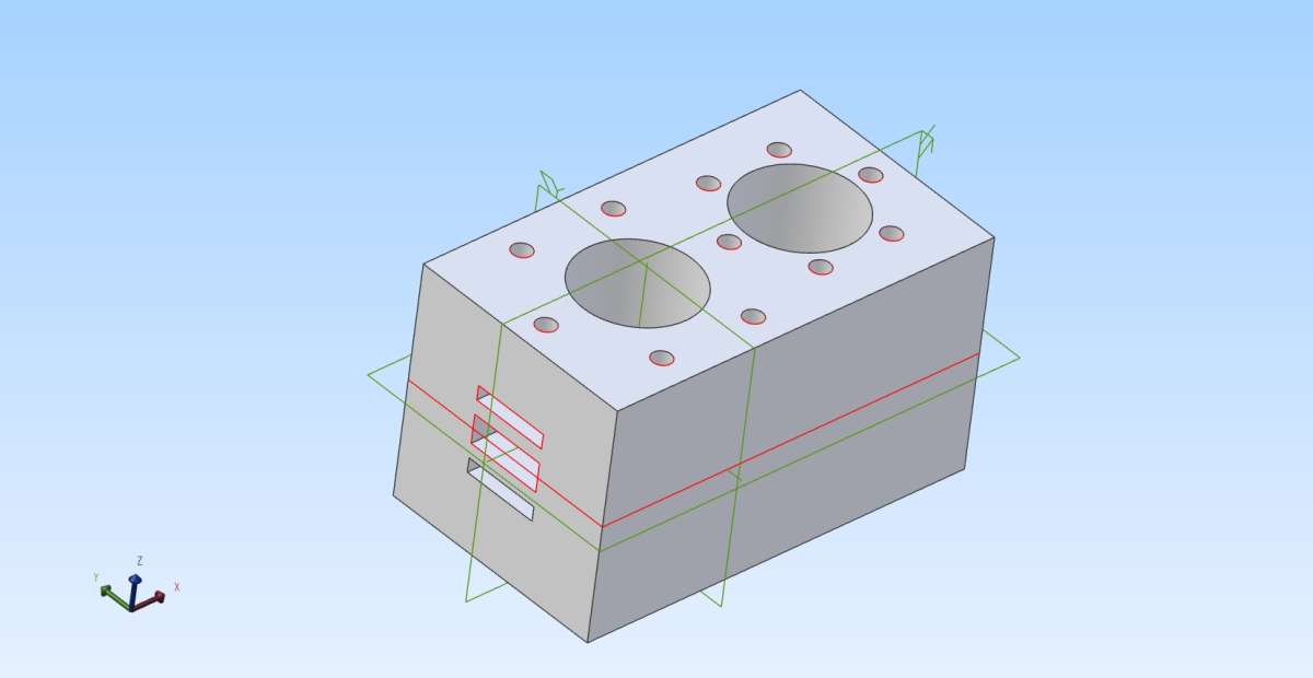

                                              A special drawing: I could not work out how to plot the 4 set of passages between the ports and cylinders more directly on the CAD model.
                                              The two prints (crank-end and cover-end) of the orthographic views of this cut-away give me the foundations for working out just where the angled drillings can go.
                                              To make it more fun, the passage sets all differ in angle. That is because the block is not fully symmetrical, displacing the cylinders slightly towards one end, and the cylinder covers come in three flavours! This results from making the engine top look as if compound. The two sets of ports are the same.
                                              A further effect will be the valve-chests being of different depths, though the cylinder and eccentric-pair centre-lines are symmetrical on the crankshaft.
                                              I didn’t know the Sketch Text tool would work as it does: I took a chance on it. I imagine it would be ideal for preparing 3D-printing or routing files for name-plates etc.  The “engraved” legends read ‘Top O/S’ and ‘Btm O/S’, and strictly speaking should lie along the image’s “vertical” end edges. The image’s upwards-facing surface here is really the unit’s front face.
                                              Cylinders - for passage dev - cut-away IMG

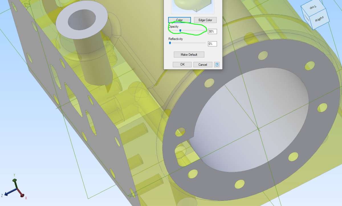

                                                I’m not 100% sure if Atom has it but a couple of other options if detailing within a solid item.
                                                1. Go to “Part Colour” and use the slider to alter the opacity and make the part semi-transparent
                                                opacity

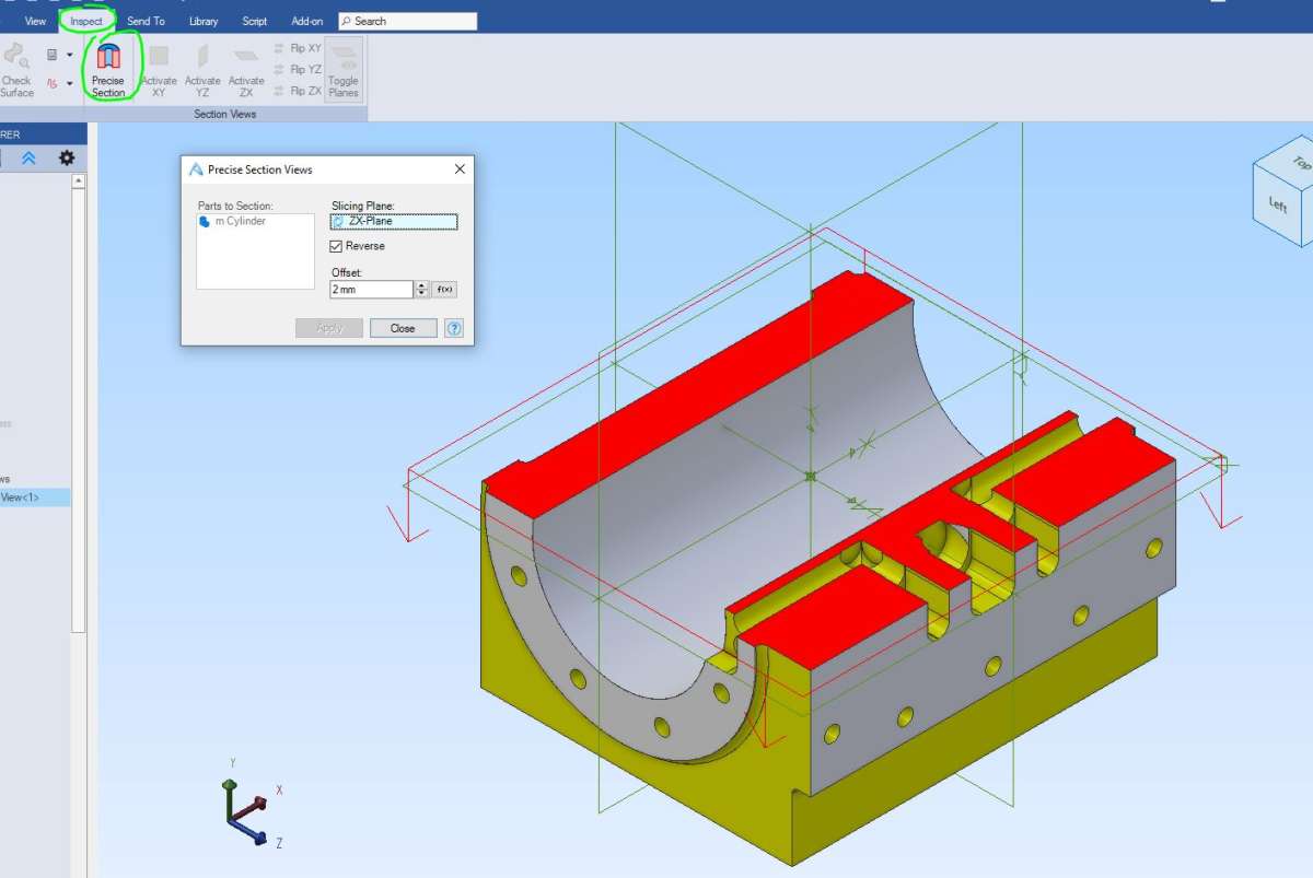

                                                2. Along the top go to “inspect” then “Precise section” and fill in the box.
                                                section
                                                3. Create a 2D drawing of the part and then create sectional views on that drawing
                                                section 2
                                                From the images have you considered just drilling at right angles as your passages are not going to be far off 90deg
                                                drilled at an angle then doing them square will not make a lot of difference to performance.

                                                  You can make 2D sketches in Atom3D whilst a Precise Section View is active – use the precise section view to temporarily cut part in half (say) so you can see the internals whilst working on the sketch for next feature.
                                                  Whilst extrude cut of a circle is the obvious way to make a drill hole, there are other options.  Use the line tool to form a thin rectangle half the hole diameter, at the required angle to intersect other passages – then revolve cut it around one of its long sides.  This can avoid having to add angled planes to drill from.
                                                  Remember than you can go back and edit sketches & features – nothing wrong with placing something roughly in place, look at the result, go back and adjust until it is satisfactory.  Equally if cutting hole from an angled plane – you can alter the angle for the plane to adjust the path of the hole.
                                                  Unlike in the workshop, in CAD a part isn’t scrap because of a badly placed hole – adjust or delete the hole.

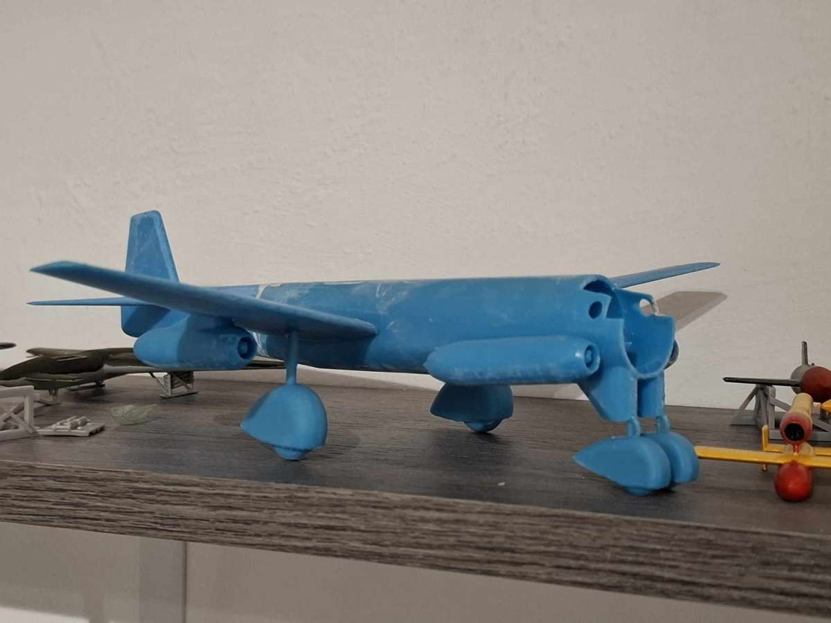

                                                      I’ve been doing a lot of work in Alibre over the last couple of years. Chiefly modelling tanks, planes and missiles up to 1945.
                                                      My current project as of last week, a JU 287 in 1:72 scale (as are the various missiles scattered about). Some unusual techniques here:
