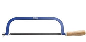

      Hello all,
      I’ve read a few times that it’s important to ensure that a hacksaw blade (12″) is at the correct tension but what exactly is the correct tension and how do you know when you’ve set it?
      cheers, d.

          i usually set mine pretty much as tight as i can, by hand, and i try to release the tension when done.
          haven’t broken many…
          – russell
          #74819
          Bill Pudney
            @billpudney37759
            I seem to remember from my apprenticeship that it was….take the slack off then three turns of the wing nut.
            Its worked for me for the last 45 years.
            cheers
            Bill Pudney
            #74825
            Gordon W
              @gordonw
              My old hacksaw has instructions on it :- take up slack, then 3 turns, it’s an Eclipse from my apprenticeship days, so a bit bent now. My newer one has a sort of cam action tensioner which seems to be about the same amount of movement. I usually tighten a bit extra when attempting to saw straight lines.
              #74826
              The Merry Miller
                @themerrymiller
                Same routine as Bill and Gordon, take up the slack then three turns of the wing nut or whatever.
                Don’t forget to slacken off afterwards.

                          #74868
                          John Stevenson 1
                            @johnstevenson1
                            For a start get a decent hacksaw frame, if you have a tubular Eclipse one then chuck it at next doors cat.
                            The tension on a hacksaw blade is far more than you think, that much the wimpy frames were grew up with won’t cut it.
                            Believe it or not you need the blade under a tension of 28,000 psi to 50,000 psi, no not a typo this also applies to band saw blades and you can but a special clamp on indicator that gives pressure and can be worked out to how much stretch in thous or 0.xx mm
                            See if you can get a cast alloy Lennox frame, with these you fit the blade, take slack up and tighten 9 turns, once tight you can play tunes on it. The tubular ones will not tighten up this tight, they just keep bending.
                            This is the cheaper one, about £20
                            and this is the higher strength one, about £30
                            They are well worth the expense as there is nothing worse than a frame that bends all over the place.
                            John S.
