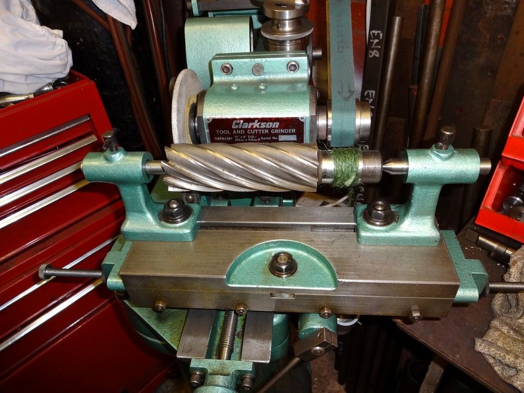

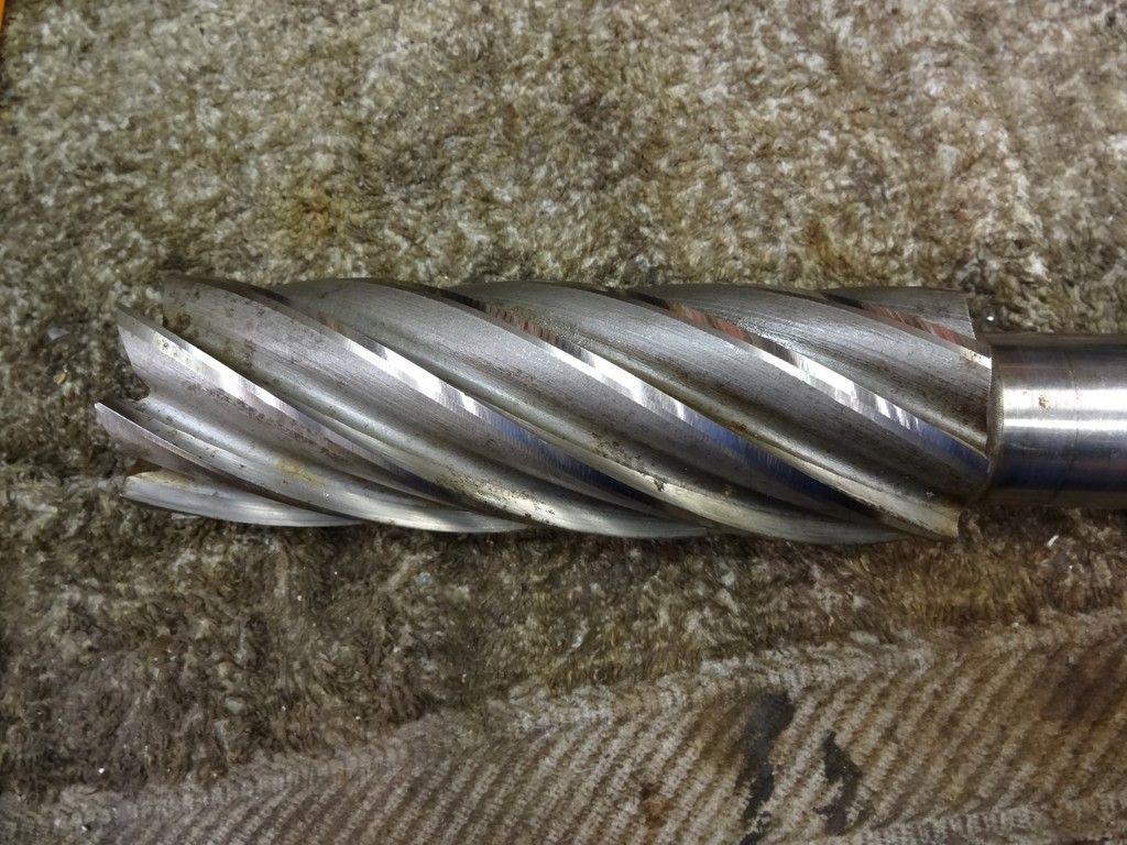

                                  This is how I do the flutes on HSS end mills…
                                  **LINK**
                                  End result…
                                  **LINK**
                                  Machine is a Clarkson Mk1+, I may have misunderstood your post, but grinding towards the edge with HSS is OK, but I would imagine that may fracture the edges of Carbide end mills…

                                    Ah, ok John, I think I get it now – the cutter-sized end of the piece of bar that you turned was used to position the V-block, which was then clamped in place (and the piece of bar removed? ) ??
                                    Bernard: Ok, now that's a serious cutter. I don't think it would fit in my ER32 chuckfrown . Looks like a nice result, though. Is that a bit of green string and a weight to turn it on the finger?
                                    Interesting thought about the grinding direction and carbide. I don't think I've seen anything relating to it one way or the other.

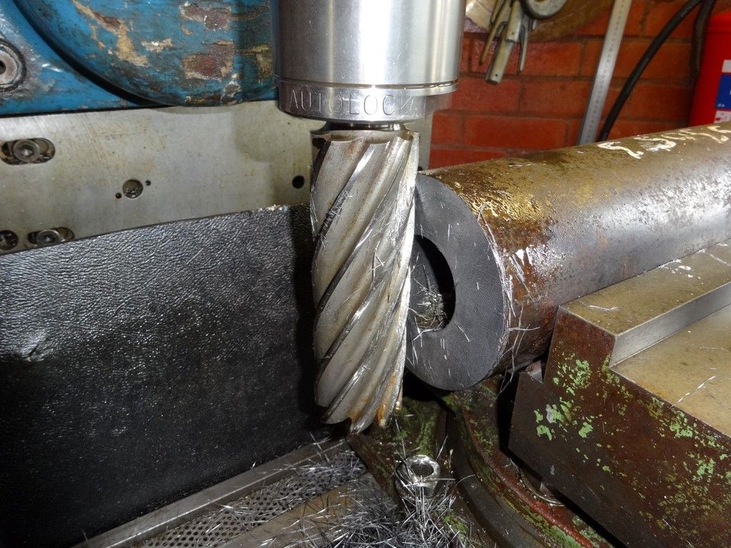

                                        I can't say that I've seen anything about carbide grinding Roger, just my own thoughts and observations whilst grinding a carbide scraper, yes the string is for keeping the flute against the finger.
                                        I needed to sharpen that cutter to face across a large thick walled tube, that wouldn't go in the lathe…
                                        **LINK**
                                        It was for a hoist arrangement atop my miller where the overarm used to go, I only use the universal head now, so the dovetails provided a solution to help my ageing muscles…
                                        **LINK**
