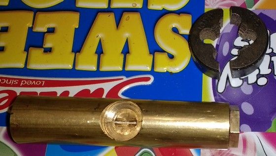

        I have a 1/4" long plug that needs a 10mm thread right up to the shoulder but my die will only allow me to cut about 1/8" before it butts up against the head. I've tried the usual dodge of reversing the die but that doesn't work either.
        I don't want to undercut the plug or counterbore out the first 1/8th of the thread so the only thing I can think of is fabricating a plug by making some 10mm studding and threading it through some hex or grinding away the back surface of the die – which might be more useful in future (except that would mean packing it up in the die holder thereafter). My question is, how tricky is this likely to be given that I'll just be using a small bench grinder?
        (and why don't they make dies that will cut right to the end anyway?!)

            I have used both the methods you are considering. For the studding method I use some Loctite to keep the bits together with some success.
            For grinding the back of a die I hold it in a tailstock die holder to save my fingers from the wheel and the heat generated and the fact that you have a small grinding wheel is an advantage as you will form a concave recess on the die. Just make sure you grind the unmarked face!
            Even with a ground die I doubt you will get your plug to seat unless you either undercut the male thread or recess the female.

                    It's for the end of a pump valve chamber so I'd like to keep as much thread as possible on the plug – the part it screws into is already made and threaded. In light of Jim Nic's comments I think I'll make some studding, thread it through a bit of hex and silver solder it together.

                                Thanks Nick. I've got a couple of ground down taps that are very useful. I won't be grinding this die down however – it's now a properly split die! I made the first plug which seats beautifully but as I started the second there was a sharp snapping sound and the die was no more (it died laugh). First time I've ever done that… that's the price of carbon steel I suppose. So now I need 1x coarse to finish the job and 1x fine (+ tap) for next time. Grrrrr!
                                Truly split die
