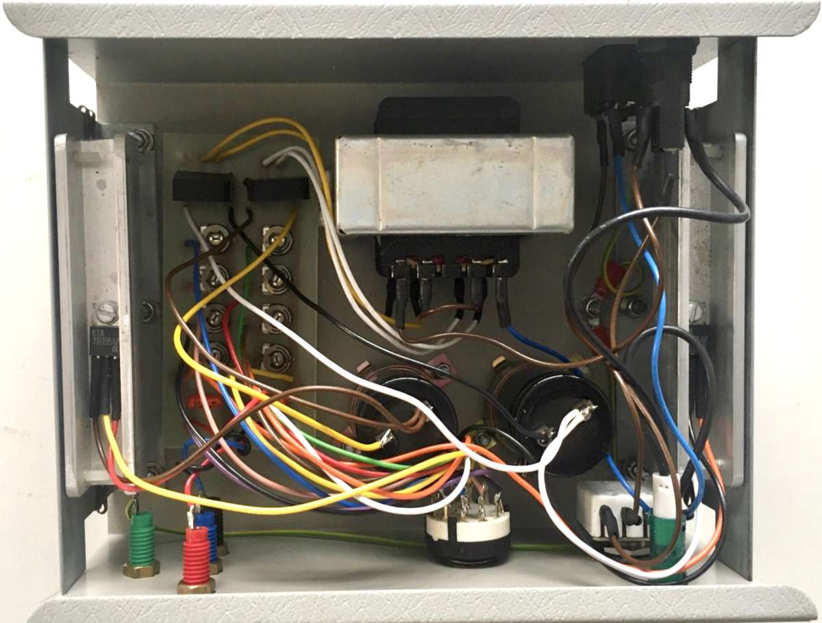

      This is no big deal but, in the eternal quest for knowledge, I would be grateful for some guidance from electronics experts …
      I have this useful little PSU, picked-up cheaply:
      IMG_0109
      IMG_0110
      Two things about it seem mysterious
      1. The circuitry appears to be in two identical halves, each using a 78xxx regulator [so why didn’t they use a 79xxx for the “negative” ?]
      2. They are both 78005 [so would there have been no advantage to using 78015 ?]
      Presumably just showing my naivety, but it’s niggling me.

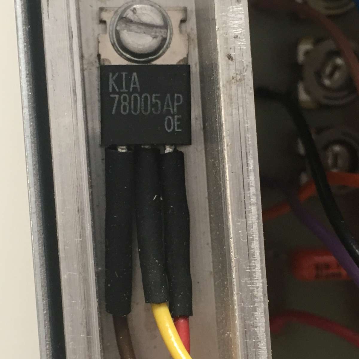

        IMG_0111

                          From what I can see of the wiring it is probably 2 identical supplies stacked one on top of the other. The +ve side of one goes to the +ve terminal and it’s 0v goes to the blue centre terminal. The other one has its +ve connected to the blue central terminal and its 0v to the 0v (black) terminal. Hence both can use the same 78005.
                          The nylon screws for the heatsink may be because the design originally use standard (non-isolated) 7805s.

                              If you look at the photo of the inside, the two yellow wires from the transformer are separate from the two white wires that go to the top of the PCB. Each goes to its own back block (presumably the bridge rectifier) and then is wired to its own capacitor.
                              I agree it’s a lot of fuss for such a simple supply. Maybe its a really old design that has continued to be built – I seem to recall when the 7805 first came out (and seemed like magic) the 7905 didn’t exist, it came a bit later.

                                    The Toshiba device Duncan linked to is a 780xxAP. It is the P (plastic) suffix that makes this device isolated. It is totaly encapsulated in plastic. The devices in Michael’s power supply are neither Toshiba or encapsulated.
                                    I agree with Keith, it appears to be two positive supples stacked. Quite strange. Also strange is the stack of presets for the different voltages. This could easily be done with one less bridge rectifier, LM317T, LM337T and fixed resistors.

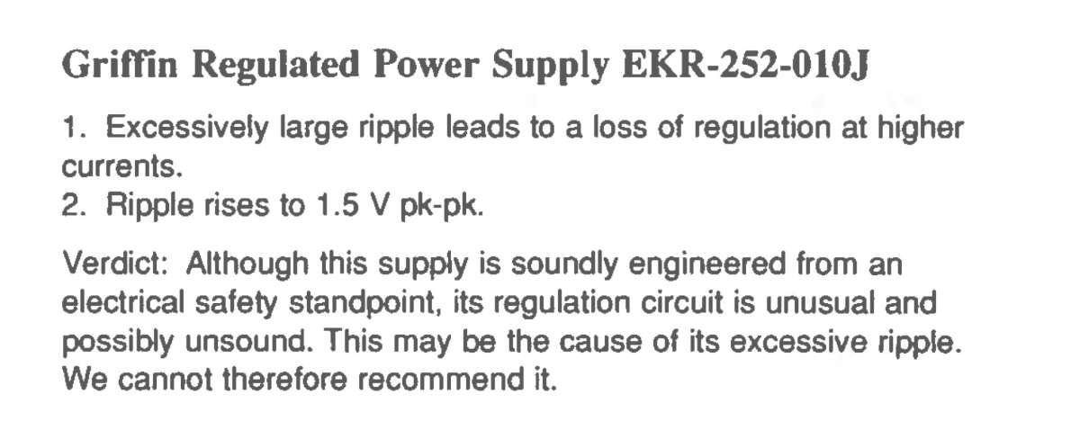

                                        [ PostScript ]
                                        This document now appears to be restricted access … but fortunately I downloaded it last year:
                                        https://www.sserc.org.uk/wp-content/uploads/2019/06/Bulletin_169.pdf
                                        It contains no schematics or explanation, but describes some performance tests on a selection of Stabilised Power Supplies being offered for use in Scottish schools.
                                        The Griffin unit received this damning assessment:

                                          I’m not surprised.
                                          Mind you there is a symbol (dashes under a solid line) next to “volts” above the selector switch that indicates the output may be pulsating DC.

                                              Just shows how careful you have to be. The Toshiba device I linked has exactly the same part number as the one in Michael’s photo, but Michael’s doesn’t have the plastic covered tab.
