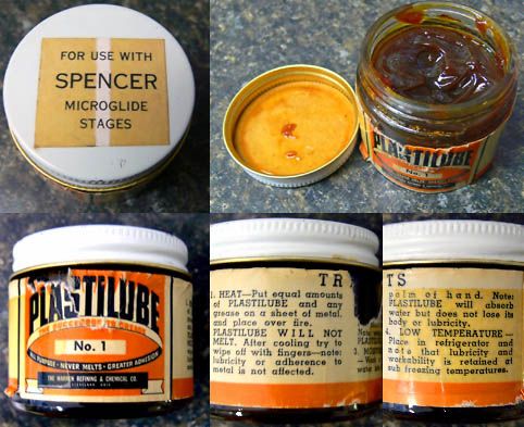

                              #505250
                                Martin,
                                For cases like that, I tend to use either ‘Copper Ease’ or ‘White Lithium’ according to my whim.
                                … still searching for the elusive product that was specified for gliding stages.
                                Edited By Michael Gilligan on 04/11/2020 10:48:40

                                  Michael
                                  Thanks for the reply, if you find the 'elusive product' then I would appreciate a heads up.
                                  Cheers
                                  Martin
