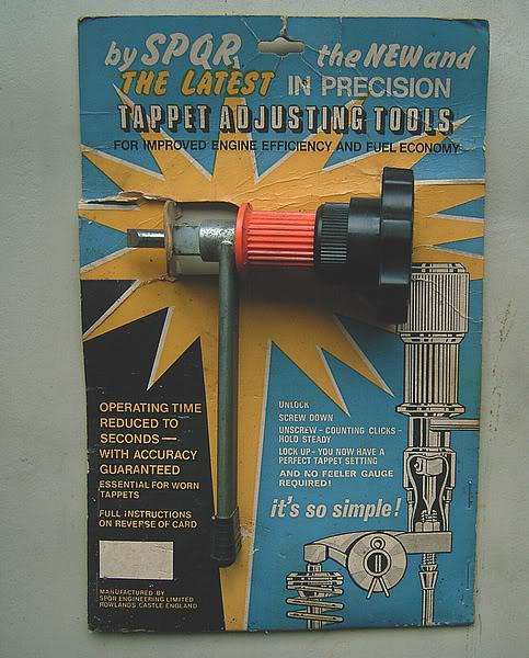

        It sounds like you have re-invented the SPQR Tappet Adjuster, John
        … a jolly sensible idea, I would think

                SPQR launch:
                https://archive.commercialmotor.com/article/31st-october-1969/71/tappet-tool
                Sorry … haven’t found any drawings, but that ^^^ might trigger some memories.
                Edit:
                IMG_0824
                credit https://www.mgexp.com/forum/mgb-and-gt-forum.1/spqr-tappet-adjuster.2259492/
