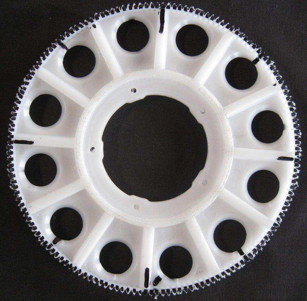

      I kindly request some help in calculating gear blank diameters for a worm gear I am trying to cut.
      I am still busy with my Polar arm 3D printer, which has as drive train a stepper with a 20 tooth gear, and the arms with a 170 tooth gear – 8.5:1 ratio, This is still way to high and the only practical way forward, due to structural implementation constraints on the machine, is to place the steppers at right angles and drive by means of a worm gear. The idea is to hob into the existing 170tooth gear and make a mating worm to drive said gear.
      The 170tooth gear is a large model helicopter rotor drive gear, plastic, but tough as nails. The Hob is a re-purposed tap – a 5/6 BSW-11 tap, which I have re-ground on the T&C grinder, to have well raked cutting edges. It cuts the plastic beautifully..
      The tap – 11 TPI 'almost' mates with the existing 170 tooth gear. That gear is 120mm OD. I am un-constrained in actual gear diameter as well as actual number of teeth on that diameter – that is taken care of in the printer software.
      So, as I am not aiming for s specific number of teeth or gear diameter, this should be easy…Nope….
      I have spent many hours trying to work out the match between what I have, the number of teeth I can fit, DP, Addendum, pitch and Base circles, Outside diameters, etc…..I came up with 168 teeth on a Gear blank OD of 118mm.
      Some of the constants for the calcs were an intelligent guess though – I do not have such good data on the Tap teeth
      I wish to use the existing gear and just hob it to size, so to speak, with the result hopefully being around 118mm OD, and 168 teeth – having cut away all the old 170teeth in the process.
      I made test blanks, 200mm OD, and started to hobbit..I stopped with an OD of 112 mm, and lots of missing teeth…
      I tried 5 more blanks – set the No teeth to 165, 166, 167, 169, 170 – still a disaster!
      I expected to see teeth being obliterated with multiple full blank revolutions while the blank diameter was incorrect for that tooth qty selection, and that tooth erosion begin to cease the deeper I cut, ie, as the blank diameter supposedly approached the correct one. I all cases I approached a final blank diameter of 100 to 112mm (from 200mm!!) with no sign of anything looking to work.
      I am not sure how to proceed!

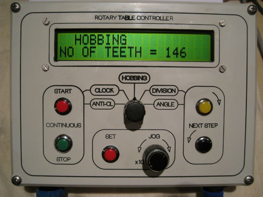

              So you ran the mill at 146 rpm while your table went 1rpm and it still came out wrong. If you look at the link, the bottom left drawing shows the involute shape generated by the non involute shape of a hob. So you might be generating the correct tooth form for the tap

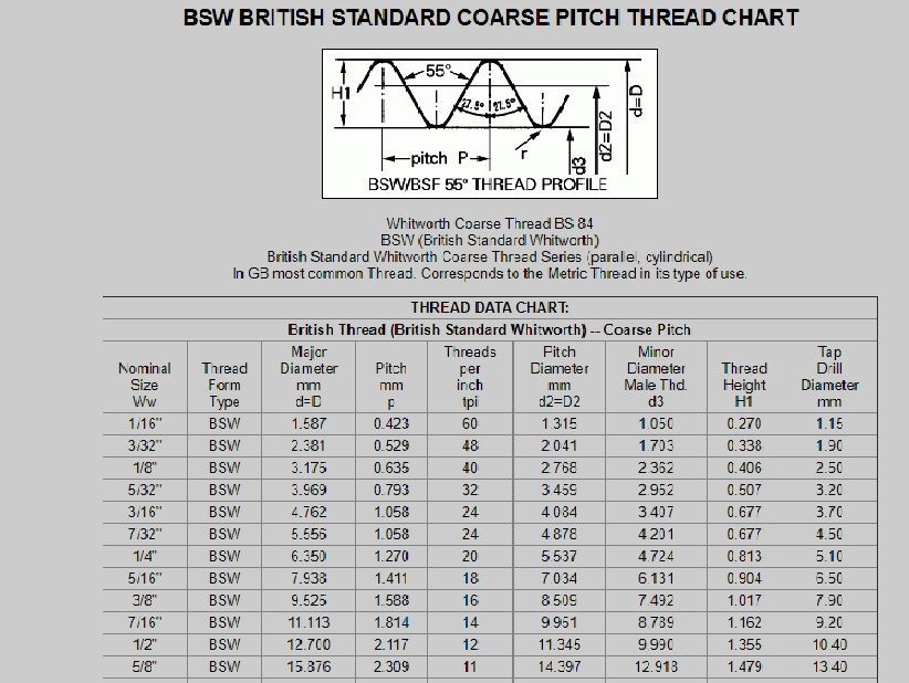

                            In trying to have a better understanding of the formulae for gear cutting I used some of the various thread form charts for the BSW thread taps to determine thread pitch centerlines, etc. However, something is amiss in these charts – and this seems prevalent in ALL of the BSW charts.
                            The thread in question is 5/8BSW – the chart gives data in mm.
                            I am interested in dimension H1.
                            That should be equal to D minus d3 in the picture.
                            But D=15.876mm and d3=12.913mm – the difference being 2.96mm, NOT 1.479 as in the chart.
                            However, 2.96mm / 2 = 1.48mm, close to the chart H1. I do not understand the diagram reference as the dimensions d3 and D are from the thread axis and so the dimension H1 should just be the difference?
                            Where have I gone wrong?
                            Joe
                            #524063
                              Joe, D and d3 can't be from th ethread axis as D is shown as almost 5/8" it would be half that if taken from the axis.
                              Try this one which gives a formula for height of 0.640327 x pitch to get the height = 1.4785732mm

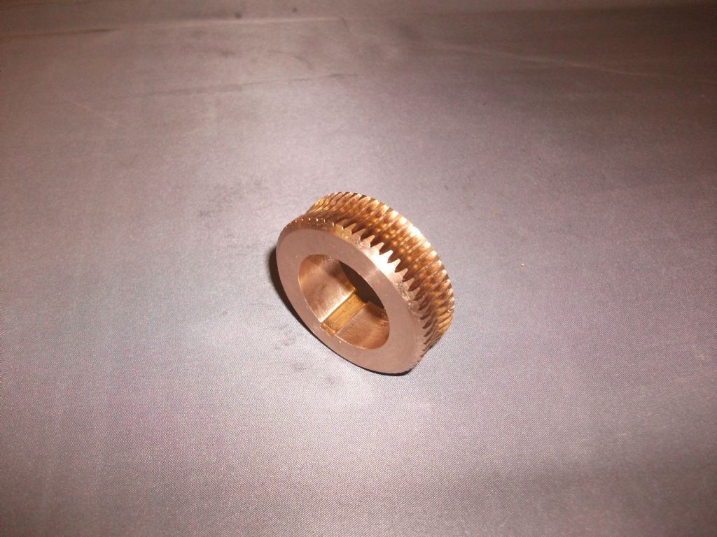

                                  I hobbed another blank to test again, based on the following calcs, and with the results indicated.
                                  From Michael's reference, I calculate the tap should penetrate about 1.9mm into the blank – (H-H/6).
                                  I chose to cut 158 teeth which gives a PCD of 116.13mm. That 'should' give a blank OD of around 117.6mm.
                                  I prepared a blank off 120mm diameter and started hobbing. I fed in from the periphery , which I think has an inherent problem – the No of teeth cannot fit into the periphery, and can only be correct at the PCD, so teeth started to be over-cut…( see copied text from Neil's post in Andrew's post on worm gears..)
                                  Then fed in to full depth ( which should leave me with an OD of 117.6mm, – in the trough- no?) , but the teeth were still being over-cut or overlapped.
                                  I continued to feed in slowly, and got to a point where now the teeth stabilised and were neat and uniform. I let the hobbing continue so that the blank had done maybe 50 or so rotations – the teeth remained clean and intact.
                                  I removed the blank and counted the teeth – 158 teeth!
                                  That was good, BUT…

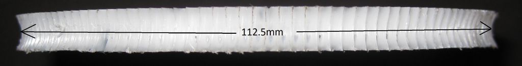

                                  I measured the now new OD of the blank ( at the crest of the teeth, but at bottom of the radius as cut by the tap – see 2nd photo) and the blank measures 112.5mm !! Nowhere near what should have been an OD of around 117mm.
                                  158 teeth – counted a few times.
                                  The OD here, across the outer edge, is close to 115mm
                                  112.5mm OD – ???
                                  My tap is a 5/8 BSW for sure. Engraved on the body, and I count 11 teeth in an inch.
                                  I am at a loss!
                                  Joe

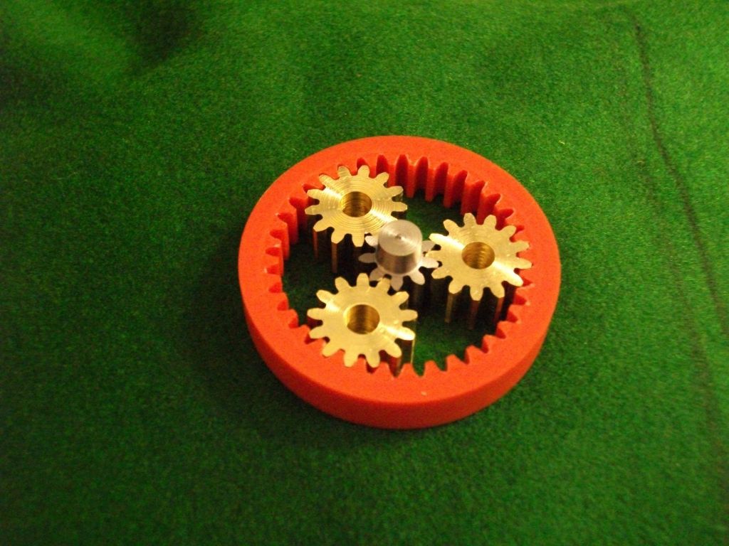

                                        No that is not true ,within certain limitations the pitch circle diameter can be altered for instance
                                        herein this photo ,the outer ring has 36 tooth in order to fit 3 equally spaced gears the sun
                                        gear has to divide into the 36 by 3 in order to do this.This could be 6,9 or 12. As 9 was chosen the planet gears need to be 13 tooth .
                                        Fitting these in diametrically opposite leaves a space for a 10 tooth gear,in order to fit in this
                                        space the sun gear has 9 teeth cut on a 10 tooth blank ,the effective pcd has changed
                                        along with the profile shape of the tooth which just uses a different part of the the same involute
                                        curve.

                                            If those measurements are correct, why did my final gear, with 158 teeth around it, apparently neatly spaced and formed, result in a final blank OD of 112.5mm?
                                            Should that not have been 118.87mm – 2.159mm, ie = 116.71mm??
                                            112.5mm is quite some ways from 116.7mm!

                                                  The 1 st photo here is a 90 tooth wheel cut with a 5/16 BSW
                                                  tap using the same calculation method it looks very similar
                                                  to your cut wheel.
                                                  These type of wheels are not well suited for power
                                                  transmission and may not be suitable for the application
                                                  you have in mind.
                                                  The 2nd photo here is a worm wheel that would be suitable to
                                                  transmit power cut with a 0.9 module hob and is overcut
                                                  the calculation for the size was about 53 1/2
                                                  tooth but was cut at 56 tooth ,the target tooth count was 60
                                                  but the tooth shape was becoming too degraded on a test piece
                                                  and 56 was about as far as i was prepared to go to be safe.
                                                  The difference in the shape of the teeth can clearly be seen
                                                  in comparison with a tap cut wheel.
