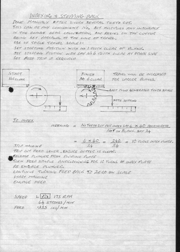

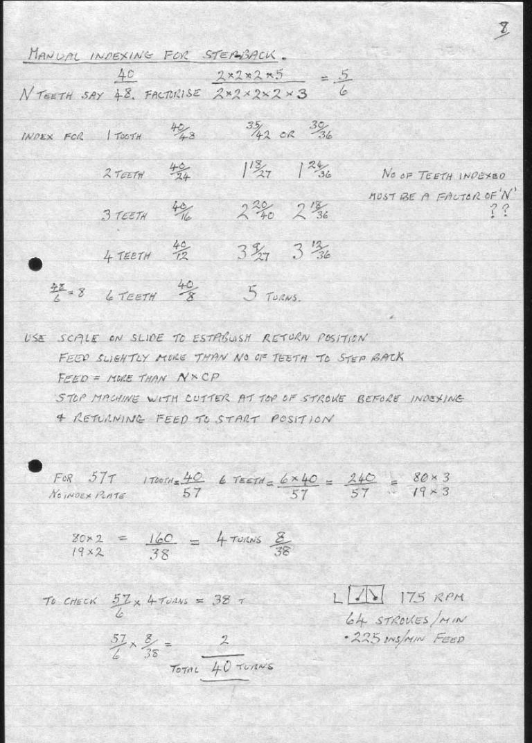

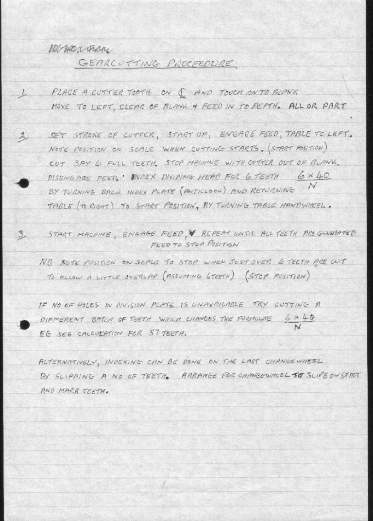

                            #197917
                            Phil P
                              @philp
                              Here are the photo's
                              I cannot claim it was my own idea though, my late father was responsible for rigging it up.
                              He cut a set of Myford change wheels going up in increments of ONE.
                              The photo below has been stitched together from multiple images so ignore the wonky bits.
                              I still have all the kit to do this, but I also have a Mikron hobbing machine which does most of my gears, so this is probably not going be rigged up again any time soon.
                              I think you will agree that my dad was a clever bloke when it came to gear cutting. He did this after he had sold most of his workshop due to ill health just for something to keep his mind active.
                              Phil
                              Edited By Phil P on 25/07/2015 08:45:27
                              Edited By Phil P on 25/07/2015 08:49:19

                                  #197961
                                  Phil P
                                    @philp
                                    Just in case anyone fancies having a go, here are my dads words to go with the pictures.
                                    He actually designed an attachment for a Myford lathe to generate true spiral bevel gears, but that is another story.
                                    Phil
