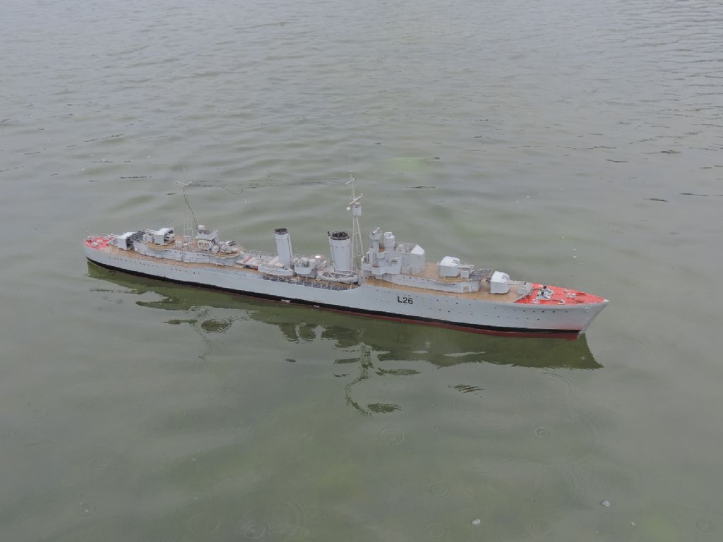

      Took one of my R/C boats out for a run today, Miss Britain III.
      Some fiddling to get the speed control to give a decent speed but still not getting flat out.
      After a while it slowed and stopped, luckily at the lakeside. Someone pointed out there was smoke coming pout of the front hatch…
      The 540 motor had overheated, the plastic around the back bearing had melted and partly gummed it up.
      Back home, the real issue seems to be that the prop tube grease was off and really thick and sticky.
      Old grease out using a TIG rod followed by clutch leaner. New teflon grease in, much freer. A new buggy motor should be here before next weekend.
      Will adjust the speed control range (old electronize unit) once it's all set up again.
      By the way, my charger has done a sterling job of ressurecting various NiMH batteries/packs.
      Here's an old pic before it got a crew.

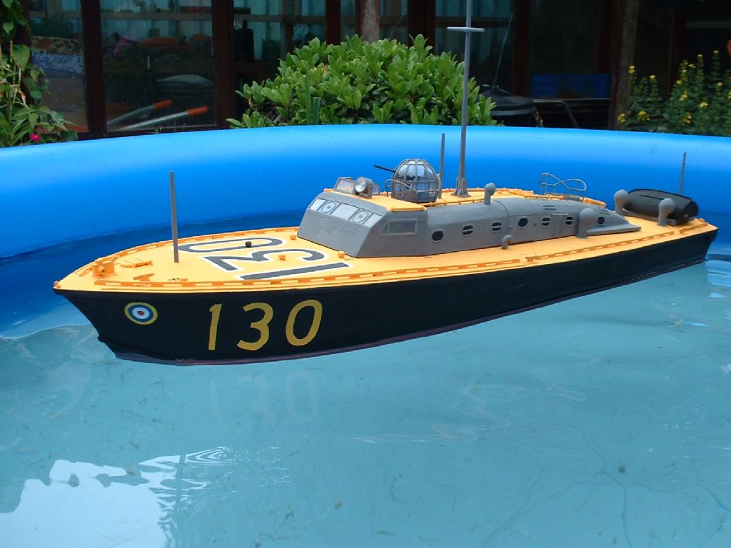

                        Started in 1967 to build a 48" RAF crash tender, decided to fit a Murco 61 engine, moved 3 times, lost some of the parts and the shed roof leaked spoiling some of the hull. burnt it afew years ago. The engine I still have, not even run in ! Seemingly this would have been grossly over engined, but footage on the tube of an identical combination would indicate that it would have been a fine pairing. Noel.
