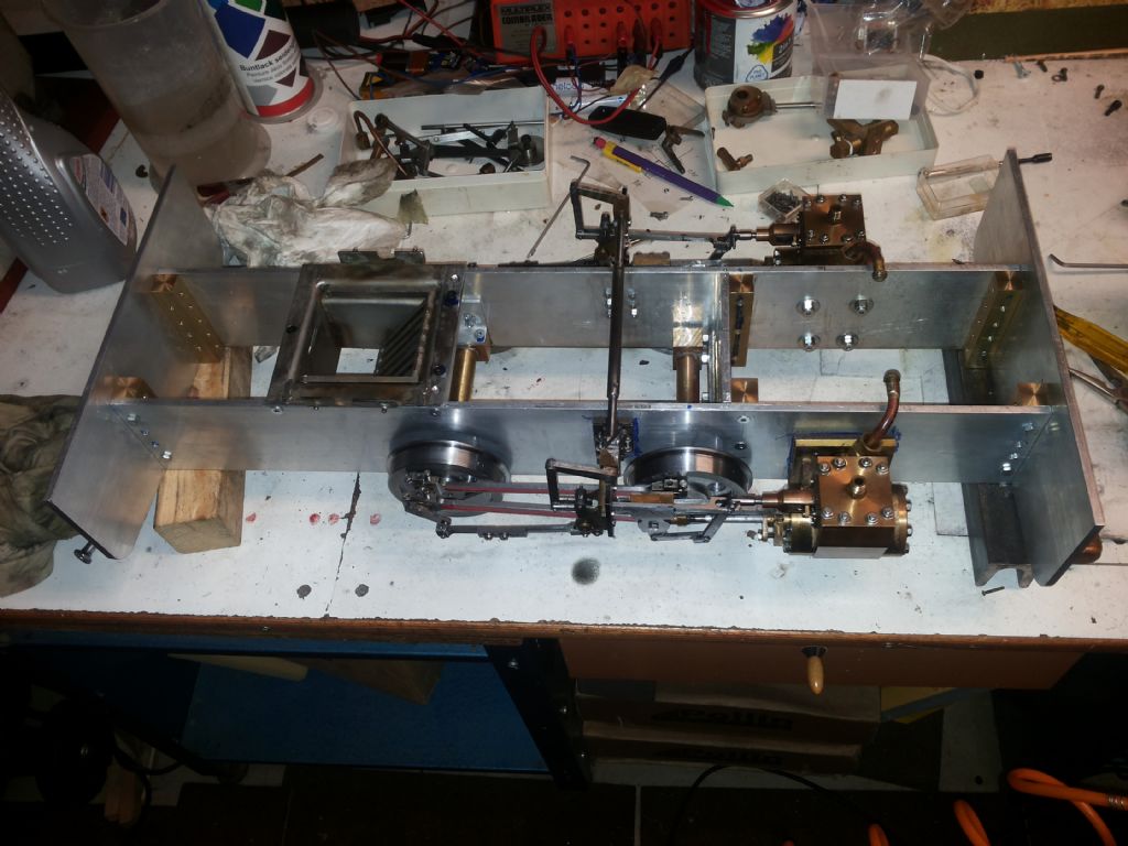

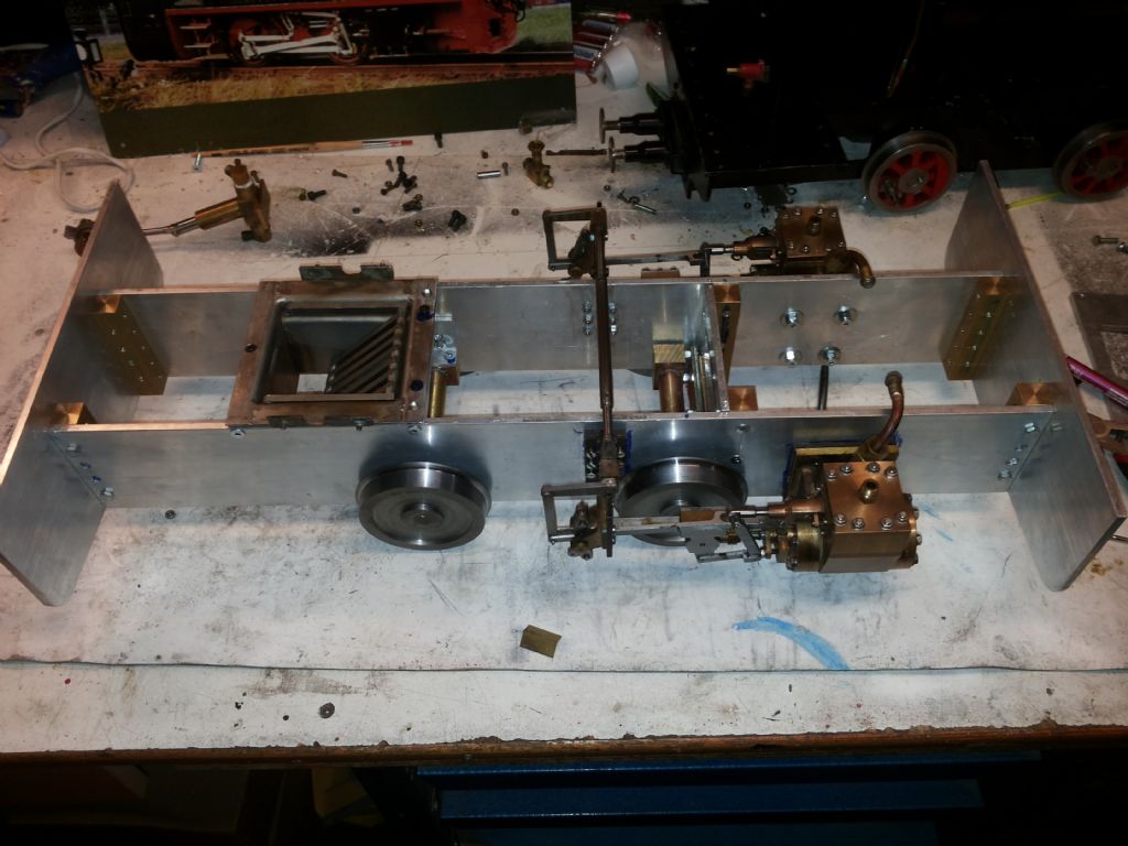

      Hello all,
      this is a discription of my work , a conversion from a 3.5 inch Gezina to a 5 inch Tramway locomotive.
      All starts with the question to steam friend " do you still have the boiler ?"
      The answer was yes . This was the start oft the project.
      The parts look nice, but more then 25 years old. In the beginning I thought if its possible to keep the green house, but it was very fast clear that makes no sense.
      The front
      After the decision to look to a tramway locomotive I made very fast the decision to build the locomotive Plettenberg. She is in preservation at the museum railway Bruchhausen-Vilsen in Germany.
      This was a good decision,because I have The Chiemseebahn and a freelance Wiliam Wilkison tramway locomotive build and constructed.
      Werner

              Many thanks for your replies.
              I will update my work .
              The next step was looking if the boiler is OK . For that I had to make several plugs with M8*1 thread.
              I had to learn that teflon tape which tighten with M8*0.75 without problems with M8*1 there were the problem that the tape was shift off the thread and the tighting was only by chance. I had to do it several times,perhaps the fit of the thread was to good.
              All of the valves I found in the added box ,but they were internally not ready made. It was not a problem to fix it ,but only work to do. At the picture all valves are in place and the boiler is OK a good step forward.

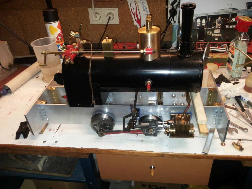

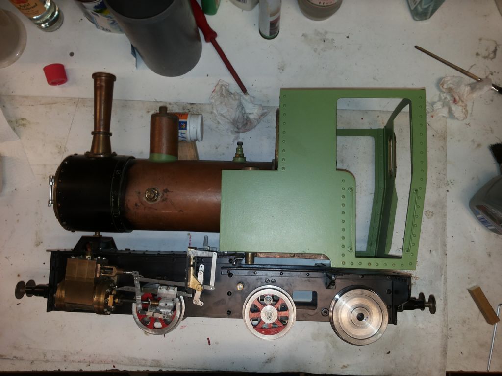

              The next step was to make the new 5 inch gauge frame. So I disassemble all parts with the exeption of the wheels. The profil and the diameter was not useable. In the time between I ordered my material and I had to keep in mind ,it was late in November 2018, that over the year when i have time that all important materials are there. for the frame and the housing.
              I build the frame in a simple way similar to the principle of my Maxitrak Ruby. That means the rear axle is fix in the frame and the front axle is tiltable. That worked on my locomotives relativ good even on not good prepared tracks.
              I tried to reuse as much as possible .It was not easy to align all properly. The plans from the Gezina was not very helpful,because the cylinder tighting sketch at the frame was not there. And the guy who build that 25 years ago had not the same hole layout on both cylinder. The wheels had a greater diameter and so I had to arrange all new. But with some patience bot sides got together working. In mid of december the first turns of the wheels were achieved under air pressure.

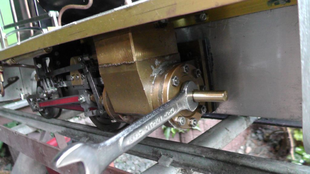

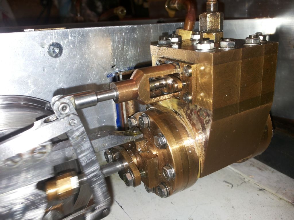

              It was noticeable that the cylinder needs a lot of air and the compression was low. I tried to see what happens with a lot of oil.
              The system behaviour was better ,but I can see that there was leeaking oil out of the cylinder a leak was recognized.20181215_100149.jpg
              The cylinder were build up with a combination of materials and were silversoldered together. I had to disassemble it and softsolder it steam tight. By stripping all off and out I saw that the pistonring with teflon tape has no connection to the cylinder bore. I machined a new groove to fit a teflon ring with an Oring for static pressure.
              With this setup the cylinder had a lot of compression. That was really good .This action I have done on both sides and then I put all together . What a difference in the behaviour after that repair.
              will be updated

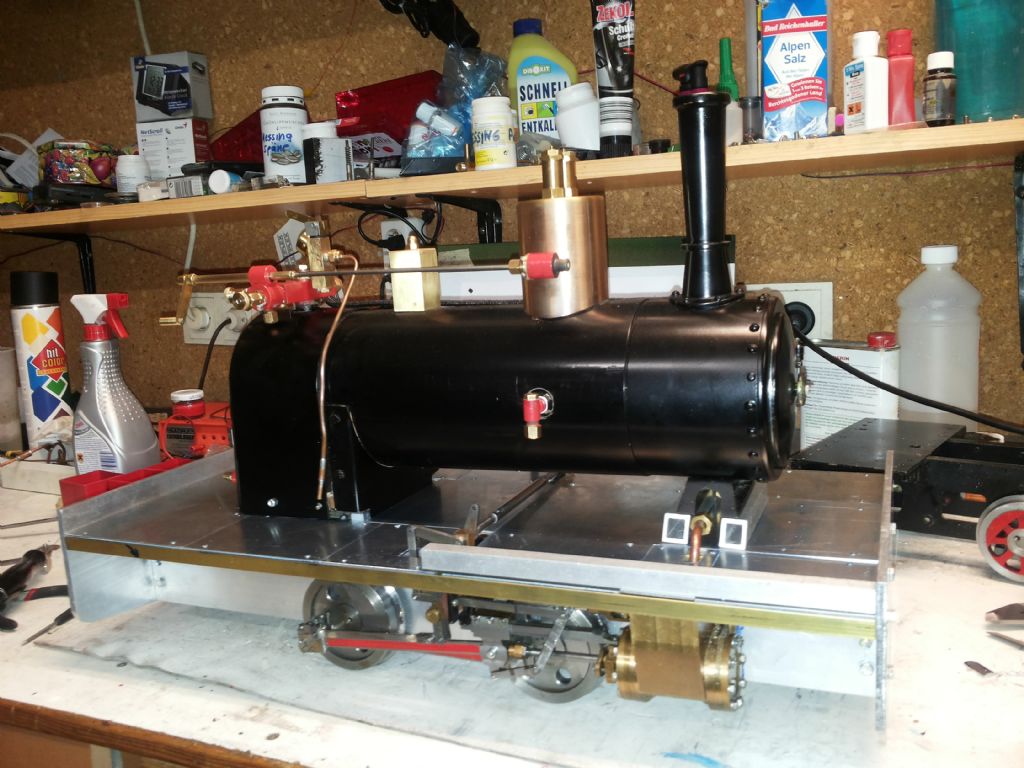

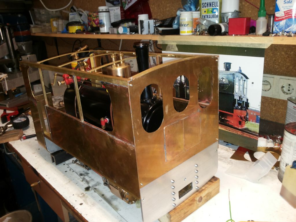

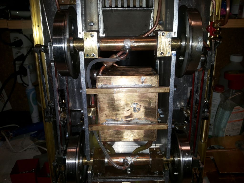

              Werner Schleidt
                @wernerschleidt45161

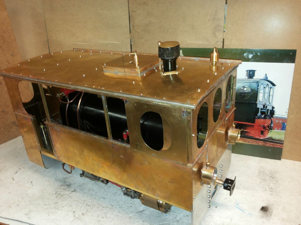

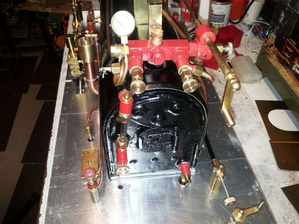

                Here is the next update.

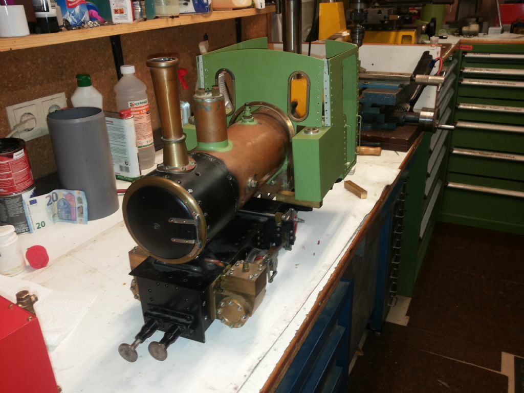

                The boiler was aligned at the frame to see where the pipes and attachments have to go.
                This was an iterative process, because my plan is only the photo in the rear .
                The the footplate on the frame were build.Screwed with many M2 Screws countersink type.
                The boiler attachments were arranged and Iwant to use as much as possible from the old frame.
                The housing was constructed with brass material .I ordered at the dealer as much as possible cuted in the correct dimensions I measured from the photo. Step by step it came to the look of the original locomotive.
                The brass for the roof I had to order later ,because the correct dimension were only visible and measureable in this stage.

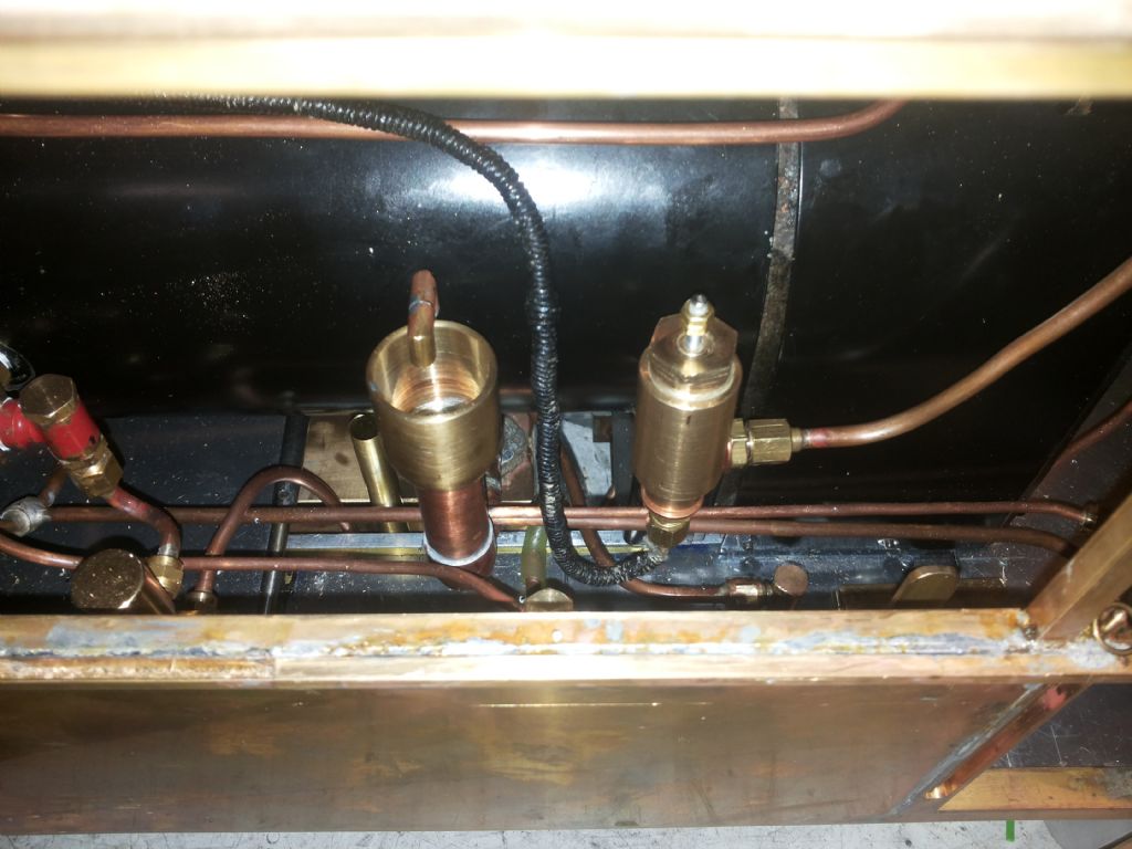

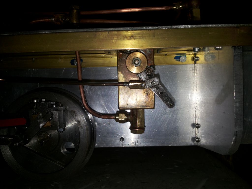

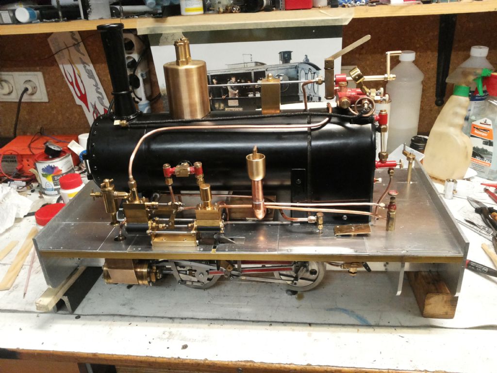

                In the time between till the ordered parts arrived,, I completed the frame with valves steampump ,bypass valve,,watertank between the frame and so on.
                Here is the water tank between the frame visible and the pipework for water and oiling the axles. For all attachments I tried to install it in a way that service is good possible.
                That is not easy to achieve ,because in further steps there are some attachments were screws are blocked.
                The homemade oilpump with ratchet mechanism. The toothwheel have to have more teeths. In this configuration it is a litle bit dificult to adjust it.
                On the right side is an automatic blower valve. This valve open and close pressure dependant the blower .For small boiler is this a good attachment, because is much easier to fire. And it is good if you have a coffee break then you could come back and the fire is still alive.
                Werner

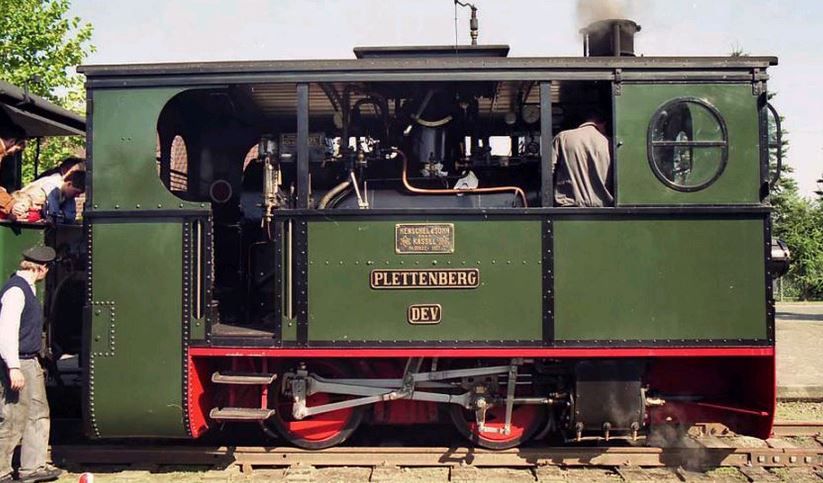

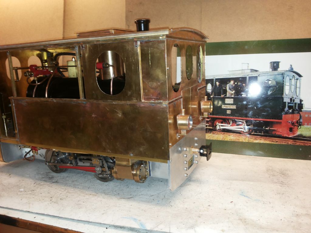

                      This is the boiler on the driver side.The reversal handle was not ready at that time.
                      I tried to use the same setup of valves and handles as I have on my other locomotives.
                      All necessary attachments are there some refinements have to made later before painting.
                      For my opinion it looks pretty much the same like the Plettenberg at the photo.
                      The spark arrestor was very difficult to make. The small pipe and the bell are whithout function.
                      Now with the nameplates on the side. The have been made in etching technic.
                      With good wheather the next step is testing under steam. Then I will see whath happens. With air pressure I made tests on the table and they were sucessful.
                      Werner

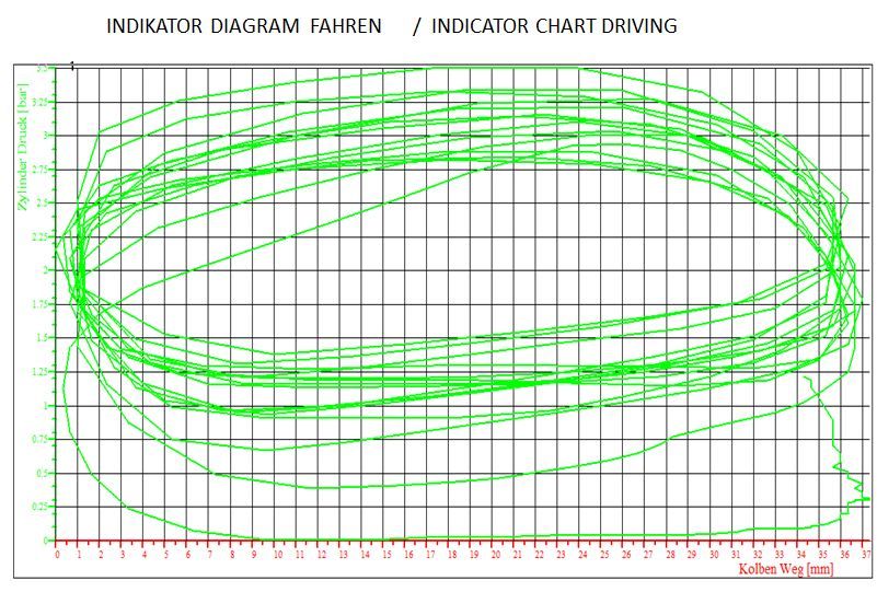

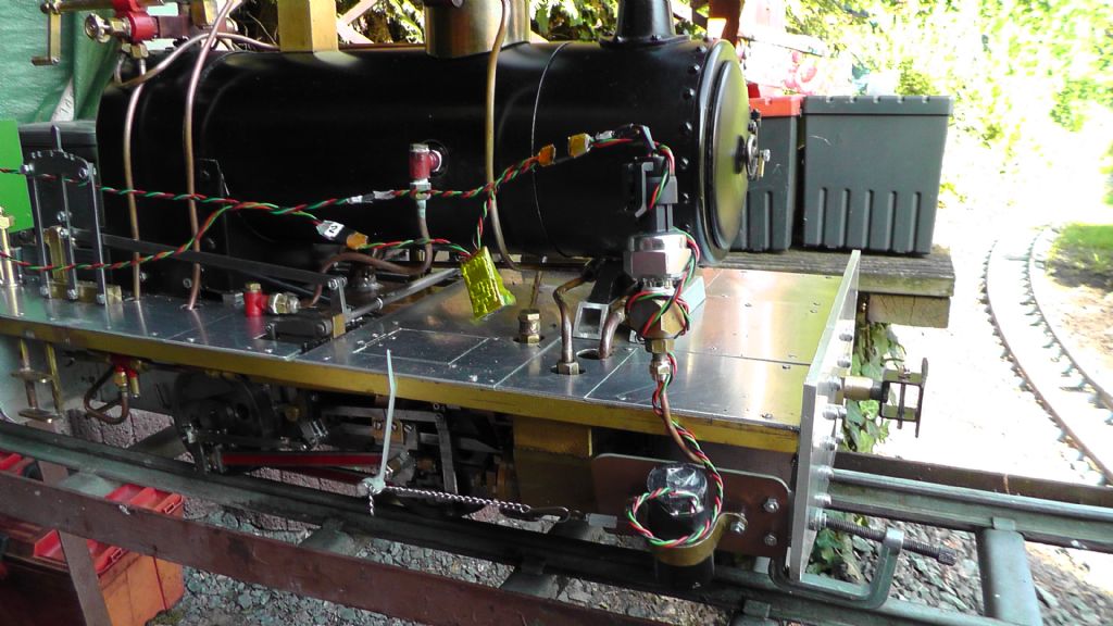

                                                  Werner Schleidt
                                                    Hello all,

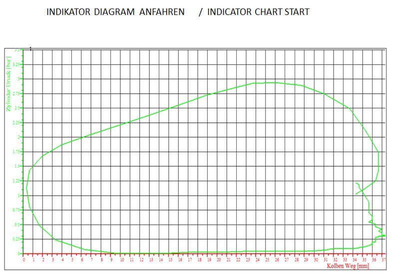

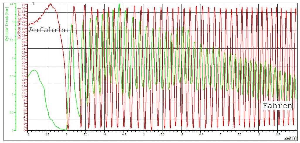

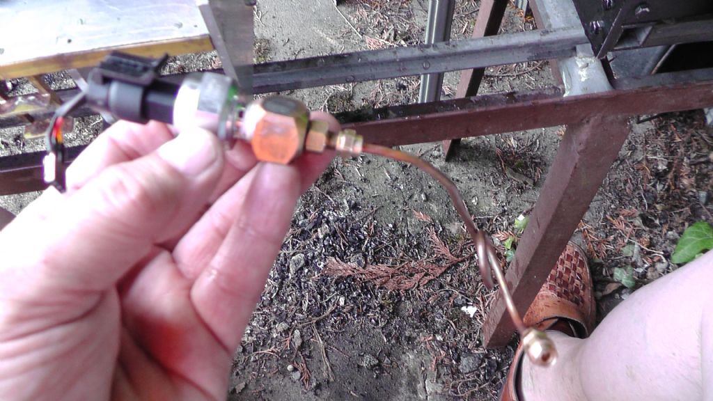

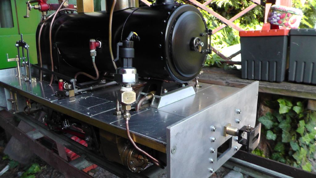

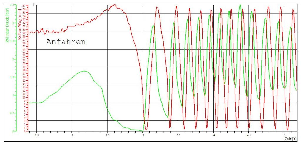

                                                    I had some work on a hot day with more than 30°C. Since some time agao I worked on a mesurement test equipment and the unpainted Plettenberg is a good test object.
                                                    I wanted to measure the pressure in the cylinder and the displacement of the piston. I want to see how this diagram is compareable to pubished charts in books. And in next steps the measurement of indicated power in relation to the force on the draw-hook and the driving speed will follow.
                                                    Today it was a little bit tricky , because I had jobs for 3 persons but I have to done it by my own. My Laptop and my camera had heat problems. It was good to have a back up.
                                                    The pressure sensor with adaptors.
                                                    The cylinder cover where it was connected.
                                                    Now installed.
                                                    The selfmade displacement sensor.
                                                    The time diagram green is pressure, red ist piston travel. From start to driving a few meters.
                                                    The full piston travel during start.
                                                    Starting and driving with closing of the steam valve to slow down a little bit.
                                                    Start and driving as above in xy diagramm
                                                    Werner
