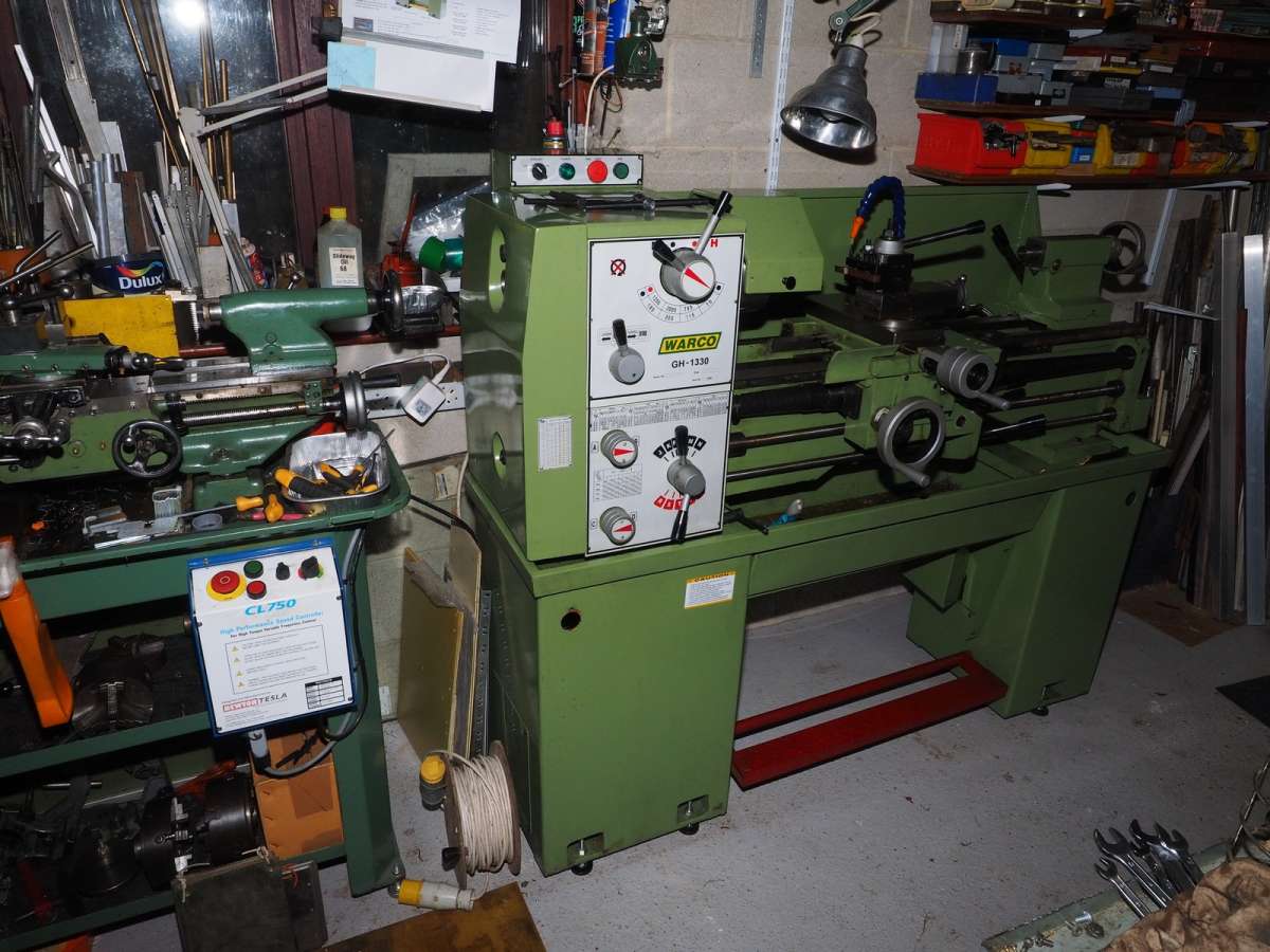

                    Re the GH1330, bear in mind that the cabinet is effectively two separate pillars with a void between them.
                    6 bolt down points, which in my case house adjustable feet.
                    The pockets above those bolt down points are solid topped and have about 2¼” vertical clearence.
                    Also, the switch cabinet is on the rear of the headstock, so if it’s going against and parallel to a wall, some thought might need putting into, either the location, or a means of moving a heavy machine for maintenance.
                    BB050077_tn
                    In my case I positioned the lathe with the headstock overlapping a window, to at least permit occasional access from outside the garage.
                    BB050078_tn
                    p.s. you also need access to the right hand side of the tailstock base, as this gives access to the coolant reservoir and pump; I use a water free, oil based one from Pennine Lubricants.

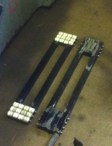

                          When it comes to the lathe the emergency stop / brake bar between the plinths is going to seriously get in the way of a pallet and jack system. Easier, but more ££, would be a small frame round each plinth carrying three jack up castors. I’m unconvinced as to the ability of the chip tray to properly distribute any bending stresses through the middle if only two were used on each side.
                          My lathe solution for in shop movement on a smooth floor was a heavy duty version of those cheap low profile furniture / white goods shifting doobies. About 1 1/4″ deep with lots of rollers on 1/4″ Ø axles it handles 1 1/2 tons of Smart & Brown 1024 just fine. I got creative with car jacks and pipe through the lifting holes for raising and lowering. Basic structure is 1″ square speed-frame tube welded together with a pair of nylon rollers across each 1″ width. I imagine one of something similar slid under each plinth would do fine for lathe moving. Multiple narrow roller are essential to permit things to steer.
                          Lathe Shift Roller Frames

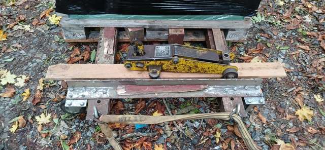

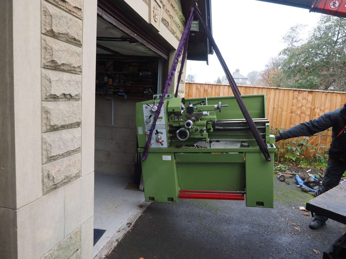

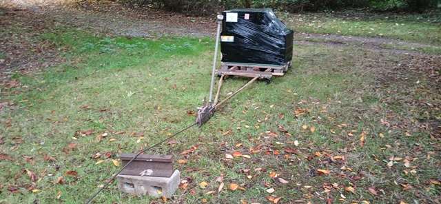

                                  Hi cejm78, maybe you had the same 18 Tonne lorry that delivered my lathe from Warco, fairly recently. I said not to try delivering with a big lorry, but, a big lorry came, and it was so long it couldn’t even turn into the lane to mine. The driver said all he could do was to unload it onto the lane, but he did use his pallet truck to get it down to mine, however, he got half way down the lane and his truck went into a pot hole, and grounding the pallet. So I had to fetch my own version of a pallet transfer truck, with some bolted together angle irons and casters.
                                  20251016_100253A
                                  I could pull it down to my area without too much effort, but I then had to swap the angle irons through the other way, (good job it was a four way pallet) and then pull it to my drive, but, I only got it a meter or so across a grassed area, which stopped me dead. But I had a trick up my sleeve that my truck didn’t know about, and it didn’t argue with it.
                                  20251016_103527B
                                  A  wire rope Tirfor did the job with ease, and with luck, I got it down before the postie came, as he wouldn’t have got past it, to get to mine or my nearest neighbour.

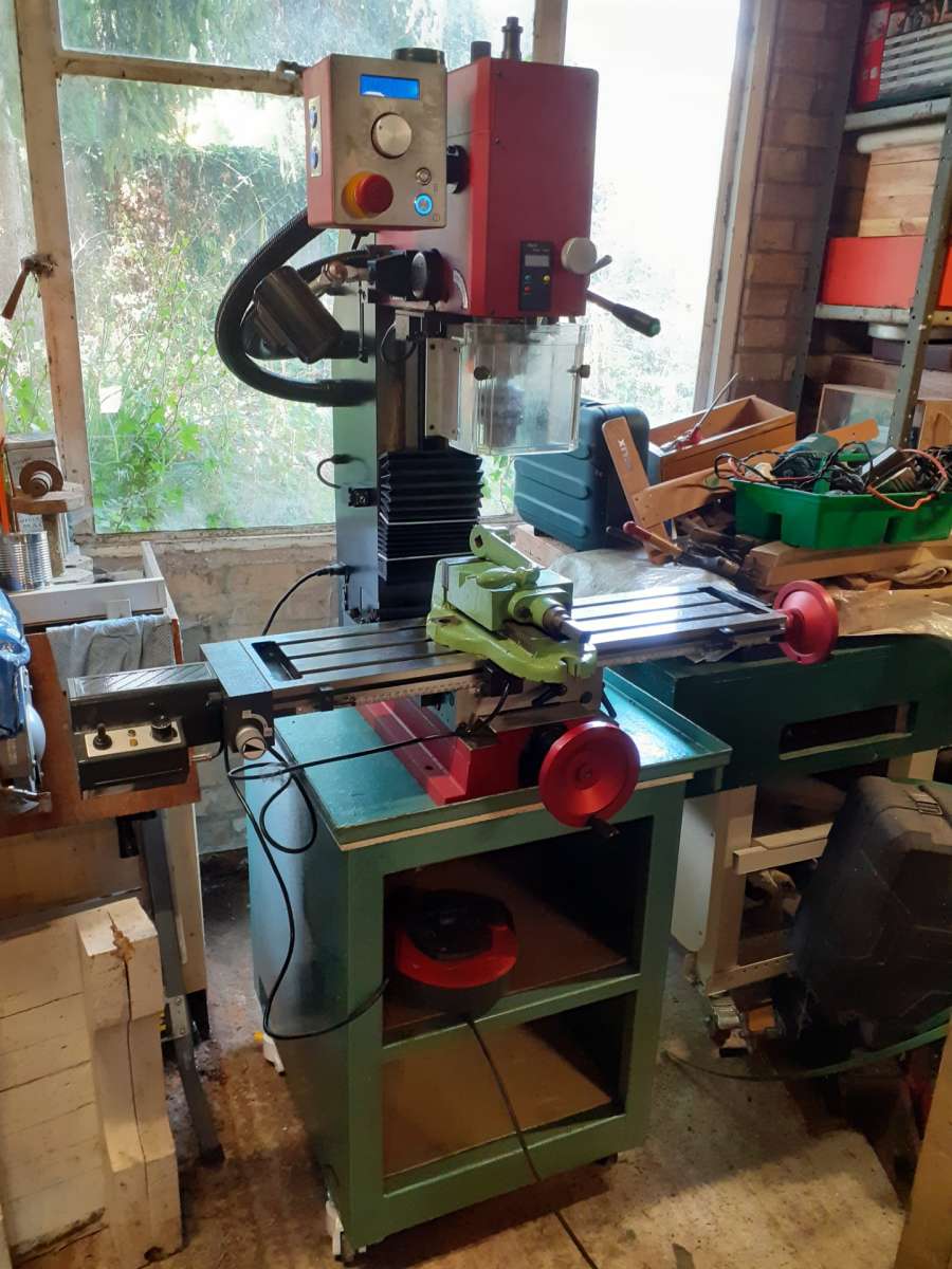

                                                  The mill sits a bit lower on its stand, so that was quite easy. I built a frame out of 3 i-beams which run front to back. On these i-beams from side to side run 4 50x50x5mm box sections. The mill is bolted to the box section. This allows me to pick the mill up with the pallet truck. Under each i-beam I have two adjustable machine feet to account for any unevenness in my floor.
                                                  i am waiting for the temperature to go up a few degrees so that I can paint it. The plan was to have a wood burner installed before Christmas but the installer is waiting for a hip replacement. So that will have to wait a bit longer. A bit of a pain when you are trying to paint but it is too cold.
