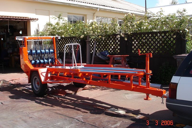

                            Ian S C
                              @iansc
                              4140 machines quite well, used quite a bit on highly stressed parts of agricultural machinery, normal advise is, not suitable for welding without heat treatment, but we have welded with no adverse affect, other parts get bent before the 4140 shaft breaks. We buy in the axels for the wheels, they are also 4140, and welded to the main cross beam. This thing is for feeding out large hay bales Ian S Cdsc00151.jpg
