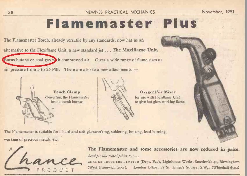

                  If you look at another ad than the one pointed to by Thor, it states it's suitable for use with butane and compressed air, albeit the "plus" version.
                  flamemaster 2
                  Good luck with that. I think I'd get something a little more modern. The clue is in the manufacturer's name!

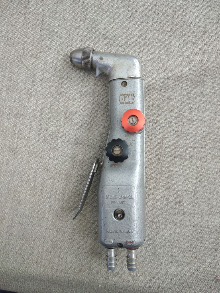

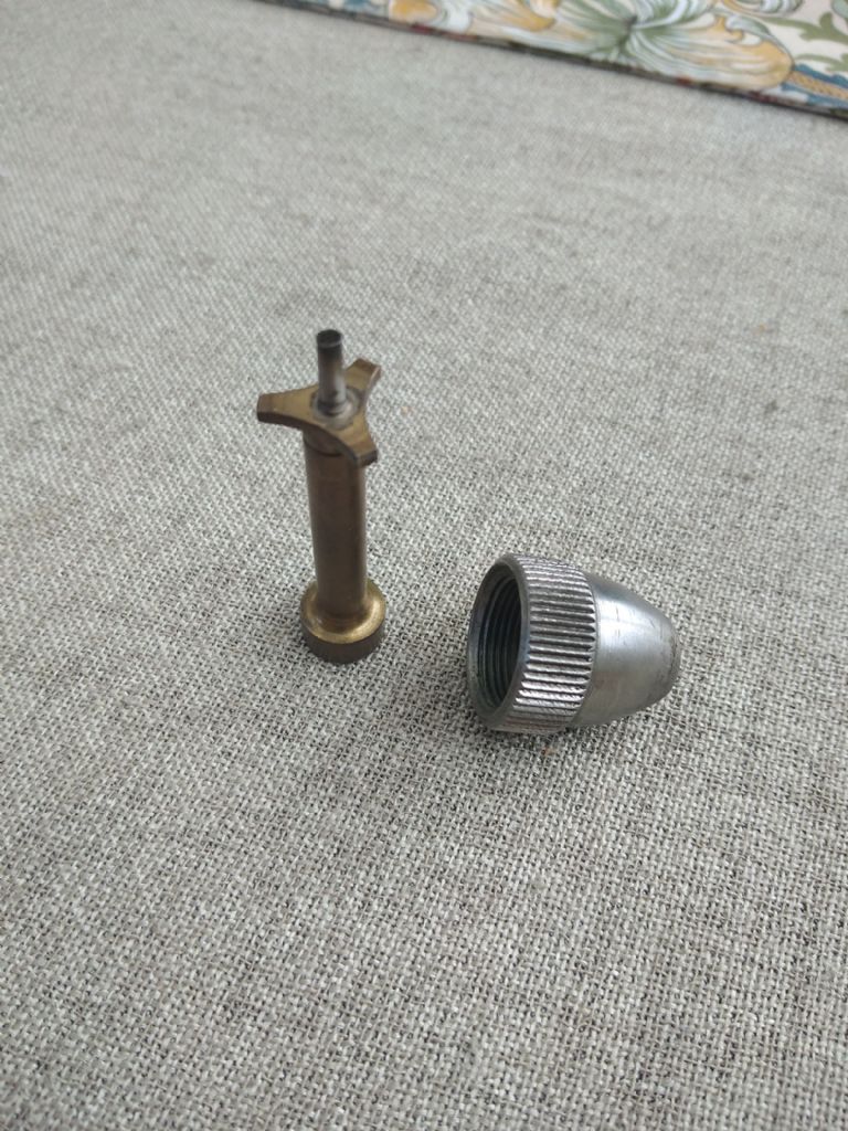

                          img_20220425_095330_resized_20220425_095803101.jpgI have uploaded a couple of photos of the torch. The fitting on the end is to retain the nozzle assembly. It has to be screwed down tightly to push the nozzle against its seat, the tapered nose pushes against the three fins on the nozzle. I assume there may have been other sizes of nozzle available.
                          I guess it all comes down to the calorific value of the fuel gases. In Australia our LPG is mostly butane with a variable mix of propane. Reticulated gas is mostly methane. I believe reticulated gas in the UK in the 1950s was derived from coal and had quite a mix of gases.
                          I have a Dillon,( ie/Henrob/Cobra) torch which works very well with LPG and Oxygen, both fed in with less than 4psi. and very low flow rates.img_20220425_094356_resized_20220425_094428994.jpg

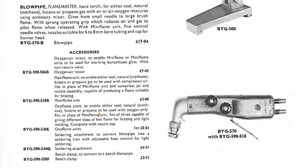

                            flamemaster.jpgHi,
                            I used to use one of these about 50 years ago for glassblowing in a lab. It was normally operated using oxy/natural gas for pyrex glass but I think it was also possible to use air/natural gas for soda glass. It came with three nozzle sizes for different flame sizes. I have an old Gallenkamp catalogue (probably from the 1960s) which shows it. If I've done it right, the entry should show up on this post.

                                    The nozzles are a very simple design with gas or air being admitted at the centre and air or gas being admitted via an annular hole, with both mixing in the nozzle's tube. I've just checked mine and it appears that the aluminium shroud which retains the nozzle has actually got a small radial clearance between itself and the end of the nozzle.
                                    It's probable that the reason for this is to avoid heating the shroud, but it does leave the possibility of drilling a small radial hole into the end portion of the nozzle to allow a leak of mixture to exit via this radial gap. That would act as a flame control ring.
                                    I've got too many other pots on the boil at the moment (See what I did there? cheeky) But when I get the round-tuit recommissioned, I might try such a modification on a copy of a burner nozzle. That's much simpler than the design I had originally considered.

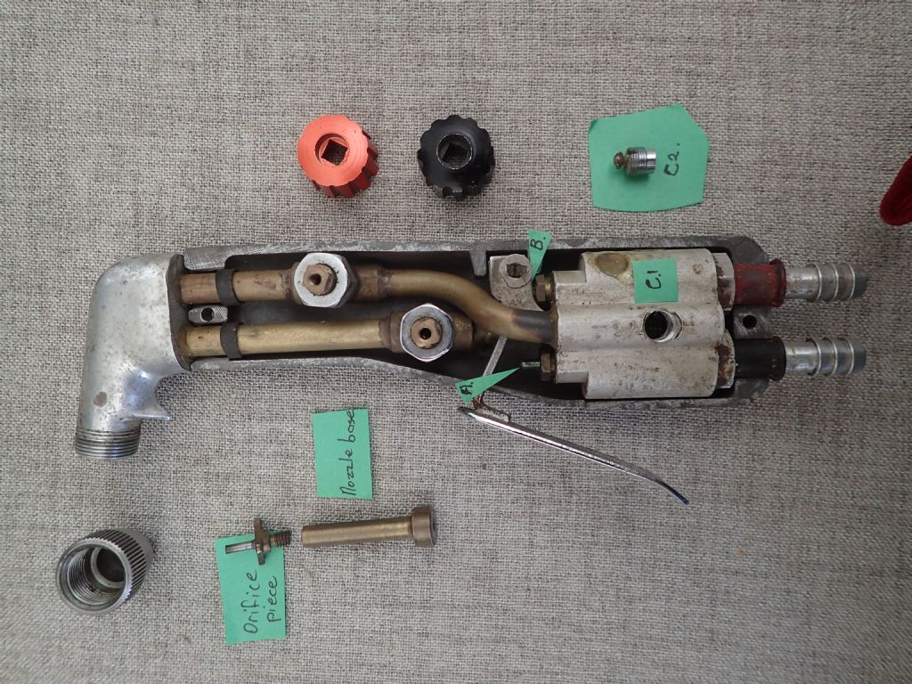

                                      The Flamemaster has a few subtle details. The labels A and B indicate plungers operated by the trigger, A has much greater travel and adds ?fuel while B hardly moves and adds ?air/oxy. The mixing chamber looks remarkably similar to the Dillon.
                                      It will be relatively easy to make new orifice pieces to screw into the base piece. The only item which may be damaged is C1 and C2, the screw is obviously a bodge and I am unsure of the details inside C1, it looks as if it is meant to be an adjustment.
