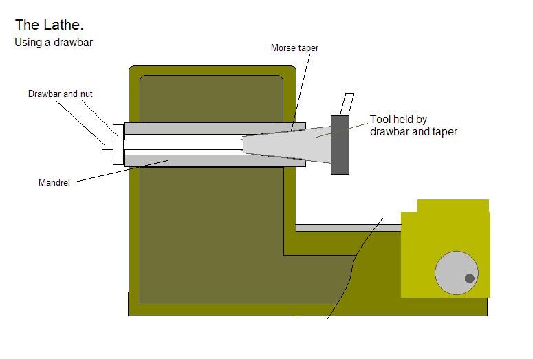

            Hi Allen
            The rear end of the taper shank of the flycutter should be tapped. The draw bar is a length of rod with a matching thread which will screw into this – a length of studding is OK. The rod is long enough to pass right through the mandrel and it secured ( by a nut and washer if studding is used) against the back end of the mandrel and thus retains the MT shank in the socket and prevents it flying out. Do not use the fly cutter without the draw bar!
            So in this case forget the collet chuck – in any case I don't think mounting a flycutter needs the precision of a collet chuck and a straight shanked flycutter should be OK in your 3-Jaw. In fact I would prefer a straight shanked cutter held in a chuck. There is a danger with the MT one that, if you take too heavy a cut, it might slip with consequent risk of scoring the MT socket .

              Hi Allen,
              Just to clarify, here is a sketch (one of a series) I used to explain to youngsters in school how a drawbar works Hope it helps. If your E32 collet chuck is in the lathe using the same drawbar to hold it you can usea parallel shank flycutter, but as Norman says you can just as easily use the 3 jaw chuck to hold it. The drawbar can be a suitable length of threaded bar – probably M10 or 12.
              You can click on the picture to enlarge – hope it helps.
