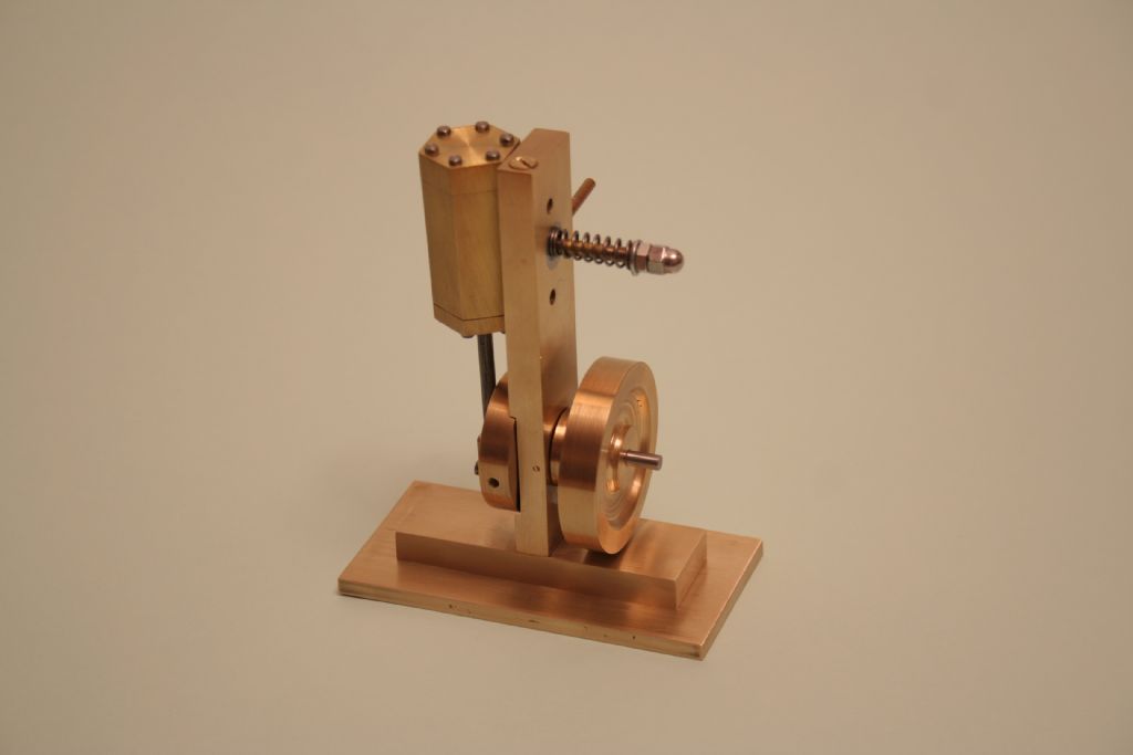

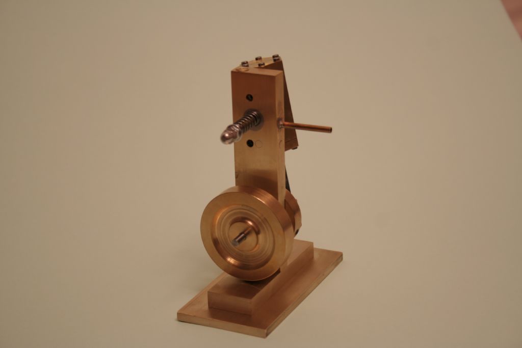

      Hi Folks,
      I am feeling pretty pleased with myself at the moment. I had been looking for a lathe for a little while and faffed about trying to decide whether to buy a new or used lathe. Eventually a Myford ML7 came available and I took the plunge. Since getting it home I have spent many happy hours making swarf in the garage and I have built the engine shown in the pictures as my first project.
      It is a single cylinder, double acting oscillator of 12mm bore and 18mm stroke. To say that I built it to my own design is a bit misleading since it is very similar to thousands of other engines of this arrangement, however I did build it from bar stock to my own plan so I suppose I can take some credit for that! I am particularly pleased with the in-built oil reservoir. If you look closely at the top of the frame you can see a CS 8BA screw. This has a 1mm hole drilled in it, into which a tiny tube is soldered to act as an integral dipstick and allow air in. A long hole is then drilled right through to the base with oil ways leading into the bearings.
      The engine runs smoothly on either compressed air or steam and, for no particular reason, I have called it Cobweb. The next plan is to build the Double Cobweb.
      Hope you like it!
      Jim.

          Hi Jim
          Your own design and it runs! a Great start….
          It is a priceless feeling when something you have made from inanimate raw material springs into life.

                        Hi Jim
                        it looks very nice. I think the wobbler is the mandatory first project. I remember how satisfied I was when mine ran. What's project number 2 going to be?

                            Hi Jim,
                            Very nice little engine with a few unusual touches. Just curious, but why have you recessed the crank into the frame/stand?
                            Gary

                            James Newberry
                              @jamesnewberry
                              Thanks Gary, no reason at all other than I just felt like it and thought it would look good and a little different.

                              James Newberry
                                @jamesnewberry
                                Just spotted a mistake in my original post – it's a 4BA screw, not 8 as described!
