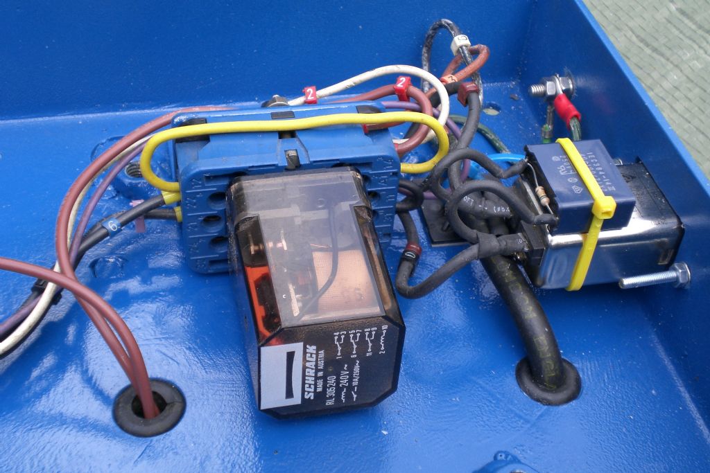

                        Normally I would agree that for a relay to operate reliably on ac it will need a rectifier of some description and possibly with a capacitor for smoothing, however, the relay I used was specified as being designed for 240Vac use (RS Components 348-813). There is no rectifier or capacitor and it works fine with no buzzing.

                                                  Hi, when I was about 27 and doing some rewiring on my house at the time, I too tested the so called undertakers theory. Don't ask how or why, but a pair of pliers in each hand ment I could not let go. I had to actually throw my whole body backwards to get off the shocking expereance (pun intended) and the only floorboard in the room that was lifted, my foot went down and punched a hole through the kitchen ceiling. I was needless to say all shook up for an hour or so, but I'm more than double that age now and know better.
                                                  As regards to NVR's and AC relays, some six years or so ago, I made a stand alone drilling station using my late farthers Bonds "Maximus" sensitive drill press, to which I used an AC relay without having to use a bridge retifier. It performs well and does not chatter or buzz. It is however the plug in type, so if it did give up, it can quite simply be replaced.
                                                  There is a picture in my general photos album of the drilling station, along with a circuit schematic for anyone who is interested.

                                                    I am sure the relays I used must have been DC ones. (the coils, not the contacts)
